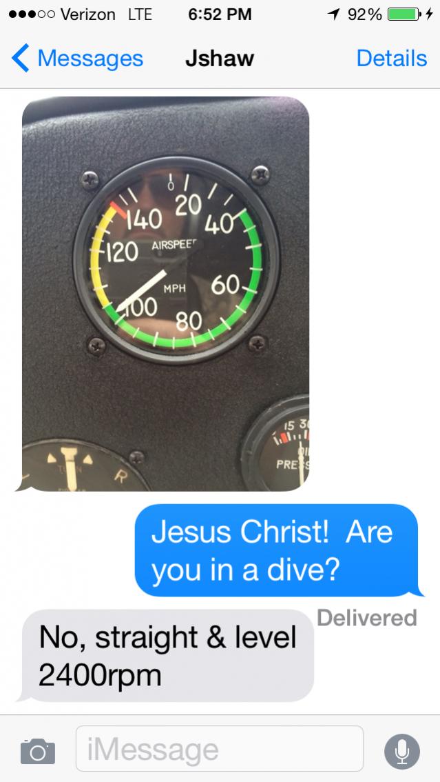

                Not germane to this conversation. But on the first flight of my '46 BC12-D after a total restoration and a C85 with a Sensenich 72x50 wood, my test pilot texted me this picture of the ASI
