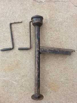

      Sorta' answers some of the frame<>gear dimensional questions. On my '41 there's plenty of room for 9010HD-CW's, and only a hand made Volvo (or similar) car jack and part of a grooved pulley welded to a chain will lift them off the truss. Weld a pin to the bottom of the jack to fit the top holes in the truss. Weld a chain or attach a cable to the lifting arm close to where it attaches to the main jack. Weld about 1/4 of a curved grooved pulley to the other end of the chain and insert it under one bungee at the truss. Screw the jack arm up and lift the bungee off the truss arm.
      Edit: The pulley mentioned is made of steel and only the curved and grooved rim portion is welded to the chain, not the pulley center. The ends of the grooved pulley are ground in a taper so as to slip between the bungee and truss mounting tab when the jack is cranked up away from the truss. Eh?

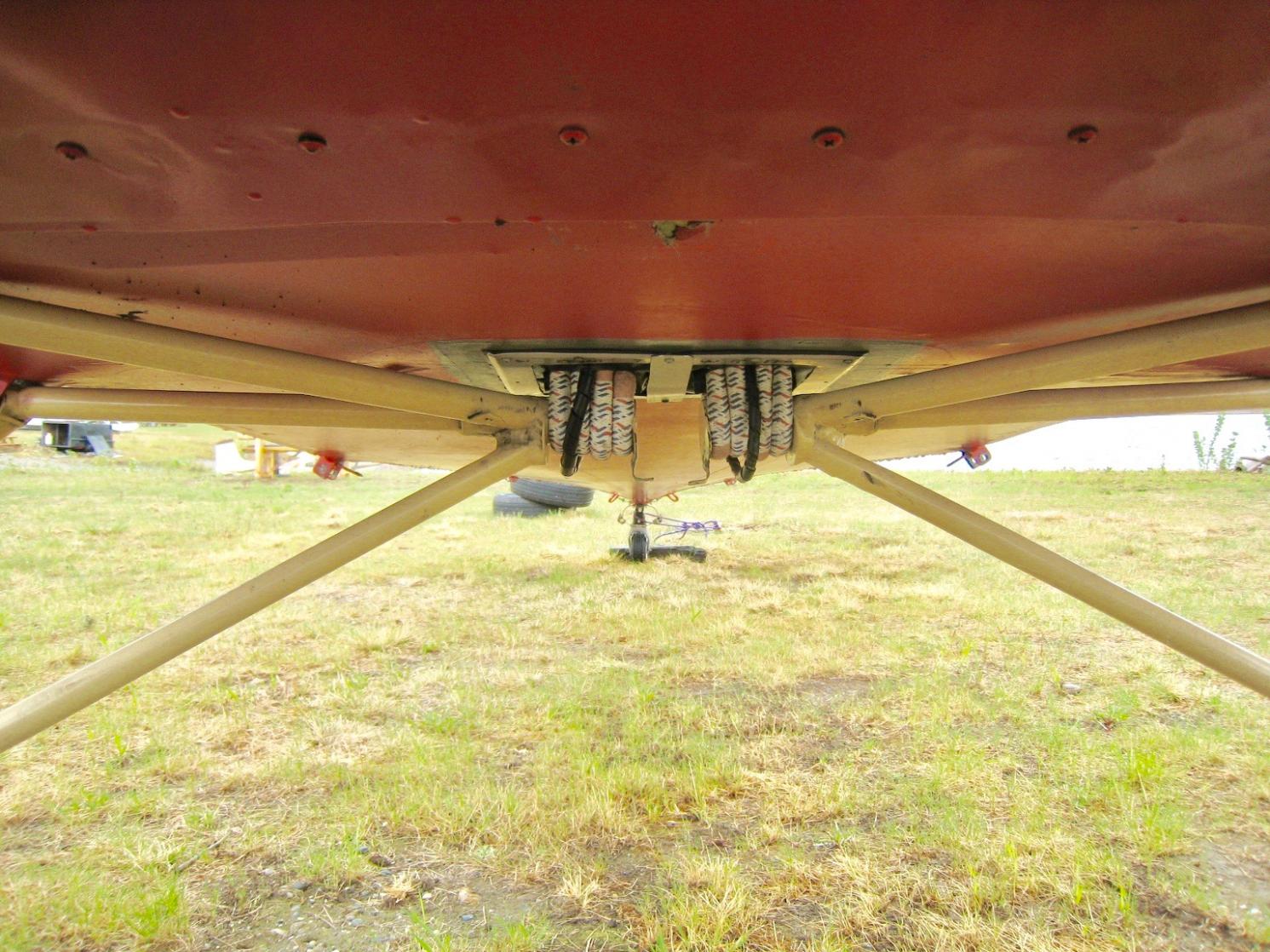

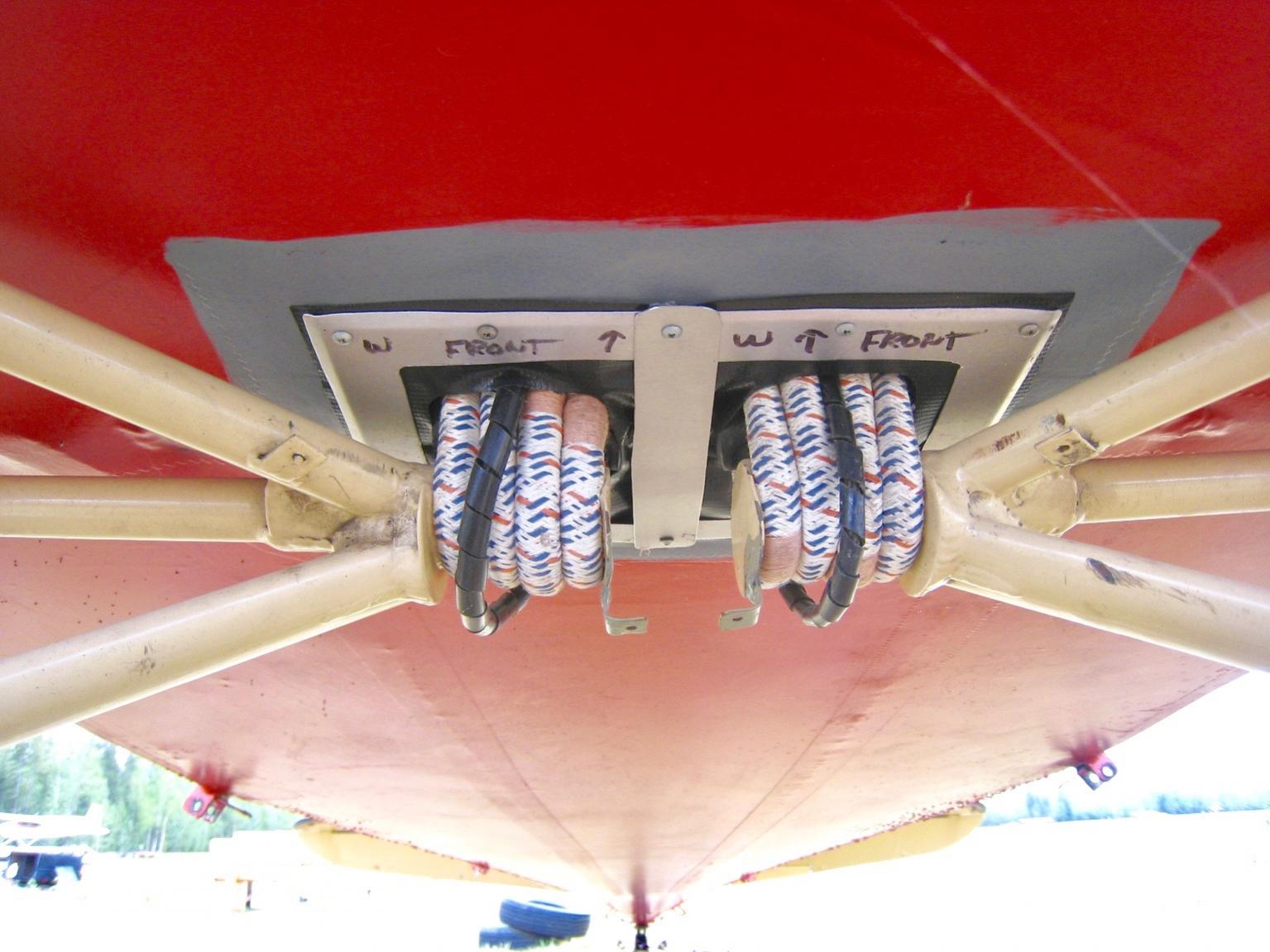

                      Ta Da!
                      The hole in front of the gear in pic #3 is for my water rudder retract fixture that's removed when not on floats. It's sealed from above.
                      The black material that's the seal is split on each side to fit over the bungees. It's cold weather flexible fabric used for on-ground fuel tank leak sump liners. The mechanic glued a polycarbonate support ring to the belly fabric with Stewart's, taped over it, and covered with Stewart's silver. The metal overlay is screwed to the poly plastic with PK screws. A full fabric cover replaces the one with holes when on floats.
                      Edit: We also considered adding partial covers over the exposed bungees. Something like a U-shaped piece of that tough vinyl material over each cluster and then extended up into the fuselage and fastened to the bungees. But tech met time and this is as far as we got.

                        Why not use proper bungee covers? That's what those three little screw attachment tabs are for.
                          Re: Can I use 9010 bungees in place of 9090
                          Because my aircraft belly is different than standard. If the rotten wooden underlayment is removed and the fabric attached to the tubing (see Pic #3) those covers (I bought a set from David Wenglarz) don't close up against the offset created by that wood framing. There's a gap the thickness of the woodys between the metal covers and the belly fabric that would allow in exhaust gas and whatever.
                          This configuration is not uncommon in Alaska. The addition of seals is something not every owner has done. Some just let it all hang out.
                          Edit: That part of the airframe restoration was done by a former FAA PMI. If it was good enough for him it's good enough for us.

                              Hi Gary,
                              I would urge you to please get some external covers on right away to save you some money and headaches.
                              Exposure to elements is not a good thing for the shock cord rubber or the cotton braid and its glazing.
                              The braided cotton cover, is to help keep abrasives out of the rubber strands and provide some UV protection and a small bit of chemical protection. It however, also determines and sets overall performance of the finished cord, the rubber strands and braid work together.
                              Without covers you don’t just have abrasive dirt/sand/runway exposure, there is also water from the runway with its associated chemical contaminants from other aircraft. Obviously you have breather oil blow by but it also has combustion by products; in addition the engine exhaust is full of acid gases along with lots of water, soot and carbon.
                              Oil, and water makes abrasive dirt stick to the cord add ozone attack and not a good recipe for service life.
                              AC 43.13 doesn’t specify a time in service. It does require shock cords be clean and free of petroleum products and show no damage. AC’s aren’t regs but the FAA expects them to be followed, I wouldn’t want you to have a potential ramp, next annual inspection or early failure issue.
                              Maybe just use the old covers with a bit of foam to make up the gap from the earlier recover, but don’t ever fasten anything to the bungee itself.
                              Hope it helps.

                                Thanks Mark for noting the concerns and helpful advice. They've been like that since about 2010 and I only replaced the original cords because I wanted to test cold weather spec bungees. The original non-CW cords look new and weren't frayed or visibly deteriorated. But yes a better external covering would be good. I may wrap the exposed cords with similar black vinyl seal material. The cords are removed and reinstalled annually due to change to floats and back. Gives us a chance to inspect.
                                We considered sealing the original covers with foam weatherstrip spacing to cover the gap. That would reduce the UV and some contaminants but in reality the metal factory covers are somewhat open around the adjacent gear tubing and can allow ingress of dirt, oil , and water. Without a low point drain hole there's no way for that to escape. Plus any exhaust fumes is free to reach the cords and rise into the cockpit. It's more limited when the gear retracts into the original wood framing of course.
                                Now one thing that does happen to both factory and uncovered bungees here is cold weather. In the deep cold (down to -50F locally) shock cords relax and stretch especially when on skis. The skis are flat and unlike tires create their own fixed landing gear angle when on the ground. Tires will allow some camber and let the bungees initially retract. But as soon as the plane is moved in the cold or the soft Airstreak tire sidewalls flex the gear spreads and the cords are exposed by the standing weight of the aircraft. When it warms back up the rubber will try to pull the gear in but that can only happen if the tires are moved, never on skis.
                                One last obs. Cold weather shock cord isn't worth the additional expense over normal. These planes are so light that the 9010's rarely flex under normal loads even in summer. I can lift the opposite tire off the ground by pulling down on the other wing. The bungees never give and the tires do 90% of the shock absorption. Makes for a rough ride on skis especially on new unworked cord material.
                                We'll keep an eye on them at each annual.
