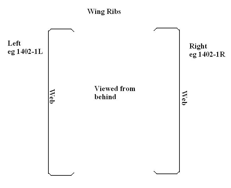

    I think I've got this straightened out in my head but just want to be sure;
    There are two basic styles of stamped ribs and they are identified by either 'L' or 'R' in the part number. Each wing has a combination of the two styles, however most of the 'L's are in the left wing and vice-versa for the right. I have a sketch that shows rib locations by part number.
    I haven't been able to find a drawing or sketch that clearly identifies the two rib styles, but I've deduced that the L (or left) ribs have the web on the left, flanges right, and the R (or right) ribs have the web on the right, flanges left. I've added a sketch below.
    Can someone confirm that I've got this right?
    Thanks
    S

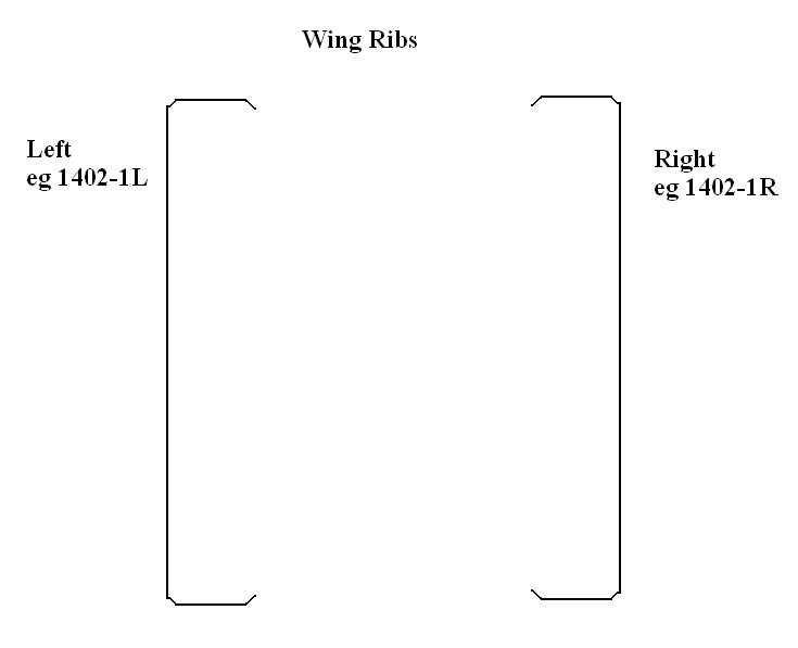

                      Re: Wing Rib Orientation
                      Wow I seemed to have opened a can of ribs...
                      Ok sorry I didn't specify the view on my sketch. Default is always view from behind which is what I sketched.
                      So with that in mind and based on all the above help, I believe I have the correct orientation. Dave the Page 23 is the sketch I have (though I wasn't aware it came from Taylorcraft).
                      Piecing everything together, and assuming the root rib is rib number 1, rib number 2 has the flanges pointing outboard, which according the the sketch (left wing) makes it an 'R' rib. The last full rib is rib number 8 and is also an 'R', but it has the 0890-2L doubler which creates the inboard end of the aileron bay.
                      I updated my sketch

                        Hi Scott,
                        I updated my sketch
                        The ribs that I marked when I removed them demonstrate the opposite meaning than what you wrote. But what you wrote makes sense with respect to the out board aileron rib. The inboard aileron rib could have the doubler on either side and work.
                        But there is no guarantee that mine were installed properly, but I am not aware of any time that they had been removed.
                        If I look at my plane now it will be as I interpreted it because I copied what I removed.
                        I may have a rib with a p/n stamped on it but I can't get to it for a while. Wish we had access to drawings. Maybe another parts book has a clue?
                        Dave R
                            I was looking at the wing drawings in the .pdf file of drawings that was posted a few weeks ago.
                            After looking I confess that I was holding my ribs upside down (wing tip light wire at the bottom) so that may explain why I see it as I did.
                            So I think that you are correct Scott.
                              Part numbers aside for a minute, I've searched the site and the Web for pictures of assembled wings. What I see is that rib number 2 has the flanges pointing outboard, ribs 3 through 7 flanges inboard and rib 8 flanges point outboard. Beyond that it's difficult to tell except a couple of ribs near the tips.
                              Anyway what I see in the photos for the first 8 ribs is consistent with the page 23 sketch.
                              I'm wondering if adequate clearances between wires and structure can be maintained if the ribs are not in the right positions. Perhaps all will become clear as I work through assembly.
