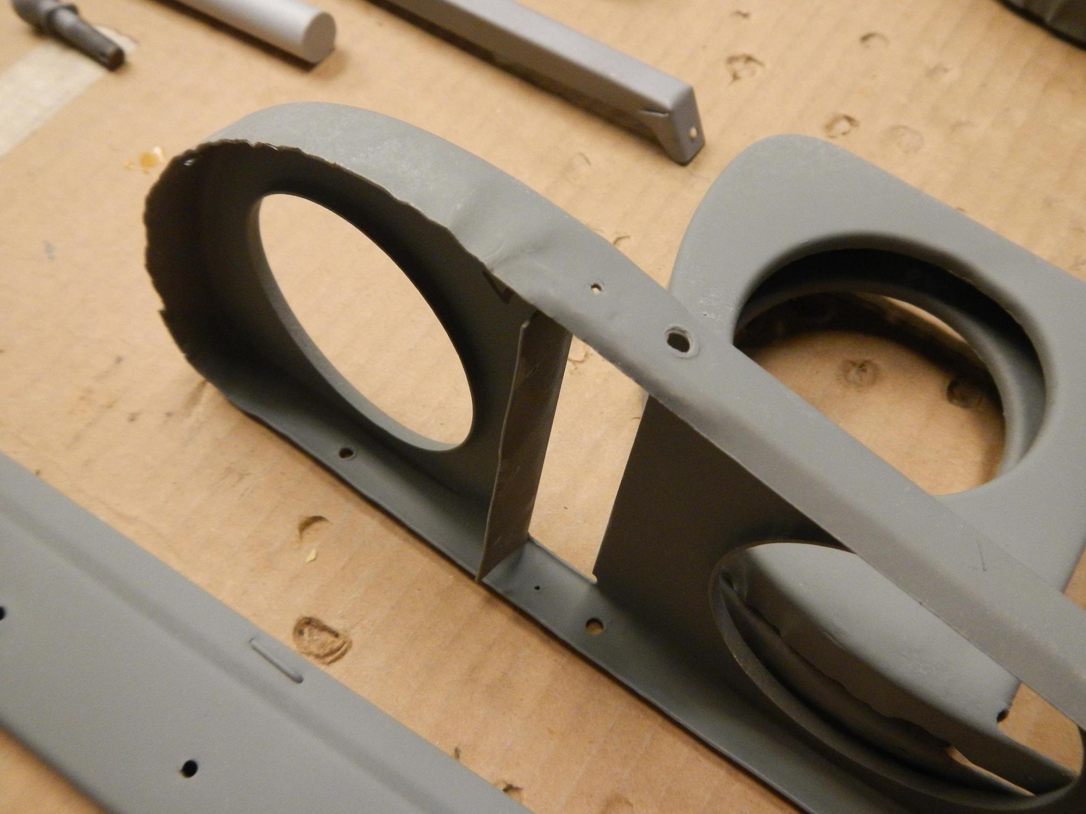

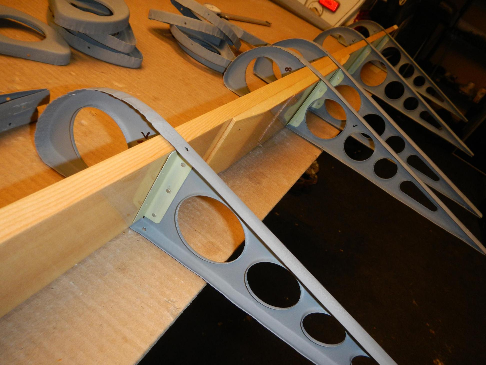

The leading edge structure of ribs and curled aluminum sheet in addition to the trailing edge will provide a structure that keeps the front and rear of the ribs spaced consistently from one another in the spanwise direction. Also it will keep the forward part of the ribs oriented "vertically" (ie. orthogonal to the span).
The fabric and it's attachment to the ribs will keep the center portions (between the spars) of the ribs consistently spaced and "vertical" if the butt rib and wing tip are attached to the spar. This will maintain tension on the fabric in the spanwise direction which is needed to keep the center portion of the ribs in place. Taylorcraft butt ribs mount on the butt end of the spar so that is good.
When I imagine this structure I see a leading edge and rib structure holding a number of ribs that are all attached to a trailing edge with a tight fitting fabric bag wrapped around all of it attached to each rib. The fabric bag is being pulled at each end in the spanwise direction thus putting tension on the fabric and keeping each rib separate from it's neighbor.
You don't even need spars in it to imagine this structure. If I apply a vertical load to it this structure it will fail when the leading or trailing edge bends or the fabric tension is not sufficient to keep the center portion of the ribs in place.
Imagine putting spars in it and they now provide the means of pushing the fabric out at the butt and tip thereby putting tension on the fabric.

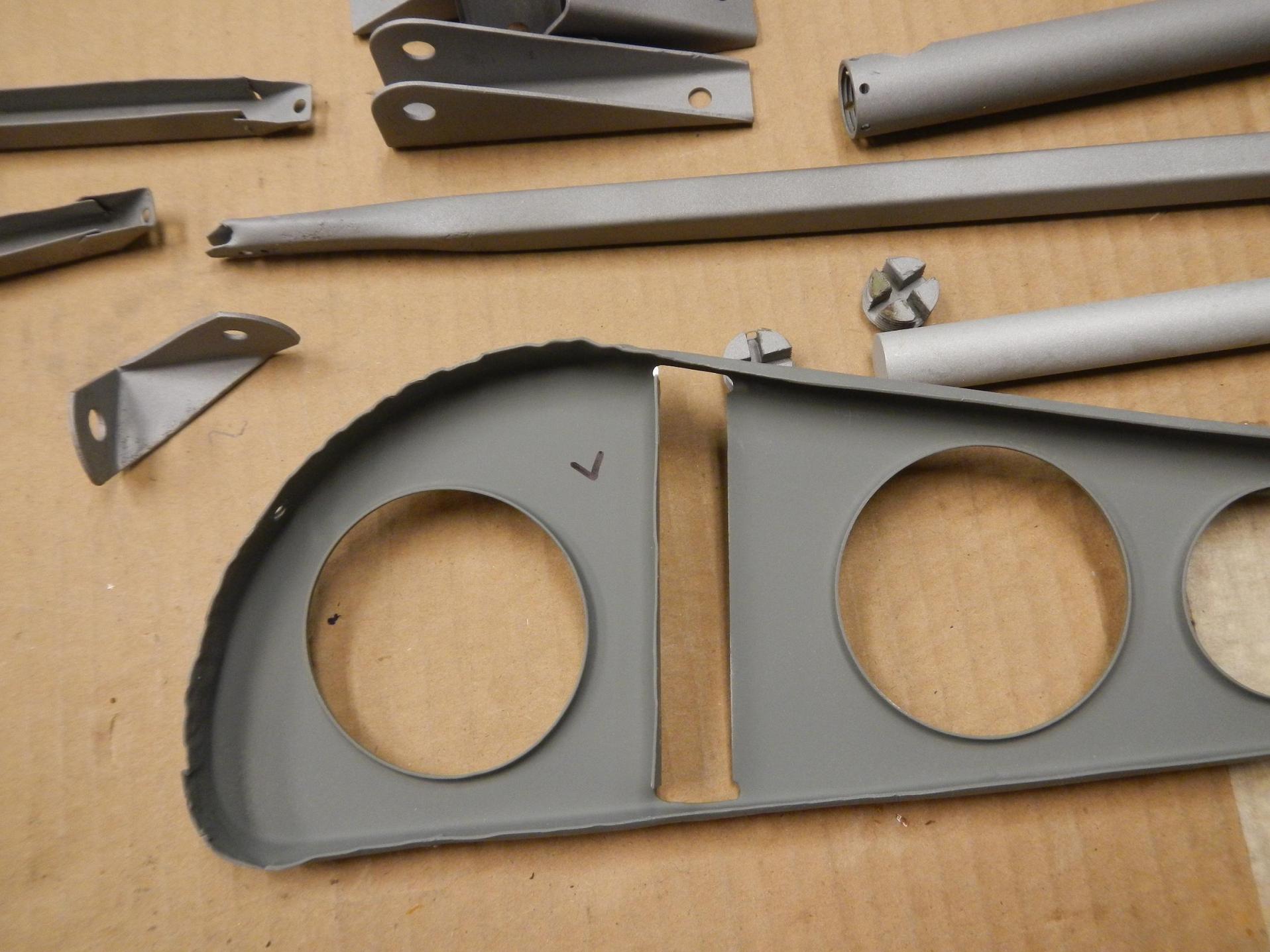

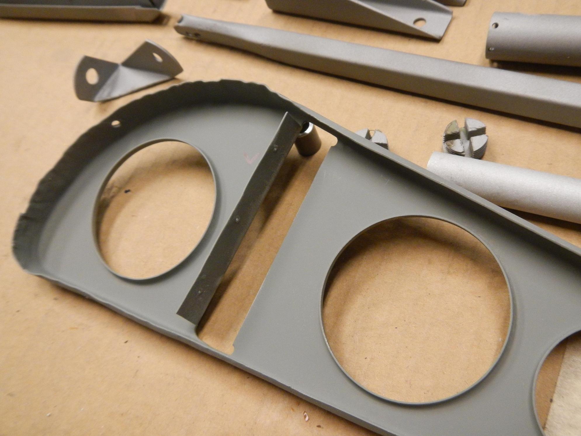

The ribs slide over the spars and can move up and down on the spar depending on the difference between the height of the spar and the height of the hole in the rib. This amount can be different by up to 3/4" so a rib could in theory be moved up or down quite a bit.
Usually I line up the top of all of the ribs in a straight line so that it ends up that there is a gap between the top and bottom of the spar and the rib hole. Each rib may have different gaps but the tops (and bottoms) of the ribs make a straight line.
That nails hold the rib in the placement I described above.
If I remove the nails after the wing was assembled I imagine that the ribs would eventually slide up enough that the bottom of the rib hole pressed against the bottom of the spar when in level flight. The wing surface may look funky at that point and I suspect that the trailing edge would look wiggly too.
In negative loaded wing conditions the ribs could slide all the way down so that the upper spar surface was was pressing against the top of rib's spar hole. The transition to this state may be awkward and unpredictable in flight as well as the transition back to level flight conditions. We don't like unpredictable

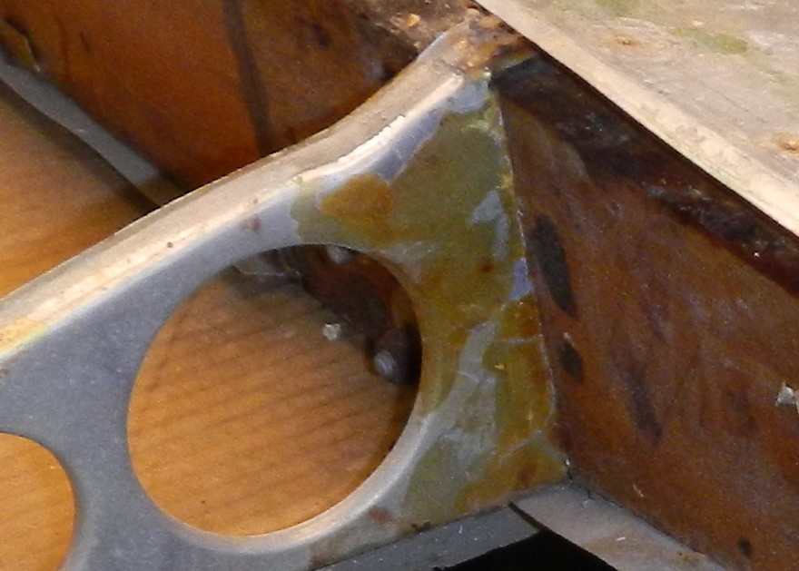

Here is another thought that I almost forgot. Will the top and bottom of the rib (flange) be able to handle the load it must apply to the spar and will the spar be able to handle the rib applying that load. Will the rib hole get deformed? Will the spar get cut into by the rib hole?
The load on each nail for a 1200 lbs plane with 15 ribs per wing and 6 nails per rib at 4g is;
(4 x 1200) lbs / ((15 x 2) ribs x 6 nails per rib) = 4800 lbs / 180 nails = 27 lbs/nail
That works out to about 81 lbs applied to each rib flange at the spar hole and 81 lbs applied to the spar top and bottom by the rib flange which could be merely a sheet metal edge depending on design. That may not be so good depending on the design. Rib nails will keep the ribs in place so I guess I will care.
That's my thought so far, Dave R.
