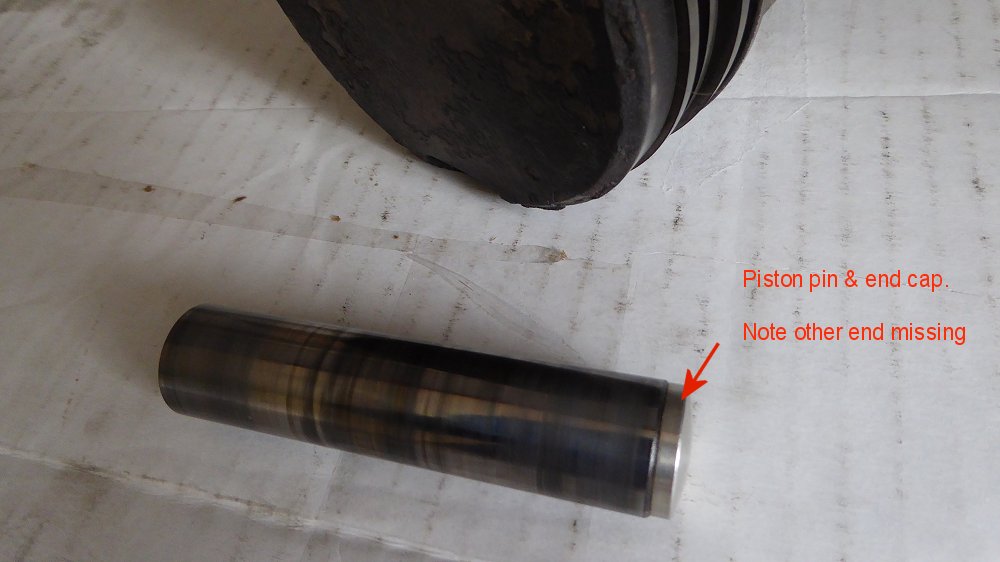

      The reason is, that I think the people who did an engine overhaul forgot to put a piston pin plug in.
      I need a completely independent inspection, by a Certified Lab, to Internationally accepted Standards, of the content of the oil screen debris of my failed engine.
      Background: I had an engine failure in my Taylorcraft in Oregon, fortunately with no consequential injury or damage, but the engine required rebuilding later.
      The oil filter was full of metallic debris, and it is my suspicion that this debris is from a broken portion of the piston (aluminium alloy). The steel piston pin that connects the piston to the conrod floats in the piston, and has aluminium end cap at each end that lightly rub against the cylinder walls (by design). It is my suspicion that the original engine overhauler neglected to fit one of these plugs, so that the steel piston pin was able to rub directly against the steel walls of the cylinder, leading to failure of the piston.
      I must assume that the piston pin end cap and the piston, although both appearing to be aluminium, are of different alloys. Unfortunately, I do not know what those alloys are, but a comparison may provide the information I need.
      So I would like supporting proof that the debris contains no significant proportion of the end cap material, so supporting my theory that the end cap was never installed.
      Photos attached, thanks for your input!

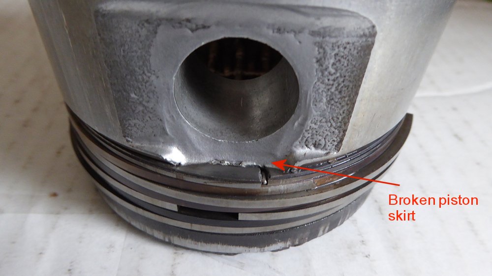

        Rob, I suggest you go ahead and do your testing, because it will make you feel better.
        However I do know that on occasion that the little aluminum plug in the end of the piston pin will decide to turn itself into little metal shavings. My dad's airplane had this happen one time. We were doing an oil change getting ready for Sun'n Fun, to find the screen full of metal and collapsed. When we quizzed an old time A&E he said, it is not common, but does happen from time to time". When we tore the engine down there was just a small ball of aluminum floating in the pin interior. We found no damage except the plug and collapsed screen. On advice from the old A&E we flushed the engine out and re-installed the Cylinder with a used pin plug. The airplane flew like that for quite some time afterwards with no ill effect.

            looking at the photo of the piston, it looks like something was fretting around (for quite some time) between the piston pin boss and the cylinder wall. Question I have is what was there if it wasn't the plug?
            To me the damage to the piston looks consistent with a failure of the plug which subsequently orbited around and around, while still keeping the pin from contacting the cylinder wall. Once the remains of the plug was fretted away I expect the pin contacted the cylinder?

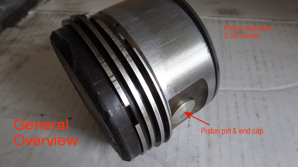

              In picture #4 note the left edge of the pinned steel ring assembly below the wrist pin hole...gone disappeared and hard steel versus the aluminum pin plug. Where did that particle go? Also see the adjacent scoring to the right on the piston's lands. Is that a multi-piece oil control ring? (Edit: appears to be a mono slotted oil control ring).
              Wouldn't take much steel to destroy aluminum, and how could the steel ring be abraded by the softer aluminum, perhaps by the adjacent anti-rotation pin after wrist pin plug failure? There is scoring (carbon?) on the other pics of the piston skirt. The faces of the rings indicate adequate break-in cylinder pressures and wear due to ? that penetrated to the broken ring which has a >50% wear surface.
              Engine history and time in service? Air cleaner functional? Were the valve seats worn abnormally from intake air abrasion? Was the cylinder cross hatching normal or still rough?

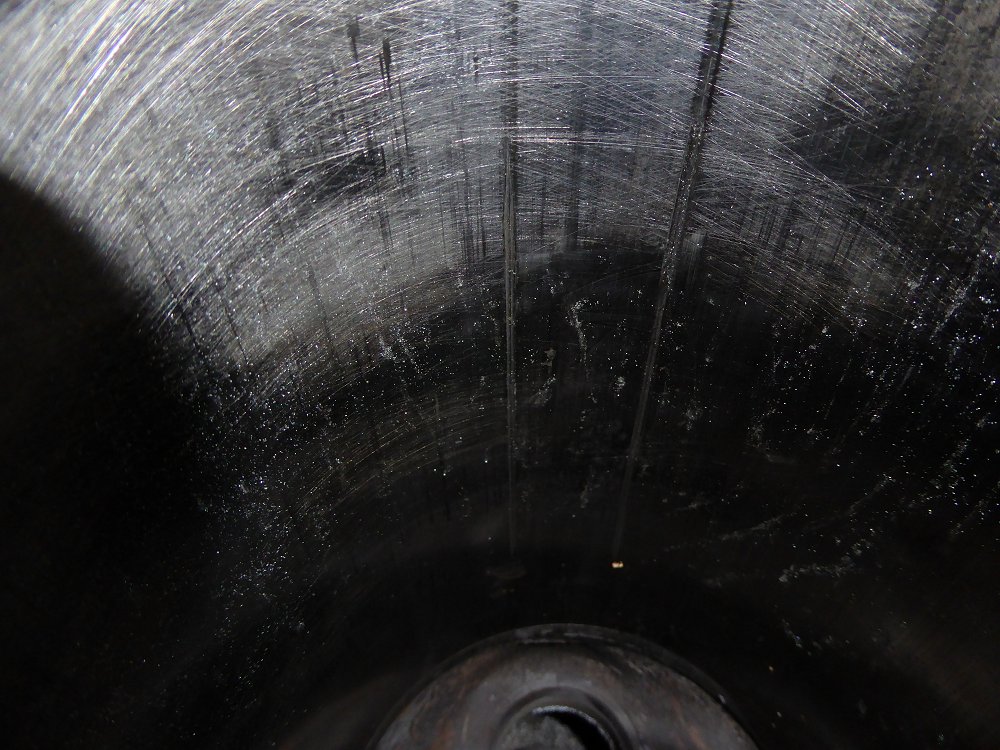

                What did the cylinder wall look like?
                I had a tractor that was assembled without the wrist pin caps.
                One result was that a very nice deep groove was "machined" into the cylinder walls on both side of the cylinder because there were no end caps.
                Did your's have a groove too?
                  Re: Continental metallurgy specs?
                  It did (well two grooves actually, caused by the wrist pin end contacting the cylinder wall).
                    For what its worth my groove was a wide as the pin and was about .062" deep.
                    It had many hours on the engine so lots of time to wear in.
                    How many hours were on this cylinder?

                      I would suggest that I don't think a metallurgical analysis is going to tell you anything. You have Aluminum from 2-3 sources: piston, plug and valve train. No valve train damage there so you are left with piston and plug. If they could do a spectral analysis and there was Si content of less than 0.6% then that would say no piston damage, it's all plug.
                      Since you have physical evidence both piston damage and a missing plug they can't tell the difference.
                      Did you collect all the chips?
                      Before your send anything away....
                      I would suggest you weigh your old piston and a new one, give you the missing mass. Weigh a new plug.
                      This is the total possible mass of chips. If your mass of chips exceeds the missing mass of the piston, they put a plug in.
                      If it is equal or less than the piston missing mass they missed the plug.
                      Now you're left with, did they reuse an old plug and it worked out? Different issue.
                      But plug failures happen; since the plug is T4, not as hard, it can both be pressed in and not tear stuff up so bad when it goes bad.
