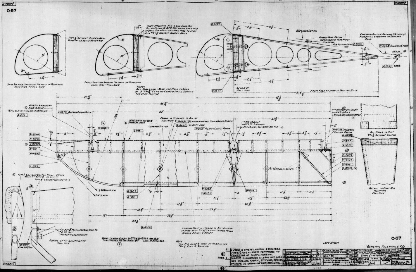

    Hello All, I bought a BC-12D basket case serial no. 6858 and need to recover the ailerons. Please advise the method of replacing the aluminum skin on the leading edge. I have a few pictures but would like to see the drawings if possible.

                Ah. I see. Try the pic attached to see if that helps you. I have a bigger file version too, but needs sending via email. A lot of this info is from the L2 Drawings.
                Yes, the leading edge is attached using PK screws.
                Hope that helps,
