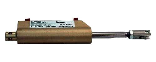

                            I have assembled most of the pieces to do the job using these cylinders...new
                            Matco MCMC-4 Master Cylinder MATCO mfg's MCMC-4 master cylinder uses a REMOTE reservoir. The MCMC-4 can be used in individual or dual brake applications. Buna-n orings are used in this assembly. Mil-H-5606 aircraft hydraulic fluid or compat
