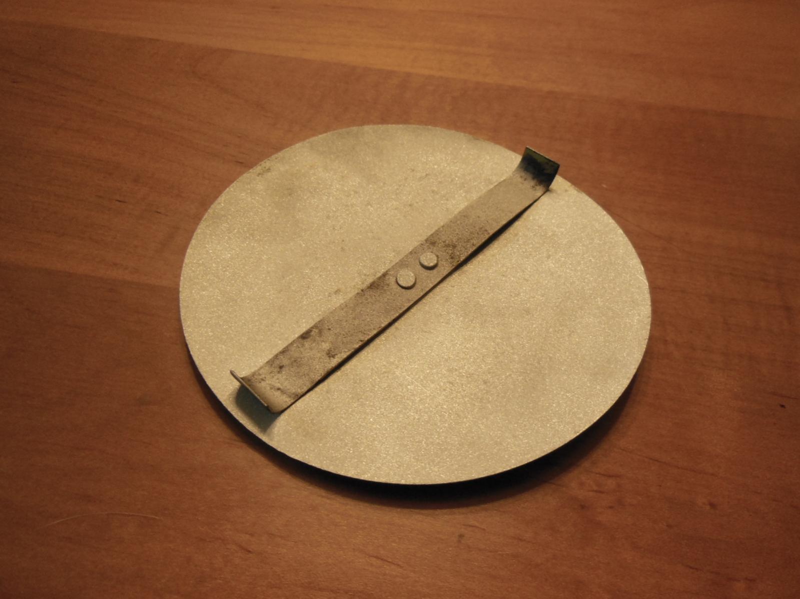

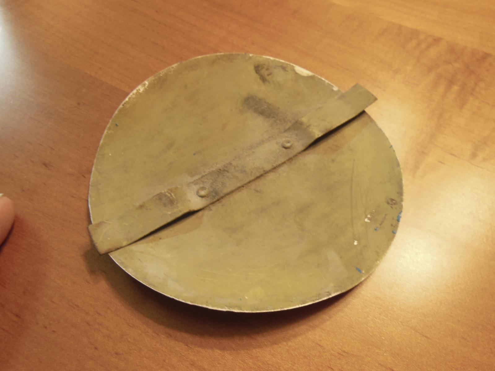

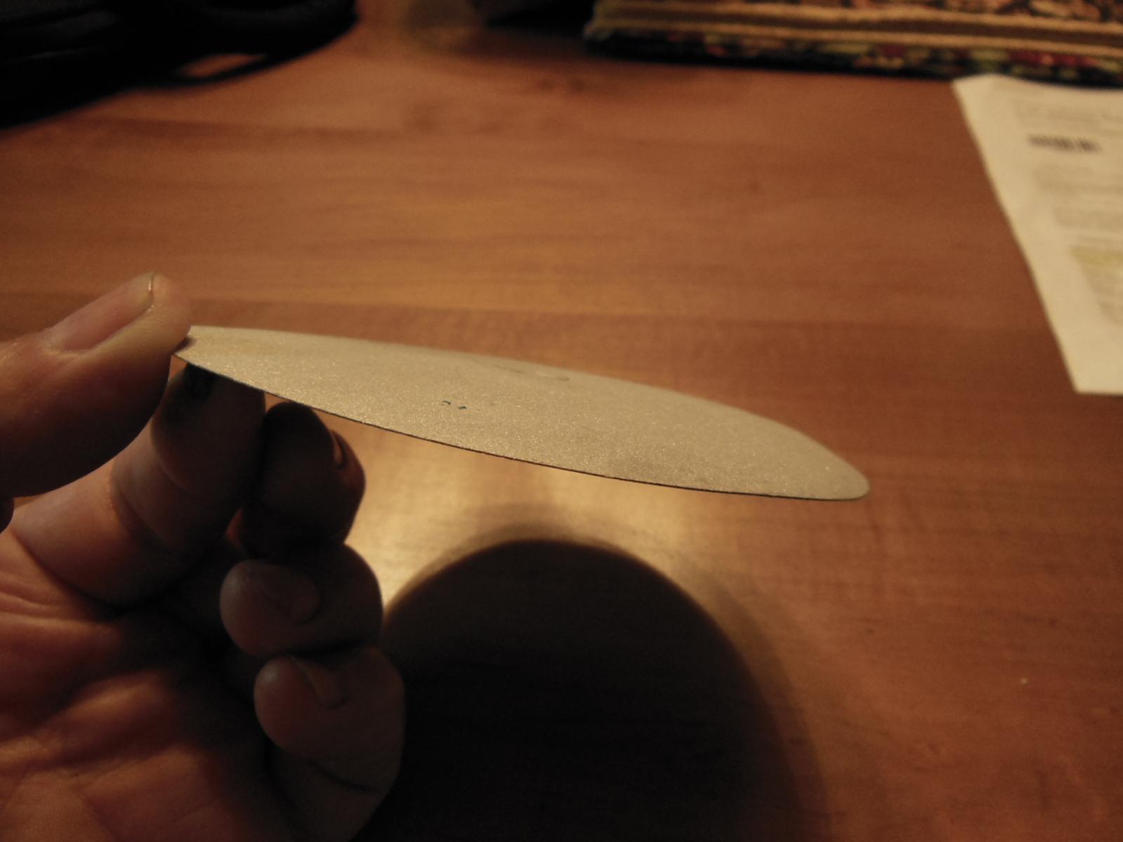

    I have been cleaning up metal parts in preparation to recover my Aeronca.

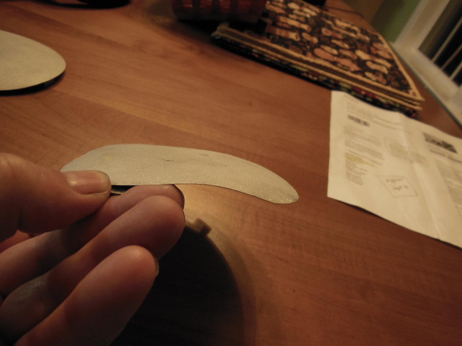

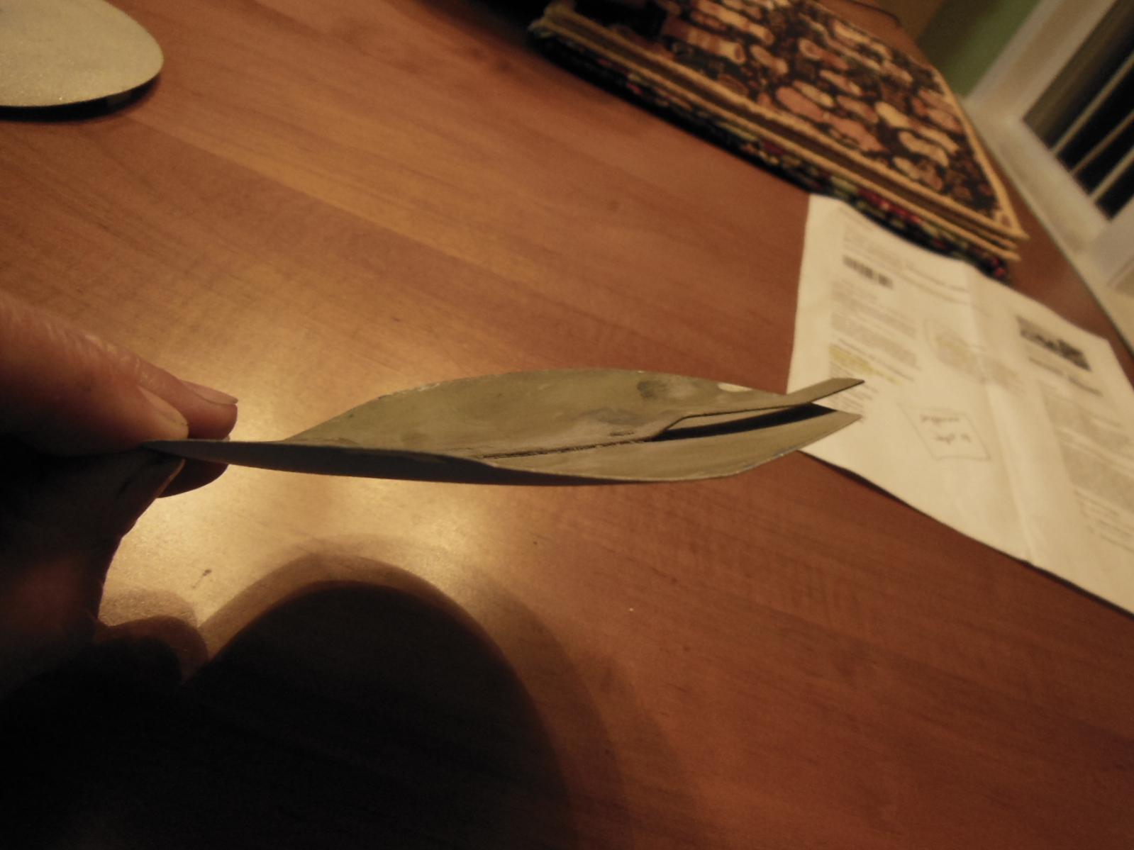

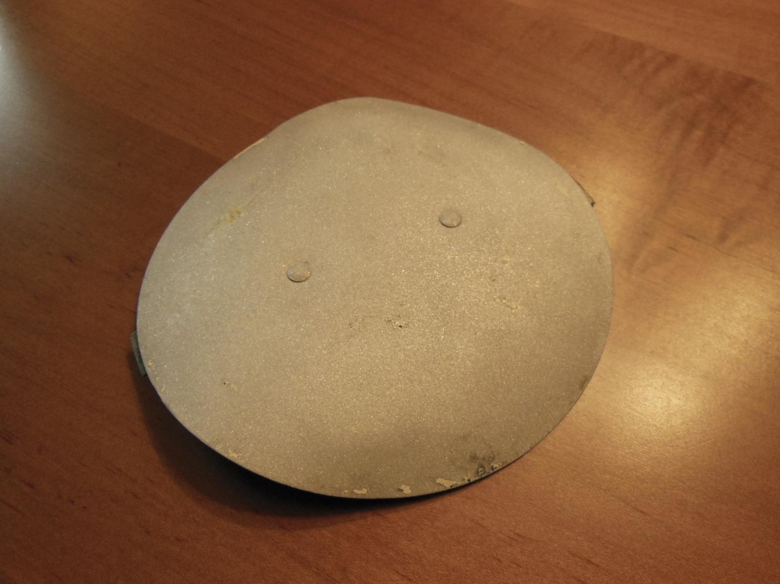

    I glass blasted the painted side of some inspection covers and marveled at their condition. They were a wavy as a potato chip!
    Soon I noticed that they were quite flat before I blasted them and the waves appeared afterward.
    This may seem odd that it took a while to notice but working in a blast cabinet with dust flying and light being obscured make it more tenuous.

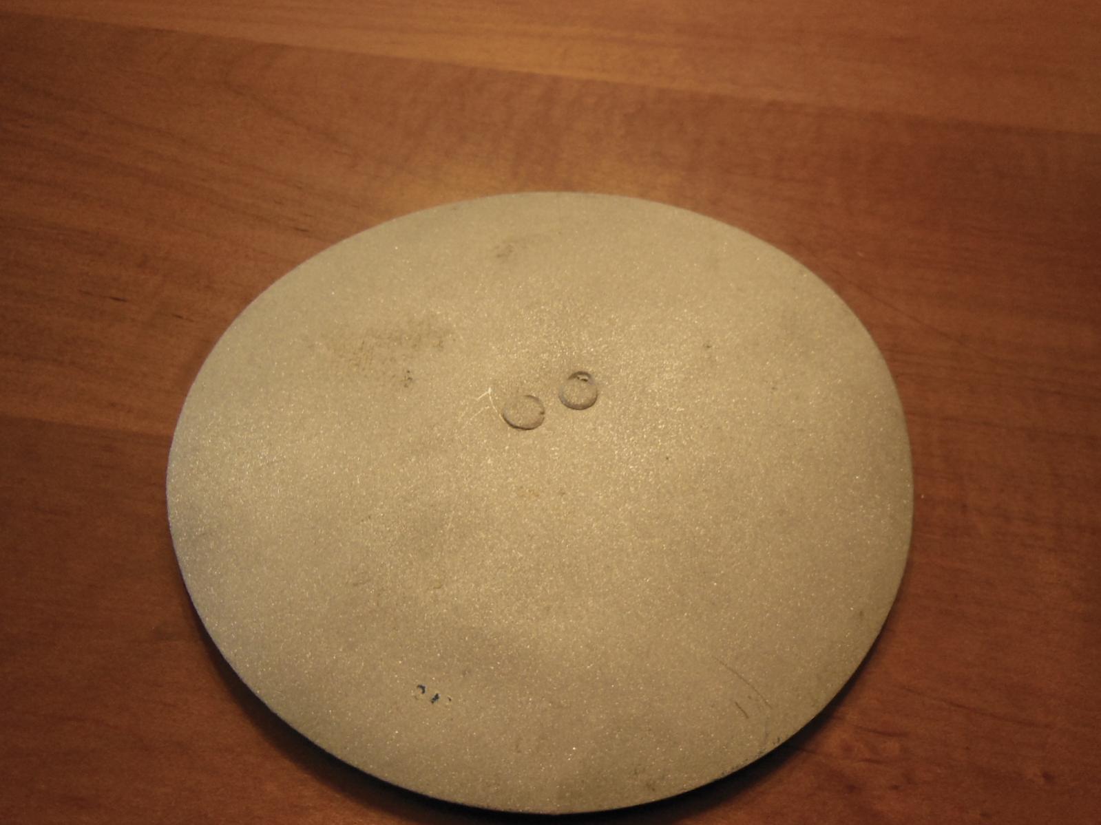

    So I then began to blast the unpainted side and sure enough they snapped back into shape.
    Pictures are attached.
    Apparently the glass peens the surface and adds a compression stress that makes them become wavy until you blast the other side and "equalize" it.
    I also think that I noticed that if I blasted the painted perimeter first the waviness was less.

      The guy that taught me to "knock metal" always told me the only thing you can do to metal is stretch it...even the "shrinking" is done by stretching.... it took me a long time to wrap my head around that, but he's right.
      Did you experiment with lower pressures, Dave?

              Re: Entertaining result apparently from peening action on aluminum surface
              No I did not. I think I have it set for about 65 psi.
              I may try lower psi later. I think that I have some of those kind of covers to test the lower pressure.

                        Hi, what you have observed is a commercial process, "Peen Forming", that is some 50-60 years old. It is used to form the wing skins of a really, really fast business jet after they have been machined to final thickness which tapers from wing root to the tip. The process uses a combination of metal shot size and intensity of impact on the surface to-be-formed. Think CNC sand blaster gun (like you demonstrated) or pellet-type lawn fertilizer spreader.
                        It can be used to form shapes, improve material properties, apply decorative finishes and tailor the insides of tubes for better flow and material movement. It is generally a CNC process but is some cases done by hand. The compressive stresses on the material surfaces improve fatigue performance and reduce crack initiation and propagation.
                        The more recent developments are the conversion to lasers in lieu of metal shot. The shock wave of a laser pulse impacts the surface creating the same effect, but it is more controllable and has deeper effects into the thickness of the part. However it is less exciting without the 10's of thousands of tiny shot balls flying all over the place. Metal or laser shot can be applied to any kind of metal part including gears and other machined components to improve wear and corrosion performance. It can also rework damaged parts.
                        Metal Improvement is one of the more prominent shops providing this service.
