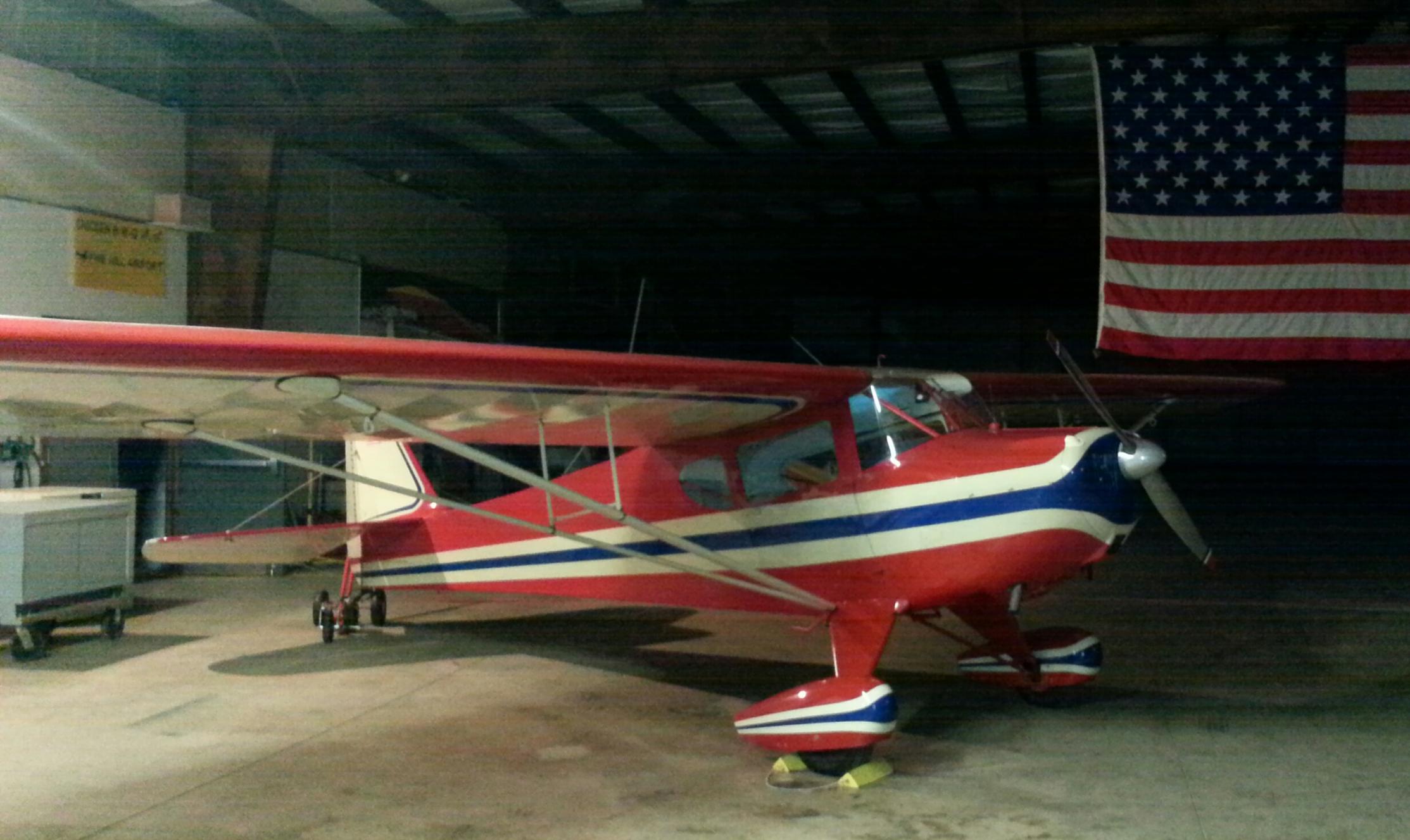

    As a fairly new to me Taylorcraft owner, I have learned enough to have a few questions. N95938 is a 1946 BC-12D that during restoration has a C-85-12 installed. This spring and summer at between 2100-2300 rpm it trued and confirmed with GPS runs between 92 and 100 mph burning between 4.2 and 5 gallons per hour, so I think that's pretty good.
    Sunday it was 27 degrees in the Buffalo area, severe clear, light crosswind and after two months of night flying the plane was calling me (11 year old son was calling my cell saying "Fly Taylor!!!). I installed the winter plate on the cowl and inflated tires.... first question what tire pressure, my POH, if can call it one is silent. They let me keep the plane in the museum part of the hanger, so very secure water tight and maintain 40-45 degree minimum temperature and it was 44 in there so I figured pre-heat not necessary, oil dripped as always. Once outside I spent more time than would have liked getting tail tied and wheels chaulked, and people talking and admiring my 8th coat of wax on it (son degreases and waxes the bottom every other flight). I'm new to handpropping so I am VERY scared I mean respectful of it. When starting my son is nervous too and asks for my cell, has 911 typed in and thumb above send when I get in front of the prop.
    The plane that always starts the first time with one shot of prime took me an hour to get started. Maybe armstrong starters don't work as well in the winter? Is there any pointers for cold weather starts? I thought it needed more prime, mags off, one more shot and pulled blades through few times, but noticed small wet spot of fuel under the cowl, so it had fuel. Then figured I flooded it, so mags off, full throttle and pull prop through a million times until no more fuel dripping out (per the manual). Finally annoyed disgusted and fighting to keep blue words in my mouth, I told Ethan one last try or I'm putting this pig away. Of course that must be the trick because it fired up, instantly running smooth at 300 rpm and he yelled oil pressure 15 Dad.
    I learned cold weather makes a big difference in flying qualities. I was having trouble staying below the 105 mph max level cruise speed even at 2100 rpm. Tail came up before had throttle all the way in and within two runway stripes was airborne and climbing strong with 18 gallons and 230 lbs of pilot/passenger meat. One thing I noticed was no matter what, I could not get the oil temp past the 130-135 degree range. Is that normal and more important okay? It seems low. Oil pressure entire flight stayed pegged at 32 psi.
    I also learned about not having a mixture control can make cold weather operation something to think about. With throttle retarded and carb heat on the engine likes to stutter or even quit if advance the throttle, but pull back to idle it starts again. So winter flying for me means higher than normal approaches and judicious use of forward slip
    At any rate we had a great time going from airport to airport getting used to cross wind landings on pavement (grass not an option with 2' of snow). The Tcraft is much more forgiving in a crosswind I think than the Champ I did my TW endorsement in, but I think the big Scott Tailwheel helps with that when you plant it.
