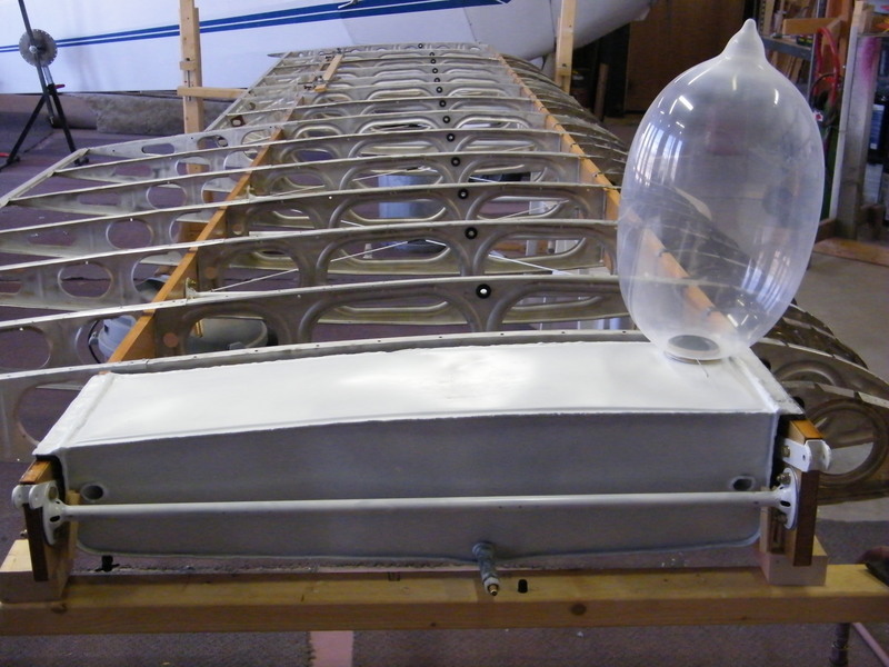

              Good point Dave. My position isn't taht repair is better than replace, just that repair in place is WAY too dangerous for me. Once it is out a good radiator shop will be able to see if the leak is minor or not. I would also pressure test it while out. Put a condom over the filler neck and put a LITTLE air in the tank. It is VERY EASY to damage the tank with air pressure. I use my mouth to blow into the fuel line, then closed the fuel valve to trap the air. Just blow till the condom fills up and let her sit for a few hours and see if it leaks out. Mine stayed inflated all night. Got a LOT of laughs from people going past my hangar!
              I posted the photos of my test if anyone still has them. Can't find them in my files.

                    ... I would also pressure test it while out. Put a condom over the filler neck and put a LITTLE air in the tank. It is VERY EASY to damage the tank with air pressure. I use my mouth to blow into the fuel line, then closed the fuel valve to trap the air. Just blow till the condom fills up and let her sit for a few hours and see if it leaks out. Mine stayed inflated all night. Got a LOT of laughs from people going past my hangar!
                    OK Hank, Here's a picture. Not the main tank, but I did the test to my wing tanks during my wing rebuild last year. I used a schrader valve in a nylon plug on the fuel line output and blew up the condom. Overnight, the thing deflated a little and I was worried until I did the old Boyle's law thing on the hot hanger in the afternoon when the tank was filled vs the cool hanger in the early morning when I checked back. The cooler air shrinks a bit. No Leak!
                    It was difficult putting just a little vacum grease on the filler neck and then a good rubber band to make a good seal. I ended up ripping three condoms before I got the trick right for putting the thing on the filler neck. Someone looked in the trash at the failures and I mentioned that we had had a GREAT party the night before.
