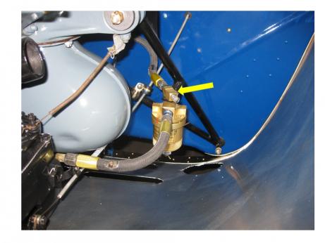

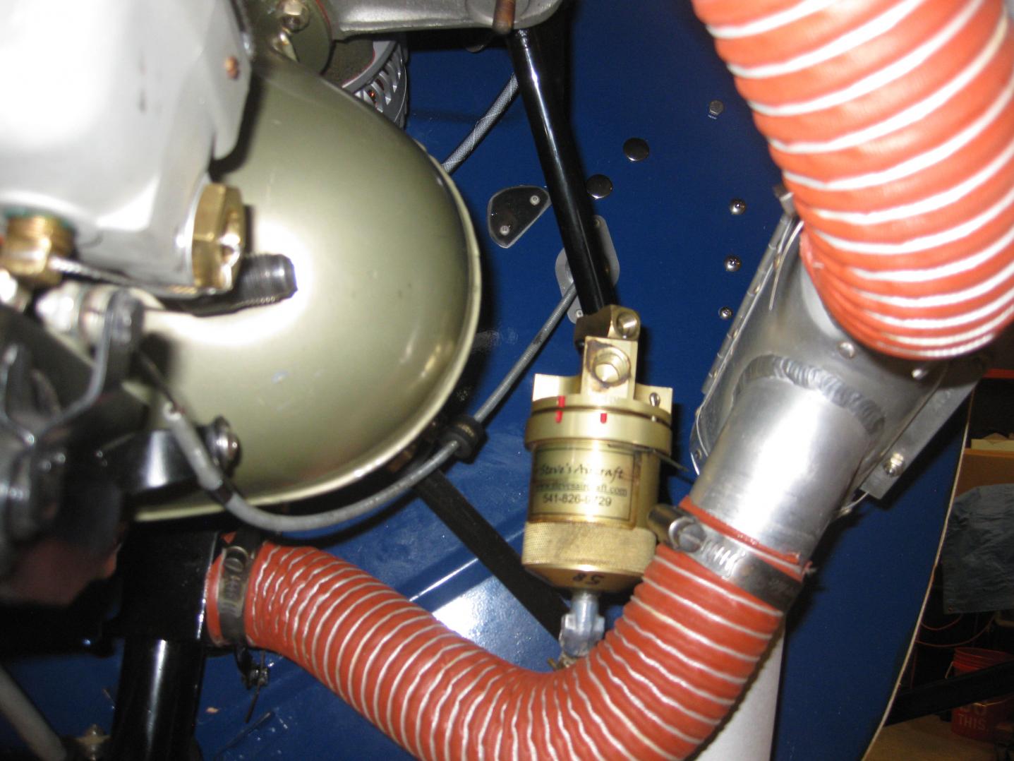

              I was looking at this thread and am wondering what the brass rectangular fitting is on top of the Steves Gascolator (yellow arrow) ? Click image for larger version
              Can anyone help me identify it?
              Is there a hollow fitting on the bottom that connects through the engine mount tab to the top of the gascolator?
              Thanks! Jay
              • #37
                Jay, that is a brass 'T' fitting. The male threaded leg threads into the top of the gascolator trapping the (stock?) mount tube/tab welded to the engine mount. The line running back toward the firewall is the feed line from the main tank. I guess the short answer to your questions is, 'yes'. This is how the airplane was when I purchased it about 14 years ago. I would be happy to send you other photos if you are interested?
                Greg House
                Brookshire, TX
                TF #1089
                BC12-D
                N96043
                • #38
                  Thanks for the quick response! It would be great to see the photos; can you send them when you have a chance?
                  How did you plumb in the primer?
                  Jay
                  • #39
                    On my 39 &40 BC airplanes , where in the above picture of the brass T has a plug in the straight thru flow, is where my primer supply line goes back to the in side of the primer. One needs to be careful how tight you screw the gascolator on the male portion of the t. The top is pot metal and cant be tightened to much or it will strip out the threads. If it gets tight and is still loose on the welded tab , disassemble and put a thin washer on top of the gascolator, using some thread sealer of course.
                    • #40
                      Thanks! Jay
                      They put that on the top to keep the gascolator from pulling through the mount, I used a 1/8" pipe to 1/8" compression fitting and a washer. I then ran a 1/8" copper line to the primer. That steve's gascolator is worth more than most of our airplanes...

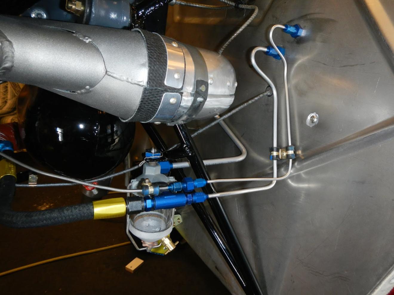

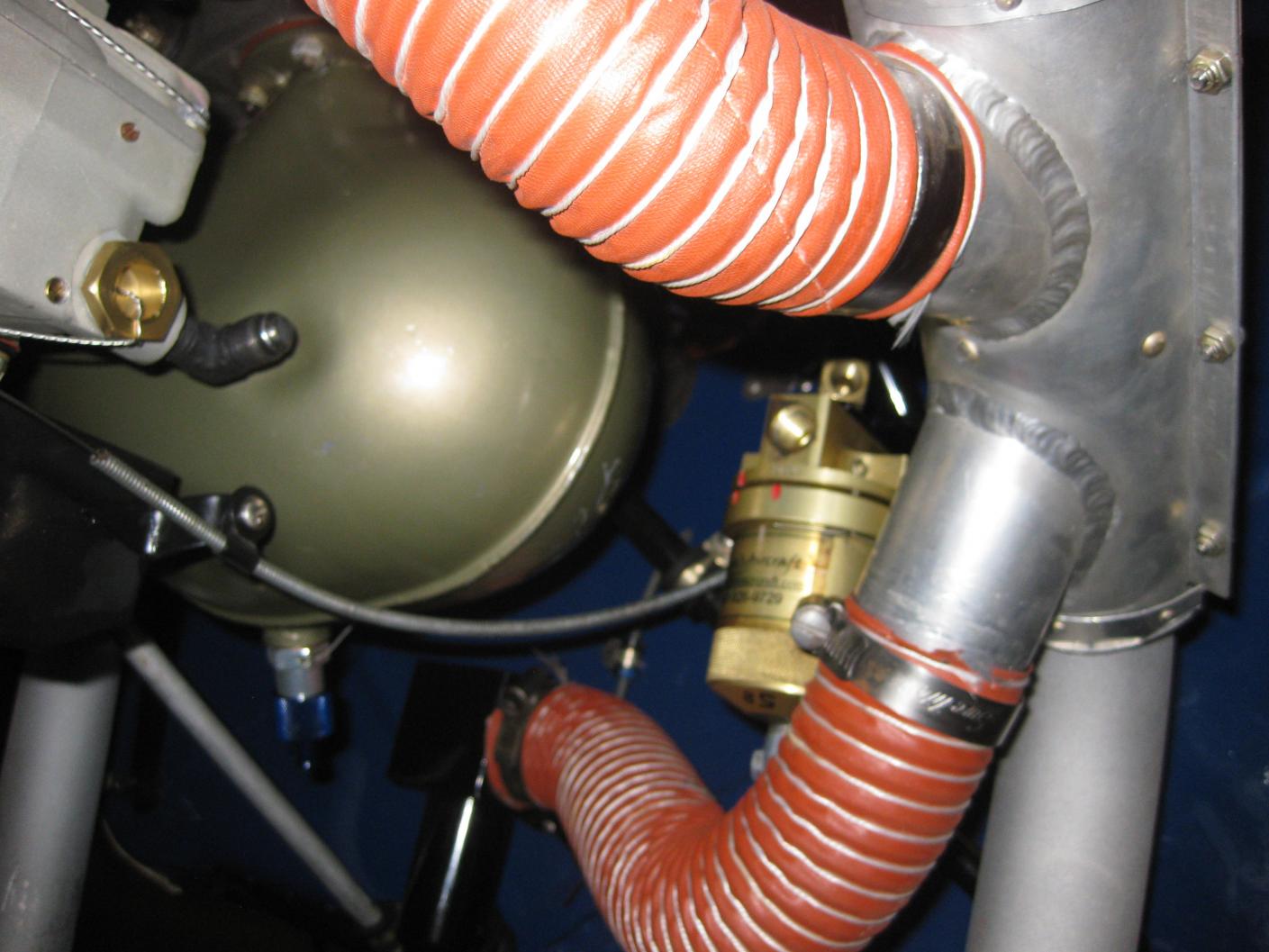

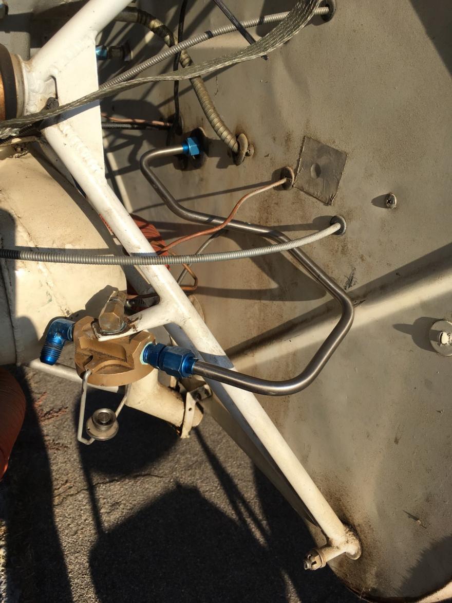

                        Pics of ones that I have redone...
                          Jay
                          I do not have a primer plumbed into my system. If I needed one I expect I could tap into the 'plugged' end of the 'T'? I will try to find or get some new pictures and send them or post them?

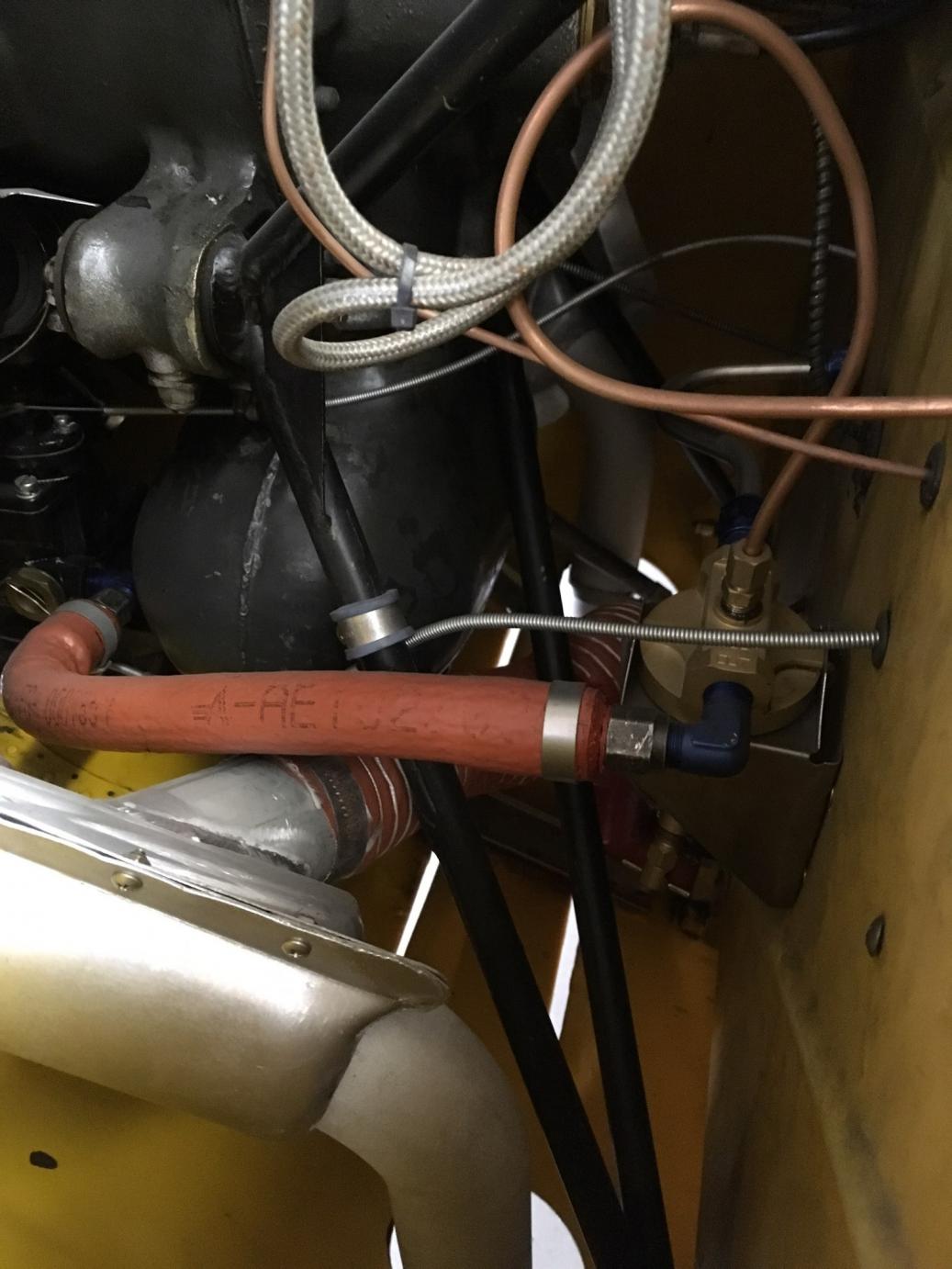

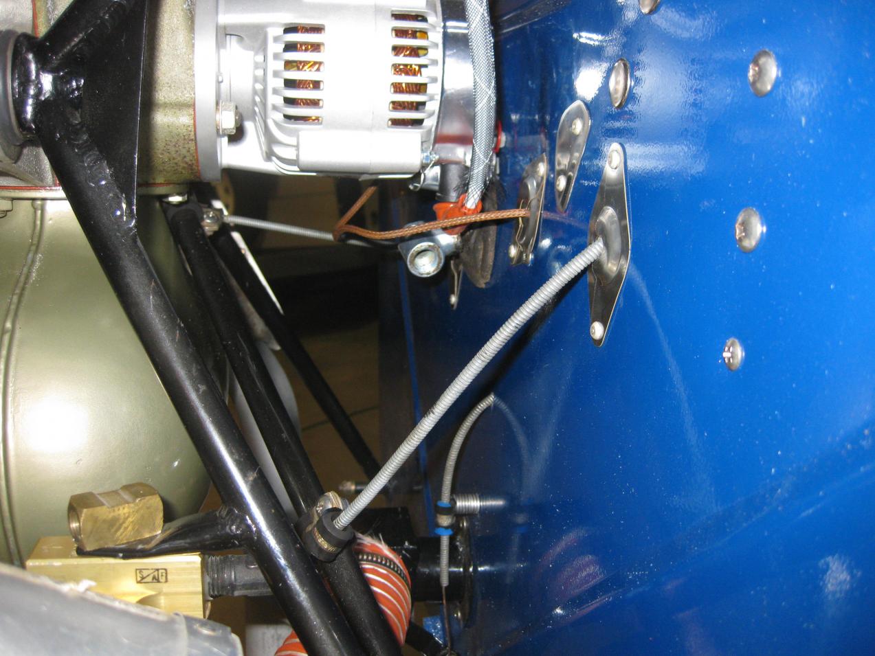

                          • #43
                            Here are few pictures. Let me know if you would like more? I can take a couple specifically of the gascalator.

                                Not sure about the specific gasolators shown, but on the stock unit that top port is unfiltered fuel. It may be that the primer system was plumbed unfiltered from the factory, but if your preference is to supply only filtered fuel to your primer and engine, cap the top port and T the primer off the outlet port ( one feeding the carb).
