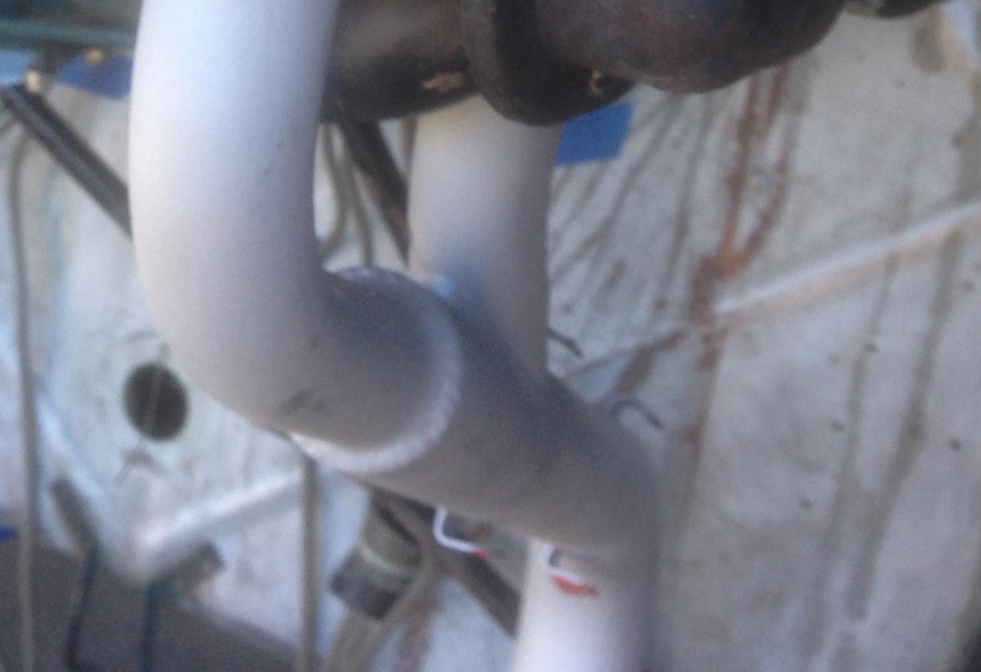

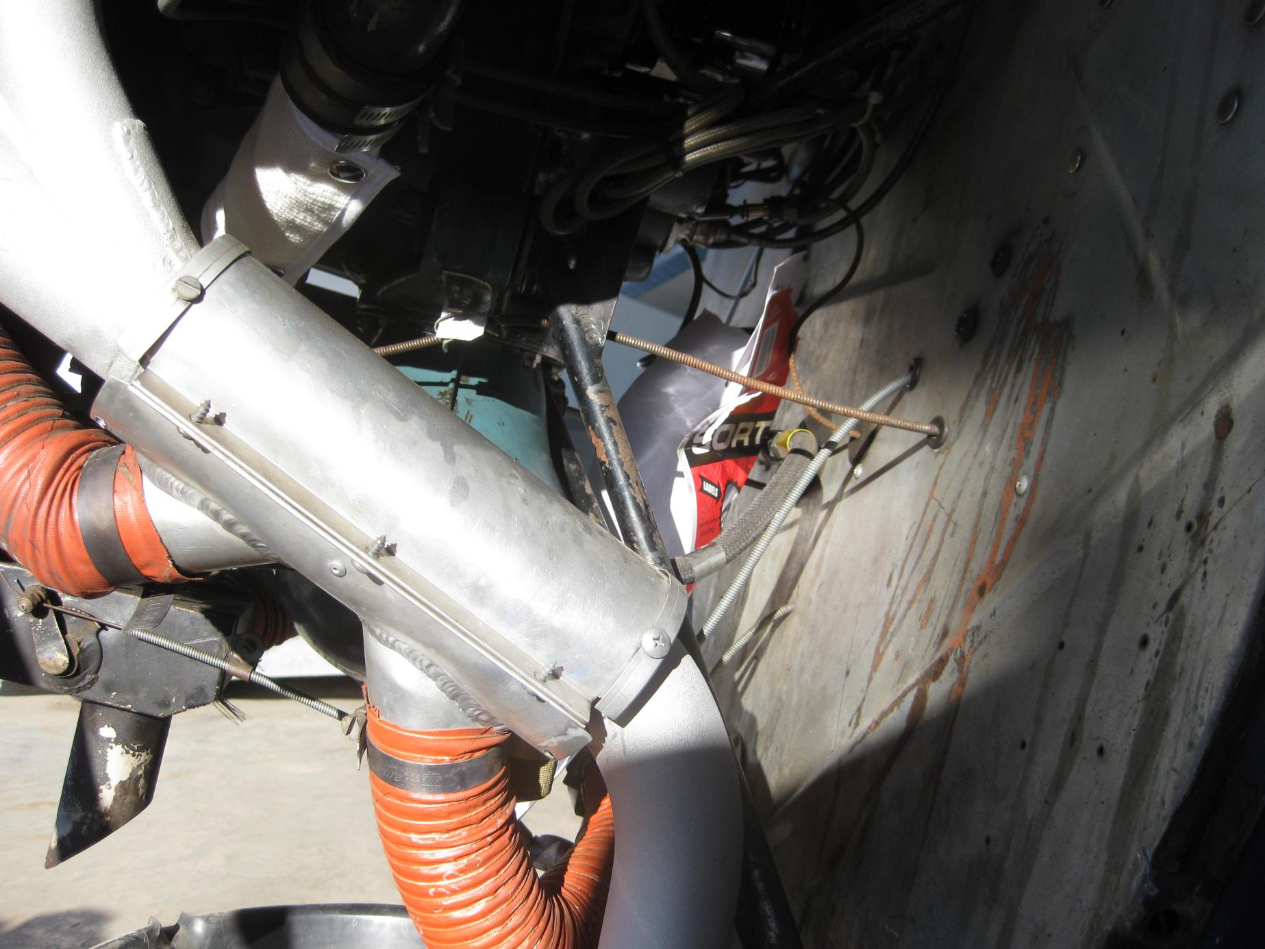

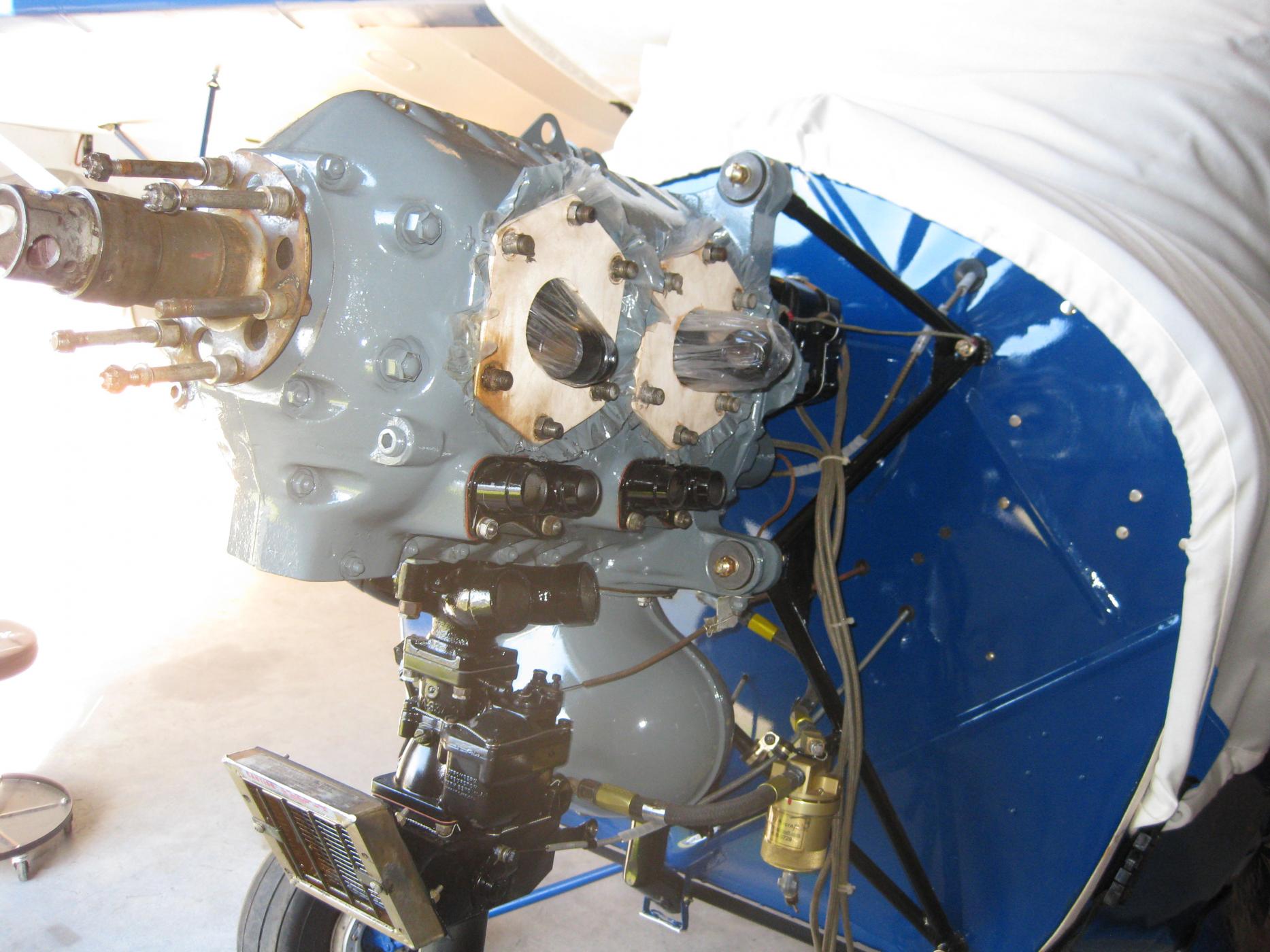

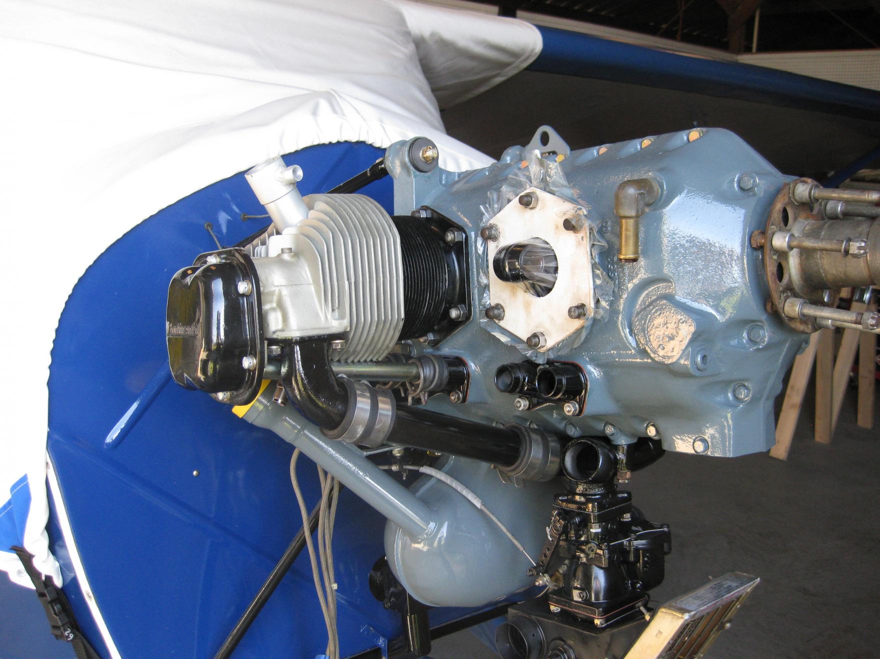

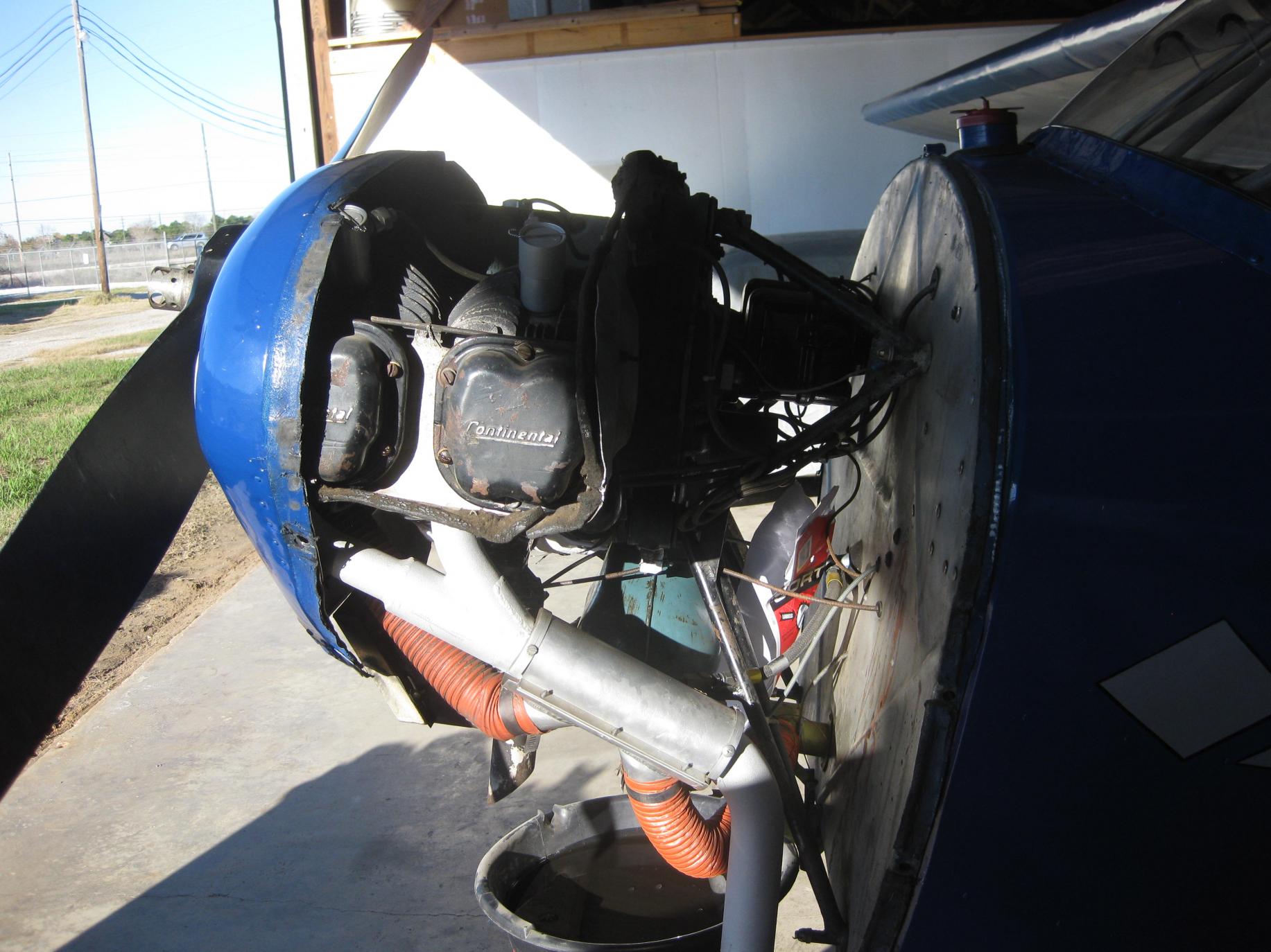

    Here are a few pictures of my Luscombe exhaust installation. I have an aftermarket gascolator but its still mounted to the engine mount. Let me know if you would like the information on the new gascolator. It is stc'd and is a really nice part. Hope this helps?

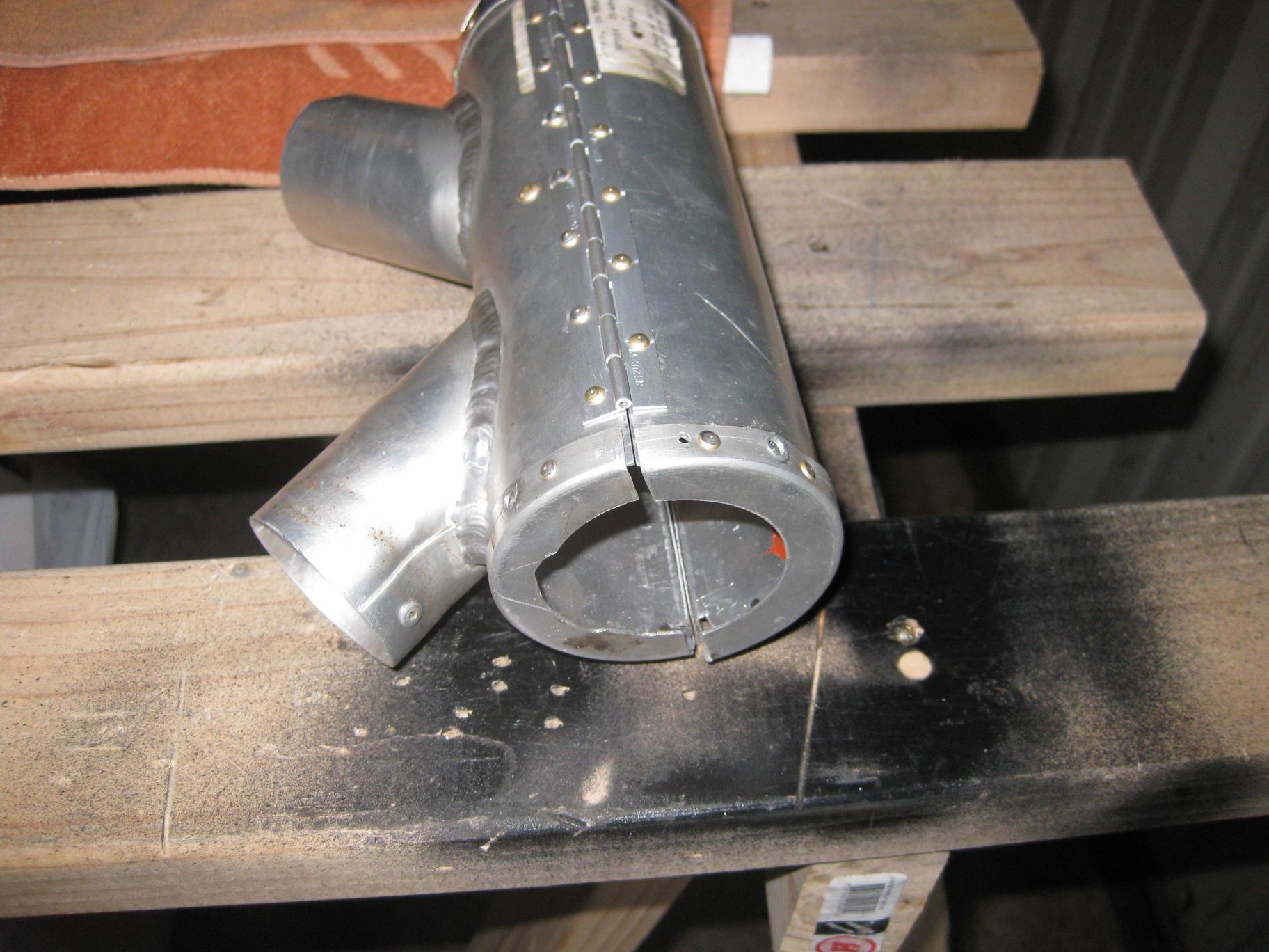

      Thanks Greg, I can instantly see why yours fit vs. mine. Your muff is oriented 90 degrees off from mine. The mounting tabs on the exhaust Doug built for me, are up and down like in this PDF.

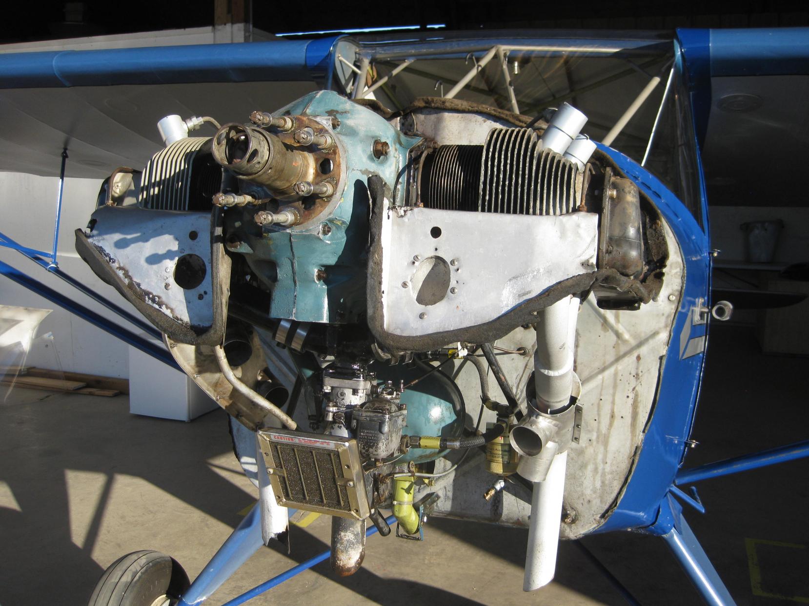

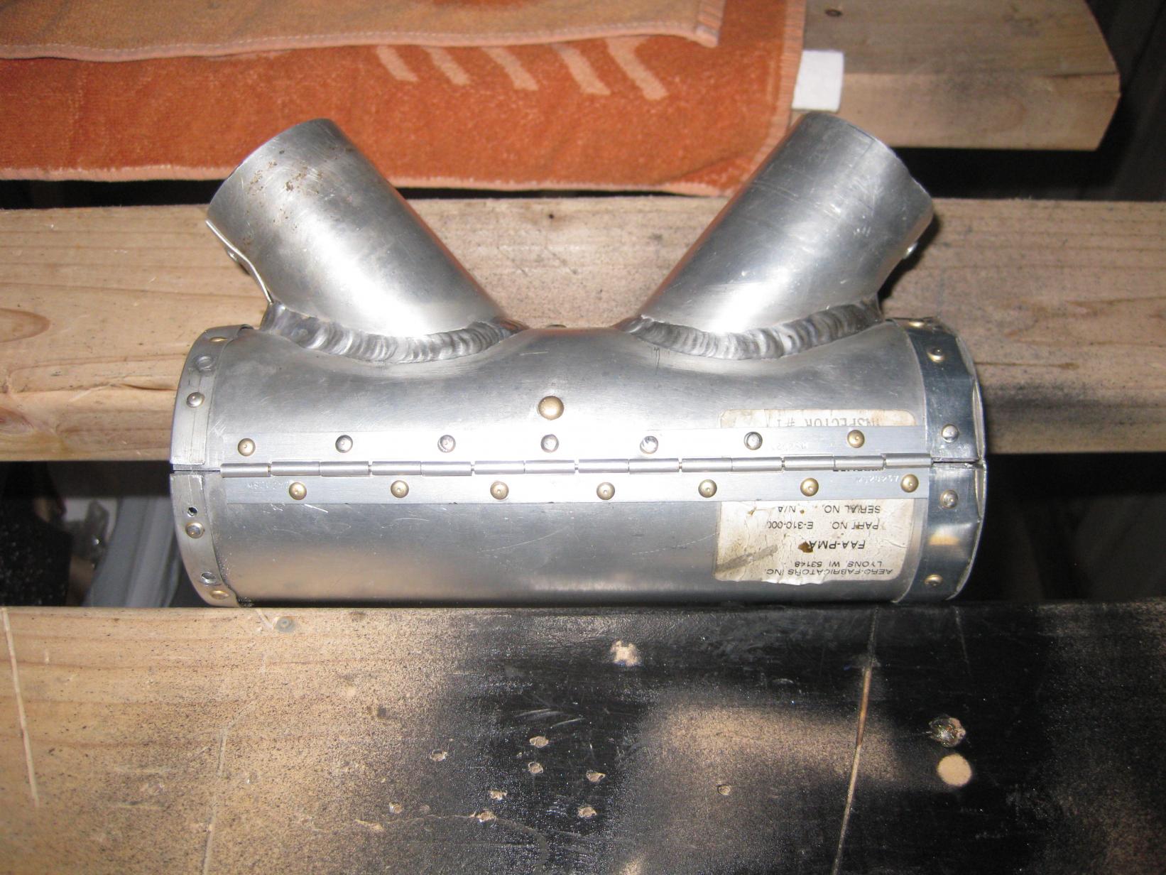

        My system came from Wag Aero. Here is a picture of the system without the muff installed. Perhaps you can modify yours to be the same? I like the system shown in the pdf you attached. Definitely a more sturdy installation. I actually replaced a few screws with several rivets to hold the end caps better on my cabin heat muff.

          That is a possibility, cutting my tabs off and rewelding them in the horizontal. I prefer to hold off for the time being on modifying a brand new part though.

            Perhaps just 'bend' the existing tabs to provide the same support as pictured on my installation? Just an idea?

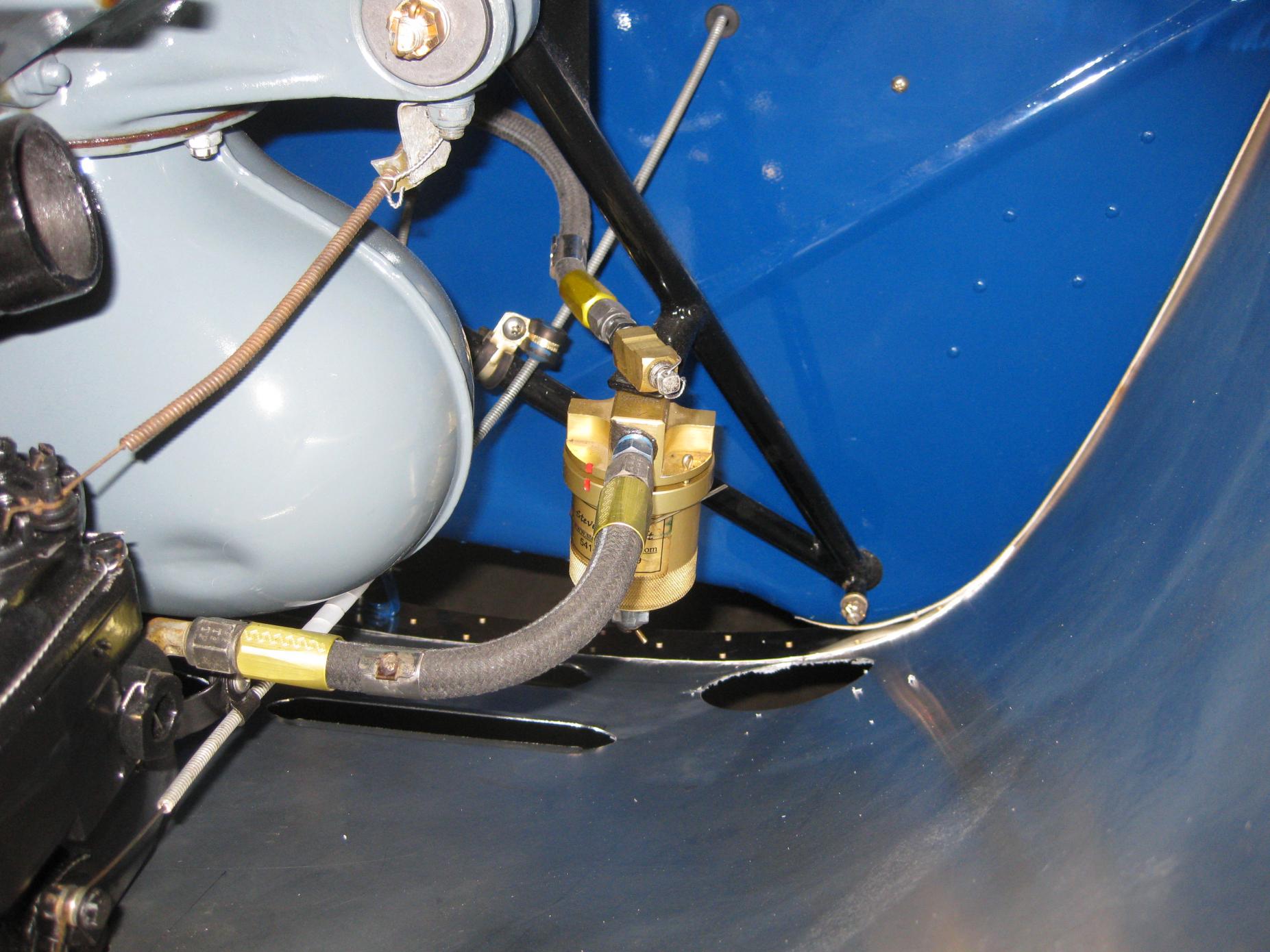

                Too heavy, I did one and moved the acs gascolator to the firewall. I installed it with rigid stainless line from the tank to the gascolator and then flex from the gascolator to the carb. Tim

                        Its built like a tank, overkill. I try to get the acs ones for less than 100. I consider what is an industry standard, gascolators have been around for a long time, so pick your poison, 250 for a gascolator, or 100 for a gascolator and 150 for gas. Tim

                              There isn't any comparison of the ACS gascolator to Steve's. I have used/maintained many types, but Steve's is by far the best.
