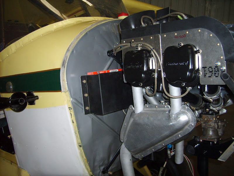

If I remember correctly the exhaust on an A65 exits the cowling on the co-pilots side of a taylorcraft. If you see a 46 Taylorcraft BC12-D A65 with what looks like the exhaust coming out of the pilots side what does that mean? Some type of aftermarket homemade flamboozal stuff?

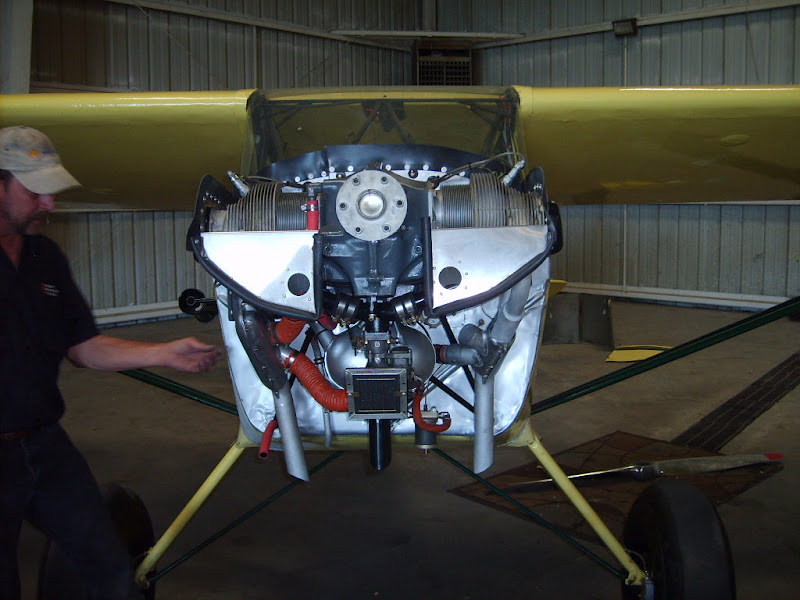

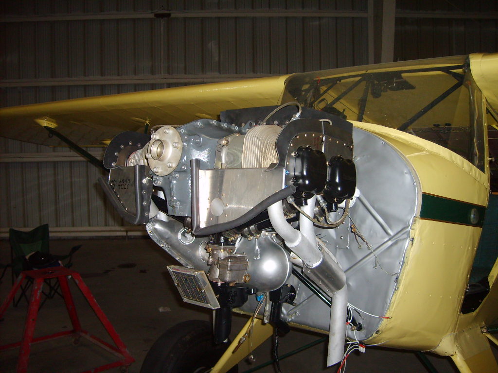

Many Taylorcrafts have been converted to Luscombe exhausts as they are simple and work well, unlike the taylorcraft exhaust which is prone to leaks and a pain in the a$$.Originally posted by Chris View PostNow Im really curious. I may have to call the guy. I'd be more interested if it wasn't in Massachusetts and winter!
Re: Exhaust
The luscombe exhaust not only sounds different and good it also makes more heat for the cabin and carb. The easy access to the accessory case. At annual time the inspection of them is a snap and if your cowl is for a lycoming 65 it has the holes all ready in it and the pipes exit in the existing holes.1940 BLT/BC65 N26658 SER#2000
