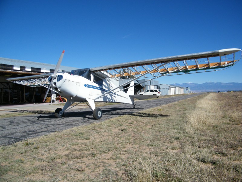

The new wings for N34237 are all together and ready for cover. Since these have new spars and everything was brought back to new condition to the best of my ability, I wanted to find those two or three (or four or five or...) paces where I got something a little off and I would have to start over. So after the A&P and the IA had blessed the wings as ready to cover, I hoisted them up onto my wing stands and bolted them all together. The root fittings slipped into the fuselage fittings nicely. The struts all fit. I pre-rigged the washout so that the struts are properly set and I hooked up the new aileron cables and wiggled all the moving parts. I still can't believe that I got it all fitting correctly!
My only problem is that it looks almost too good to cover.
