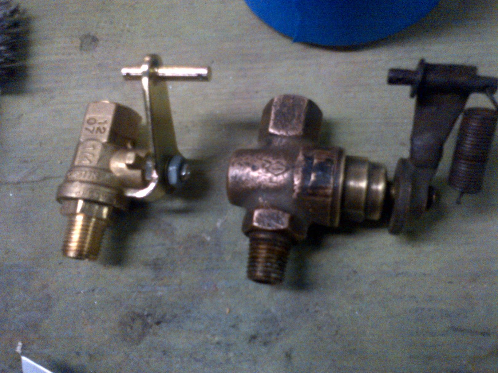

    Below is a picture of the new main fuel valve (along with my old one) that I got thanks to the efforts of Tim (astjp2) and Terry Bowden (barnstmr). I needed this as part of the upgrade to the C85.
    It fits perfectly.

    I am also impressed with Tim's attention to detail. Mine is very well made and I cannot wait to get it installed.

            Has any of the members had any header fuel valves that were so tight they would not operate?? without major amounts of force?? brass to brass old and very sticky
            JS
              Re: New Fuel Valve
              Yes, and also leaked. It will tear out the bottom of the take if you keep forcing it. Then you will need to get the tank fixed also at a good radiator shop, they have the tools and solder to repair tern plate or the welders to do thin aluminum, depending on what tank you have. My tank now has a build up of solder over 1/4" thick where the valve screws in. If you are removing the elbow and it wont come out, also take it to the radiator shop and get them to remove it, they can remove the gas vapors and gently heat it so it will come out. You need an old school radiator repair shop to do this and tell them its a tractor tank from the 40's or something or they may not want to work on it. Tim
                Re: New Fuel Valve
                JS,
                Very typical, some folks will disassemble, clean, lap and lightly lube with Fuel Lube. However, be extremely careful about the lube part. I believe a small piece of Fuel Lube, which does not dissolve in fuel, broke away and got into my carb. It blocked the smaller orifice and caused the engine to die on final. My valve moves but with difficulty. It has been suggested to reach down and assist the handle open or closed by hand while using the knob or rod. As Tim pointed out, you can damage the tank if forced. This is the reason I am going with the new fuel valve Tim just made and be done with this difficult to operate and leaky 67 year old valve. My opinion is there are 12 gallons of fuel sitting in your lap and I want a good, safe, easy to operate fuel valve.

                        A local hardware store had valves that looked EXACTLY like the ones in the above photos. Brass with a SS ball and square output shaft. It would take about 5 minutes to file a lever from a piece of brass. Of course the whole assembly would be totally illegal.
