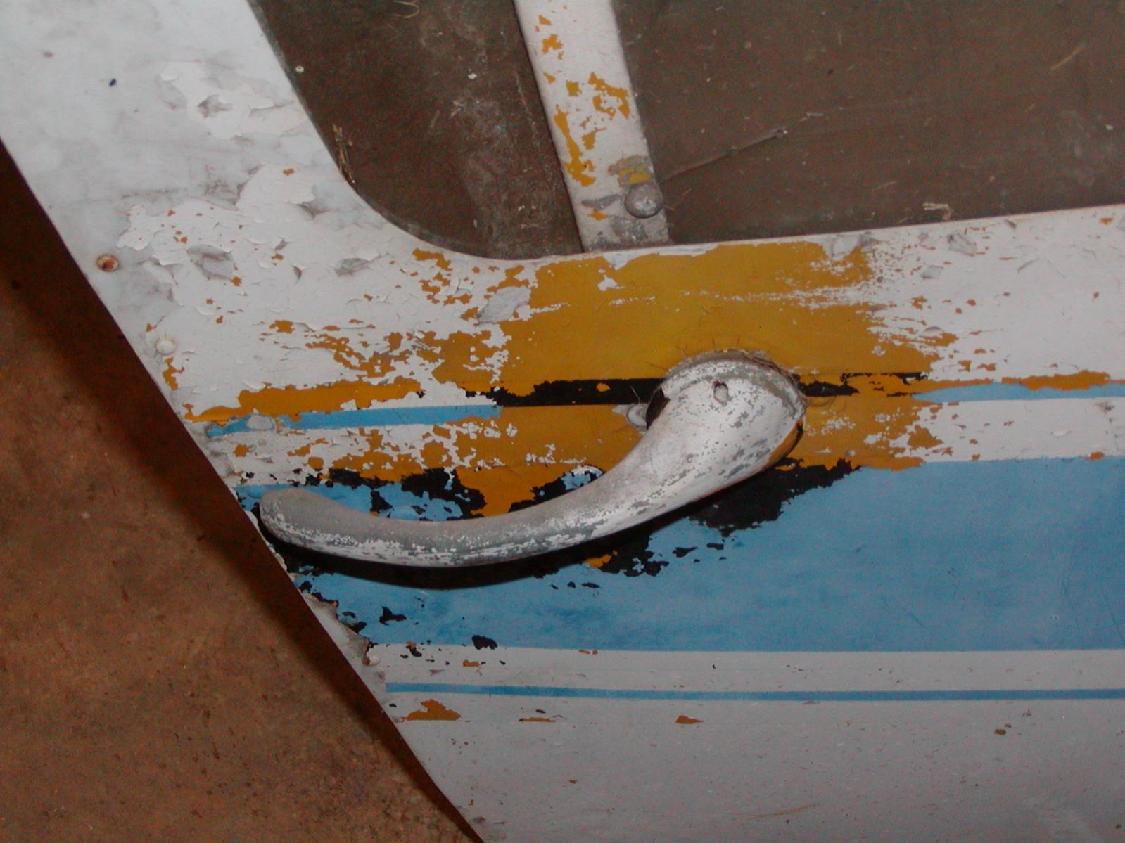

          Re: door handles
          Which door handle type? Inside or outside? There are at least 5 or 6 different shaped ones. I have samples of several different ones we could use to make copies in either Epoxy or Polyester Resin. Unfortunately my 41 had and external one with a stamped sheet metal skin over it that wouldn't cast very well. The 45 is a tear drop bullet shaped one that should work pretty well and the straight cast interior ones are pretty simple too.
          A Bondo one probably won't stand up very well since it is pretty soft resin with low strength, but there are some resins out there that are really tough and might even be stronger than the originals.
          How about posting a photo of the one you want?

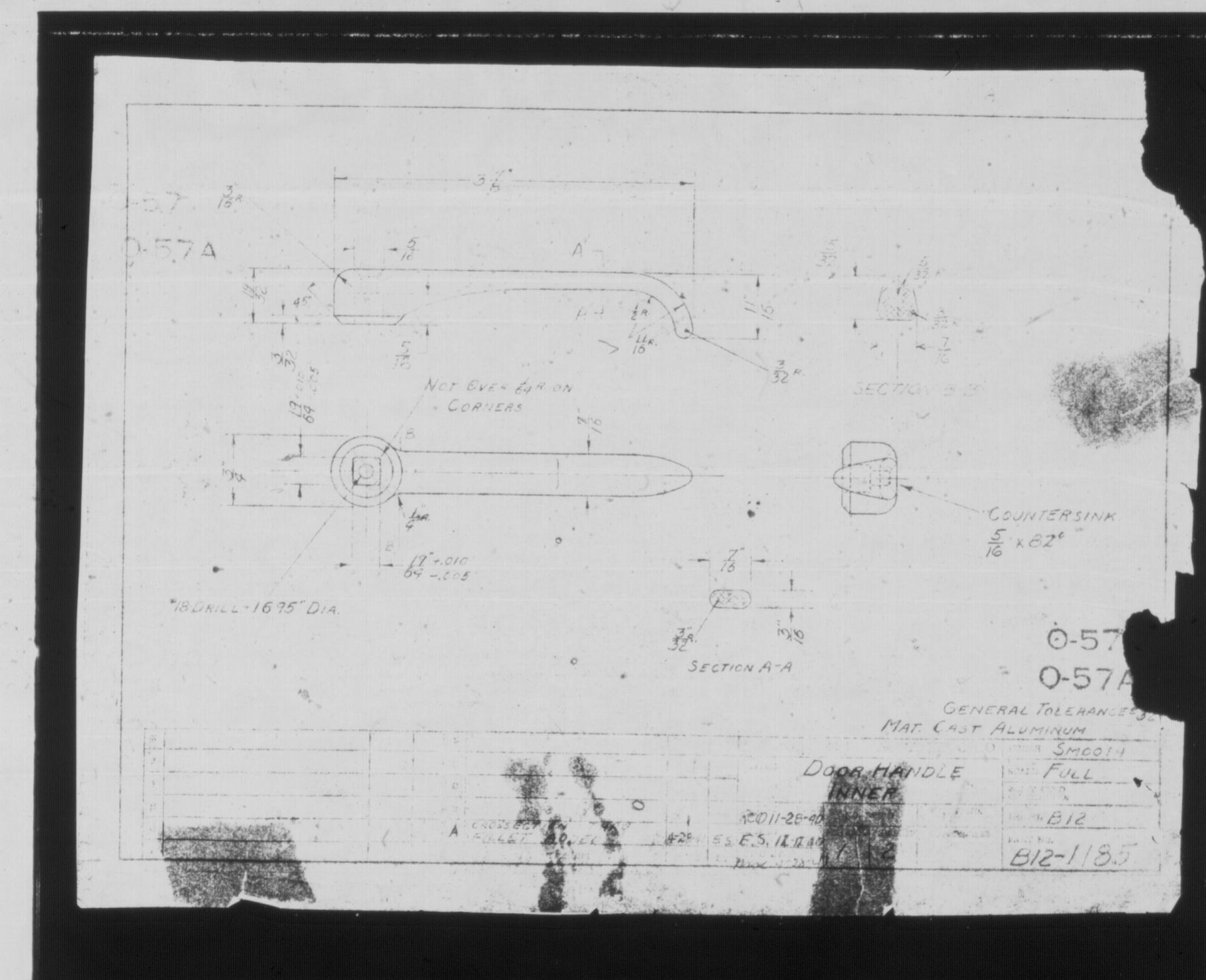

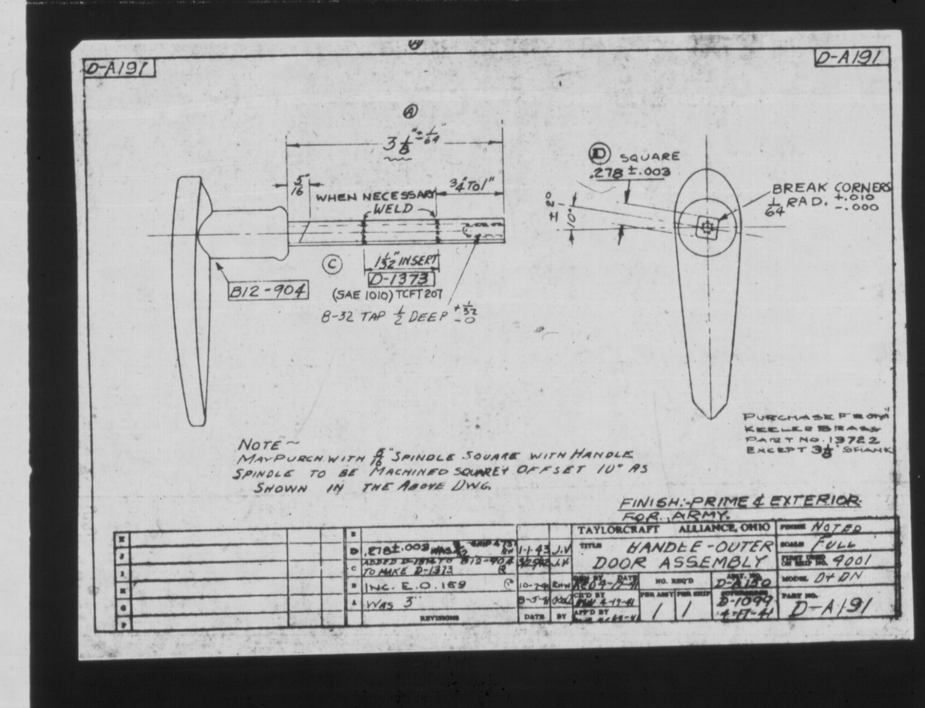

                Re: door handles
                The first drawing is of the inner 41 handle, the second drawing is of the outer handle that I need for my 41. The inner was pretty common before the war and would be easy to cast. Since the outer one is clad in stamped sheet metal it isn't really a good candidate for making a cast one. The inner would work just fine. If anyone has one of the outer ones let me know.
                I have photos on this computer of the outer and inner 46 handles (they are the same) but this computer doesn't have the software to reduce the size for email (my regular computer hard drive failed day before yesterday). The photos of the 46 handles are on another post from me somewhere here. They are the ones I have several of but can't get them of the doors without destroying them. I have one of the 46 handles I kept to make cast ones, it just hasn't been a priority project.
                I am sure I can cast them but would need to know how many people want and what they are worth. The casting SI is REALLY EXPENSIVE and will cost too much to only make a couple.

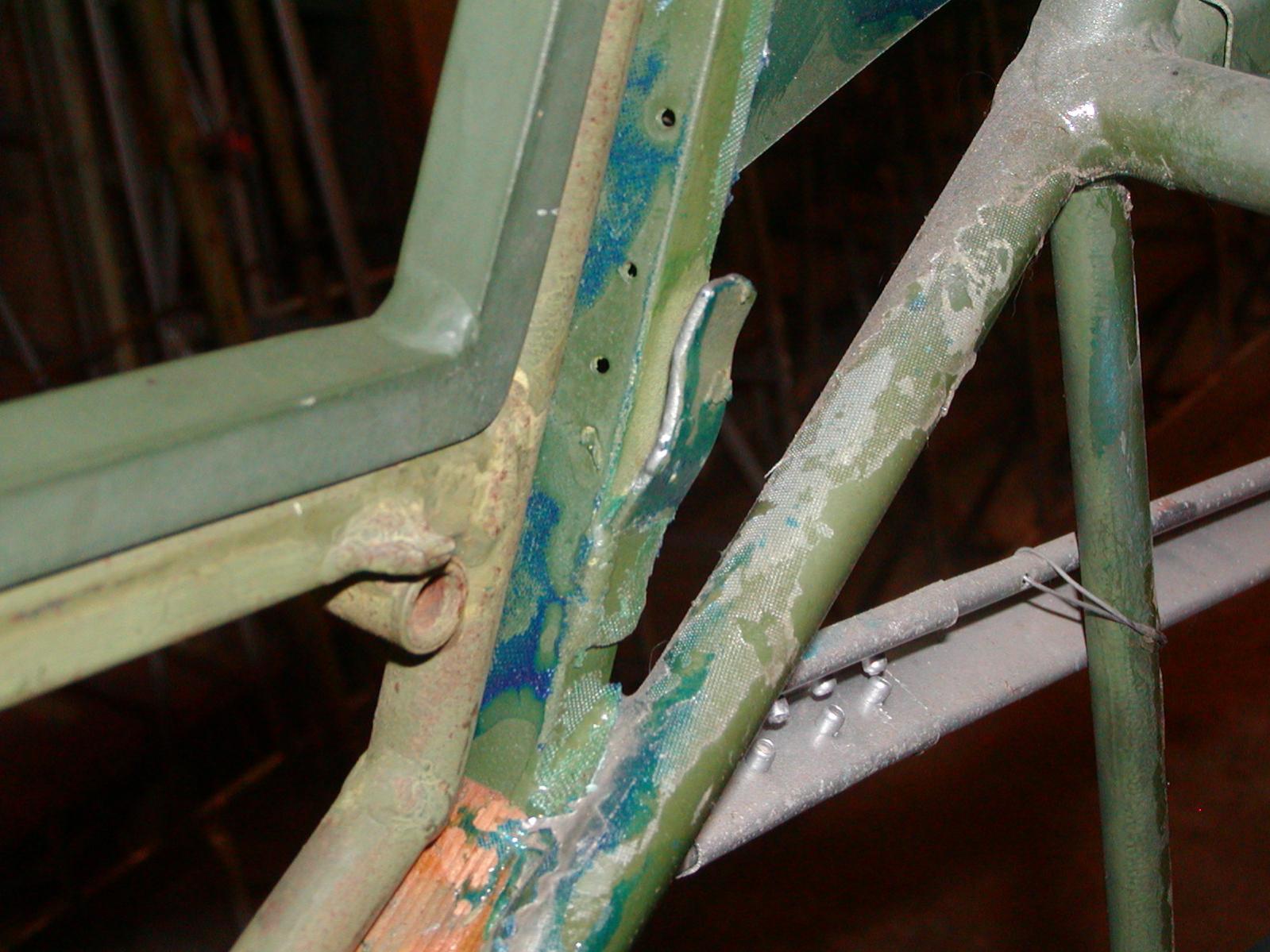

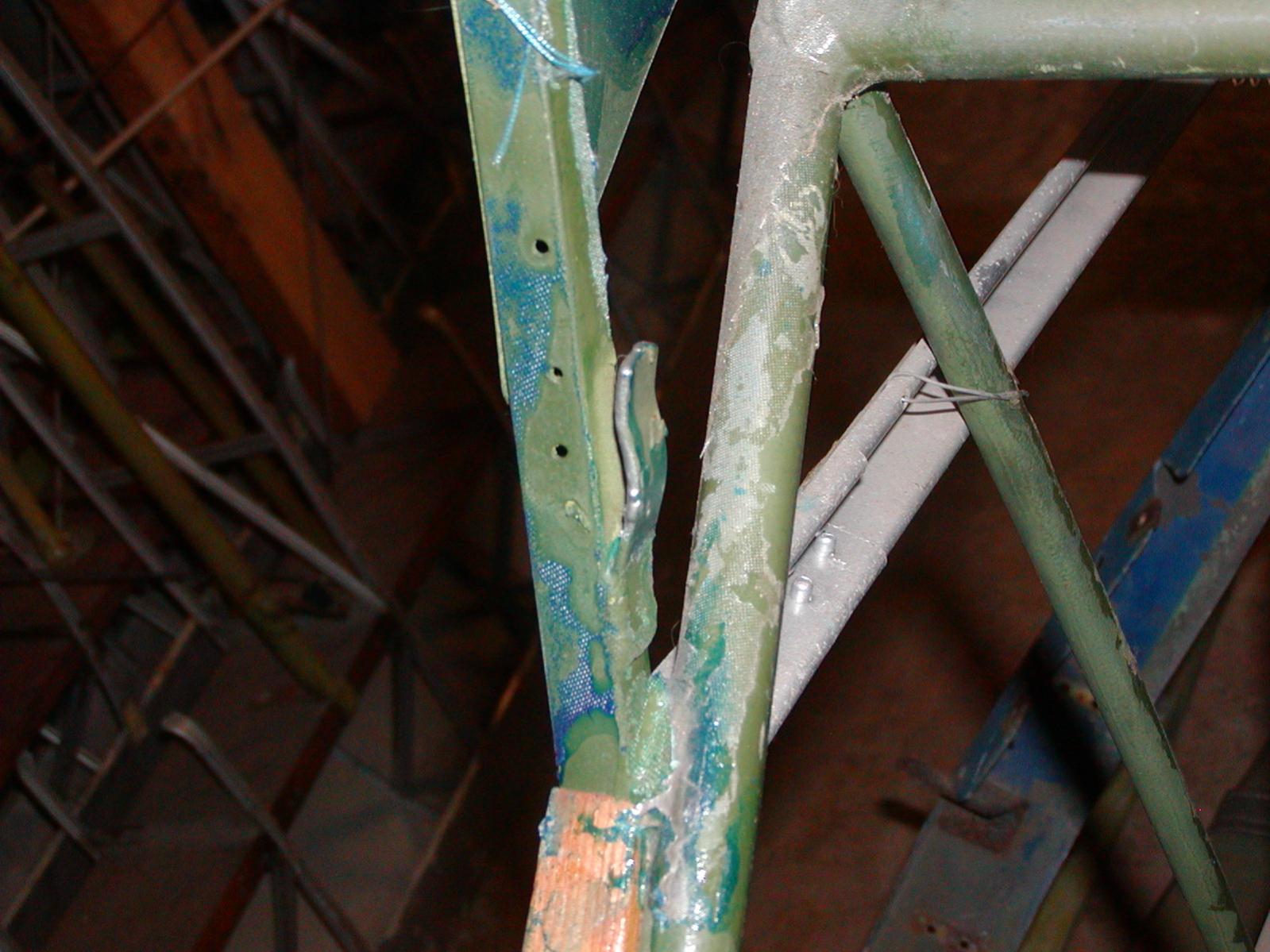

                          The pre war airplanes with the tube type doors use a different handle than what Hank posted. The handle has stamped front and back shells, a cone shaped spacer, and a stainless mounting plate with 2 screw holes. The handle has a square shaft that goes through the tube in the door, and is threaded on the end for a plated accorn nut. The inside handle is bent from a strap of steel with a square hole to go over the shaft. There should be a small tab welded on the inside of the door frame for it to ride in. I'll try to get some pictures of a door with the handles installed when I can get the camera from the wife. Tom
                            Re: door handles
                            My project, but also 1 picture of some bc12 doors that I have (not included in project but I do have both doors and frames and yes I know I would have to move some square tubing around to make them fit
                              Re: door handles
                              The handle in the second drawing is a pre-war "Deluxe" exterior handle for a wood door. The welded metal tab on the frame and bent flat handle inside is what was used on my 45. It is simple, inexpensive and functional. The outside handle on my 45 is the cast tear drop handle.
