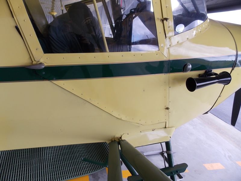

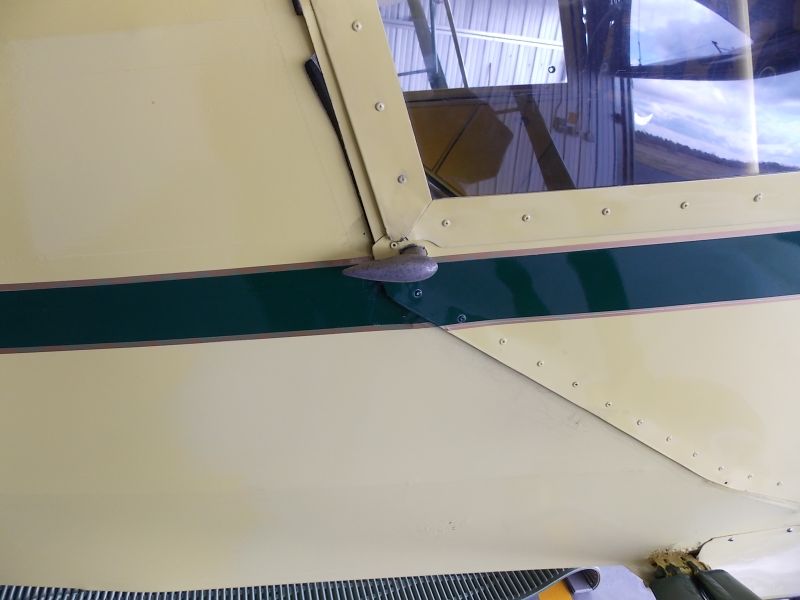

    I would really like to see some pictures for the pre war door handle and latch area like what I posted if possible. On another note-has anyone changed the prewar doors to the bc12 doors and what thoughts are there on this aspect-I mean I have them and I would have to change the top-bottom and latch area square tubes for door mounting and relocate the rear windows but no structial fuselage members.

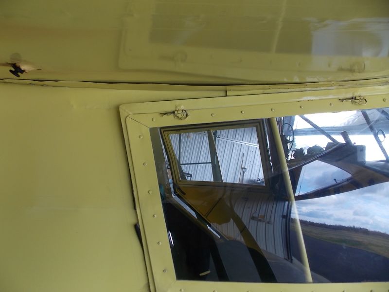

      Bird here are some pix of the handles on 26658 the one of the inside latch is not as clear as it could be they work fine and there is nothing to go wrong with them

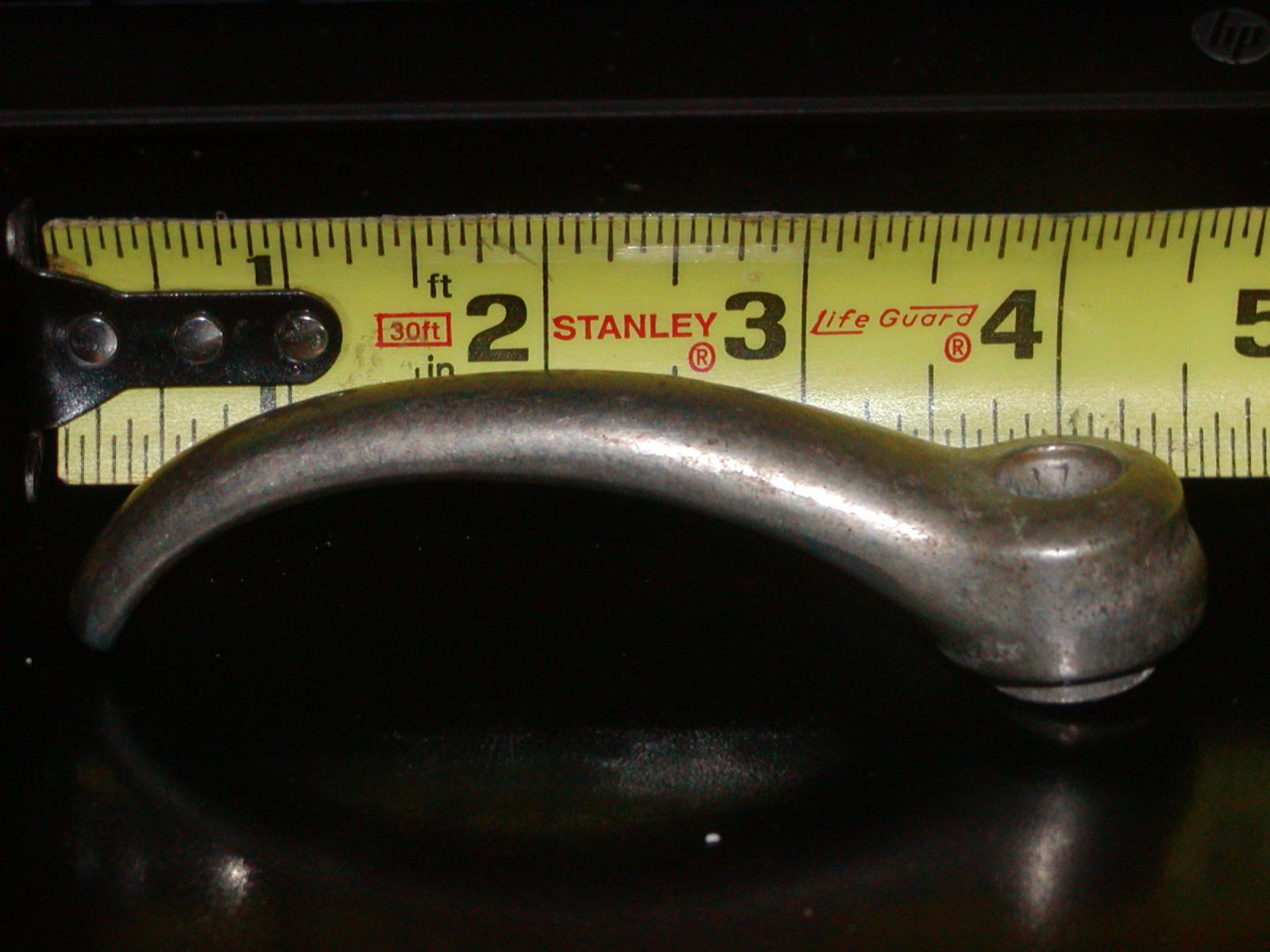

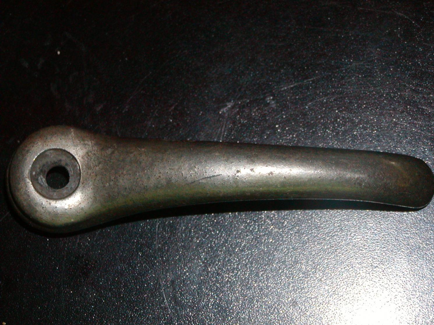

            Received my 1926 Chevy door handles today, they weigh 4.6 oz each and I think I will have them powdercoated chrome (cheaper-easier-faster and almost as durable)
