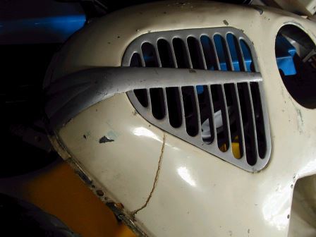

    The nose cowl of my F21 is getting a little old and cracked. Are there new ones available? Are they specific to Tcrafts or did the use a more standard nose cowl on these later models?
    Re: F21/22
    The Lycoming Nose bowls are pretty rare, you will have to probably get it welded and then do some good body work. Most of the nosebowls are 3003 alloy, it is malleable and weldable. Tim
      Re: F21/22
      Find someone who is well versed in welding THIN aluminum. I found a welding shop that said they could weld aluminum. They were used to welding 1/4" material and kept burning holes in the thin metal. They finally got the hang of it, but my nosebowl has nasty scars on the inside where they learned how to weld again. If I had it to do all over again, I would find someone with Aeronautical welding experience. When they finished they said they were ONLY charging me $100. It only took them a little over an hour to do it. I would have paid double that to have it done correctly. Owning a quality TIG welder is one of the items on my bucket list. I could have done better with my MIG welder and a spool gun.

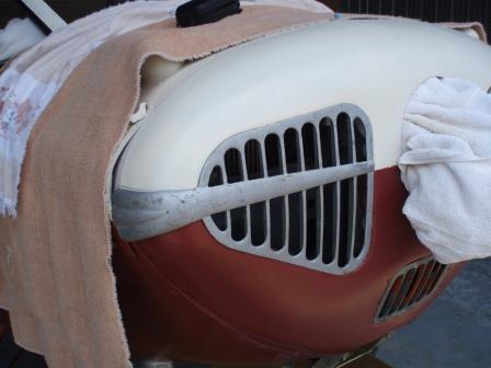

          Or go to a classic car shop, they are used to this thin stuff. I had them make me a new nosebowl (admittedly for my 46 BC12D) and they did a lovely job.
          Any shop that deals with aluminium-bodied cars might do you a repair at less than you could get a new one.
          (In the photo below, I supplied the grilles for them to work around. Five pieces welded together...it was a shame to paint it.)

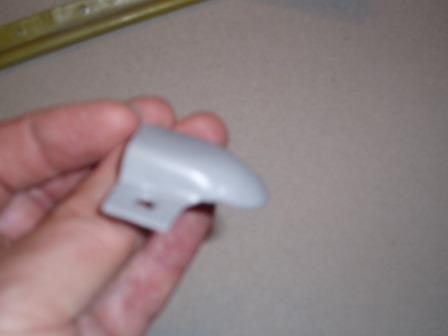

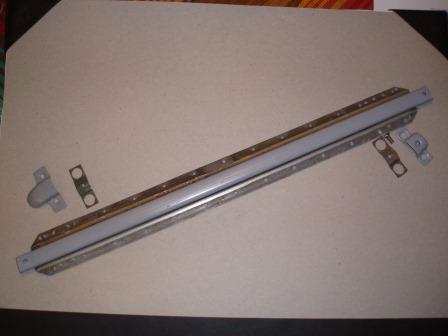

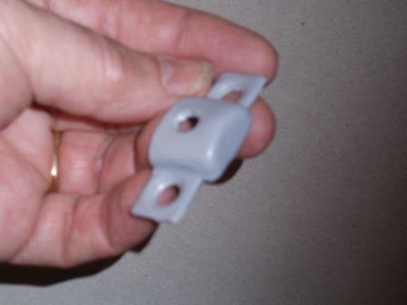

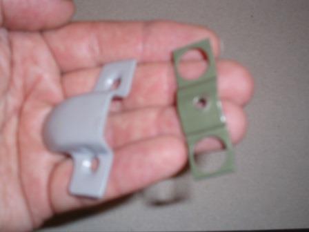

            I taught myself to weld aluminum (not true welding, I used LumaWeld which is more like torch soldering). It takes a LOT of practice, but while I was good at it I could weld together two pieces of Coke can and get a reasonable bead. If you strapped a piece of Stainless across one side it would be reasonably flat with the bead on the inside. I used the process to make the end fairings for the top cowl hinge. Once yo can weld a Coke can the metal for the end pieces was a snap.

                  This is the nose bowl before and after.
                    Re: F21/22
                    I don't know what you paid for that nose bowl, but it HAD to be less than the labor (labour for Robert) that I put into mine! Would they be interested in making more? Knowing what you are doing can cut the time to do it to a fraction! That thing is BEAUTIFUL! I spent MONTHS tapping on mine. The neighbors HATED me!

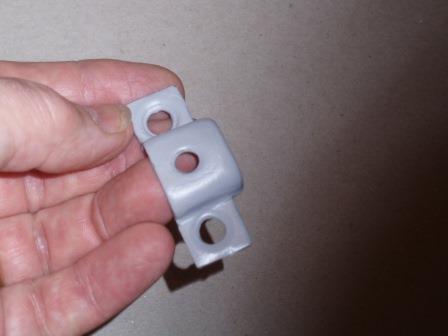

                        Cowl hinge ends: I made mine out of steel (see pic below). Much more robust.

                            My F21 cowl is aluminum with lots of cracks. I was looking for a source for new. I use this user name on other AC forums so why change. I back flying low and slow after 50 plus years flying the other stuff.
