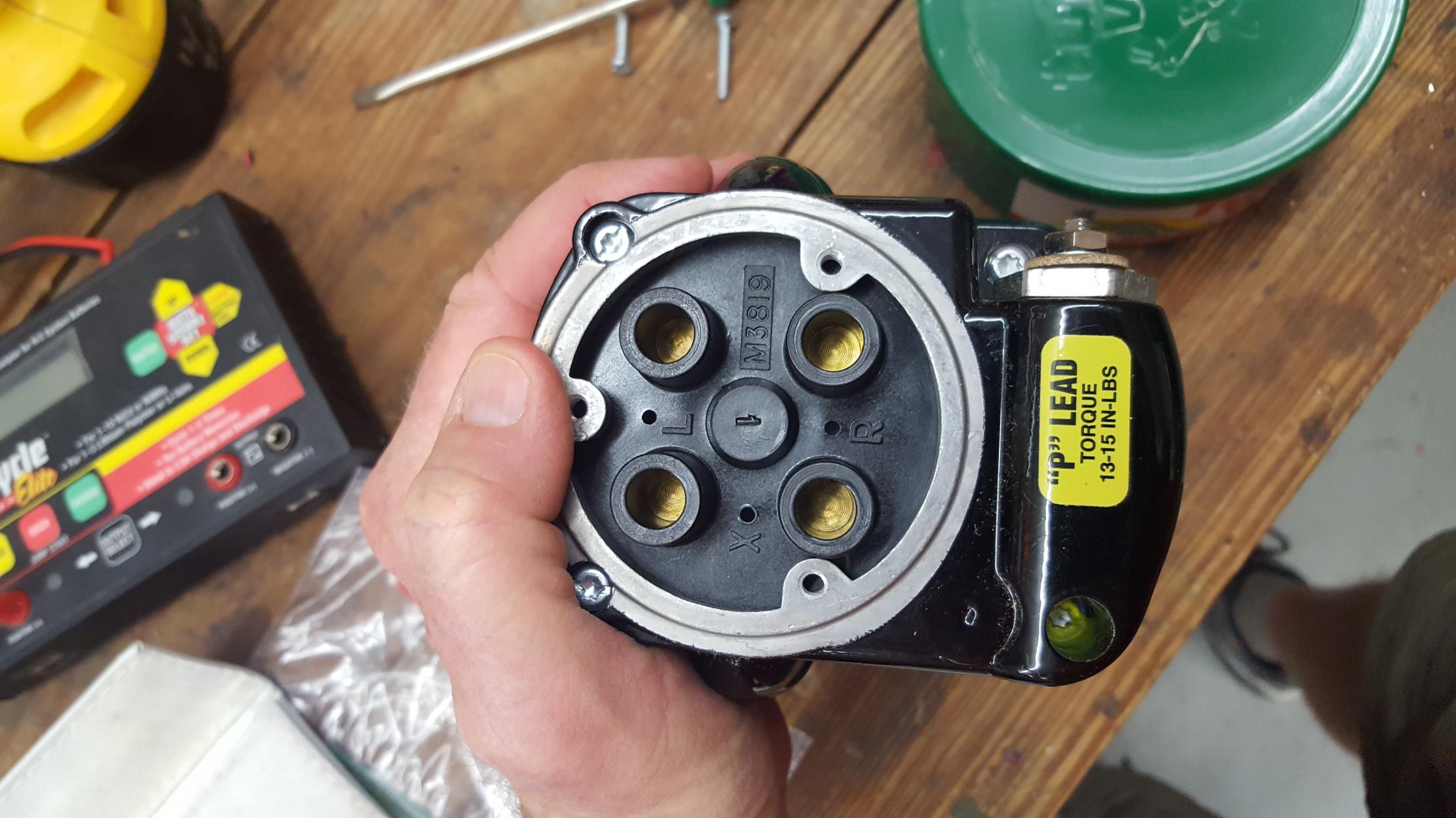

            So I have the cigar ends (AN661) for the spark plugs and will install them on regular spark plug wire.
            However, What about the magneto end of the wire?
            The new mags (see photo) are expecting the spring connector from the new harness.
            Not sure about that end. Any advice is appreciated!
            Thanks! Jay
            • #36
              Re: Unshielded ignition ends
              You will need to get someone to install them onto a slick càp
