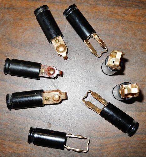

    I got a call from one of the Tribe who is looking for the cigarettes from unshielded ignition leads. Several places can supply the end piece that goes into the Mag and the wires are pretty easy to get, but we are having trouble getting the piece that actually attaches to the end of the spark plug.
    If anyone has any old plug leads for unshielded plugs, or knows a source for the end fittings please drop me a PM. There are a bunch of us who would really like to get rid of the bumps on the top cowls of our planes.

        I got a set of eight NOS off ebay a few years ago.

                Hi guys,
                Unshielded igntion ends are AN661. Yours can found in Aircraft Spruce or Wicks.-

                        Re: Unshielded ignition ends
                        there were some on ebay for $3.25 apiece listed as Vintage new old stock Non shielded magneto terminal ends, just picked up 8 myself
