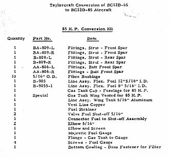

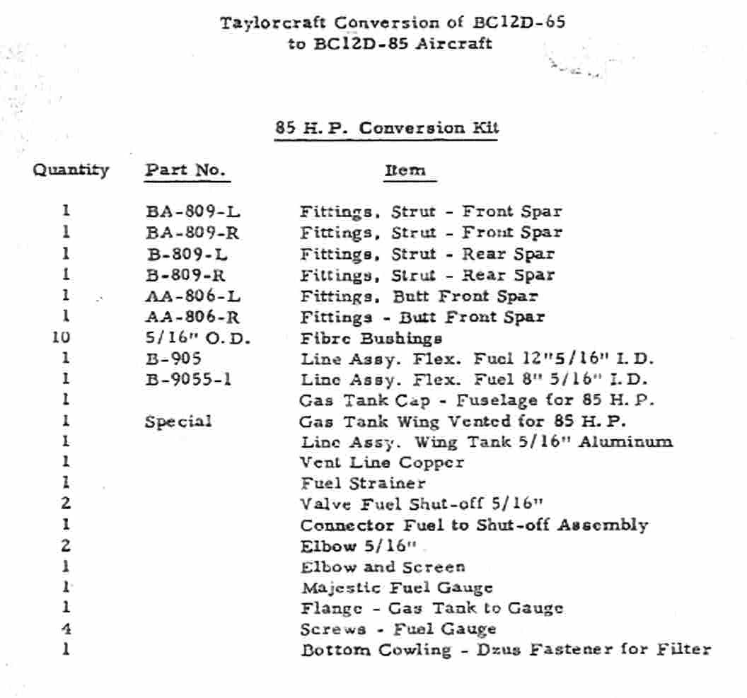

                    Yes I should have a look at mine tomorrow for a part number. There's two round gauges...one for C-85 (Model 19?) and F-19 and Taylorcraft P/N's but that's worthless. Rochester might know. It looks like a gauge for a boat or truck bed tank that can be read from the side not the top. I have Gilberti paperwork when he was at the factory that describes the round gauge. The factory offered the C-85 and G/W with fuel mods before he developed the STC SA1-210. It's called a "Majestic Fuel Gauge" #BA38-1 on his drawings.

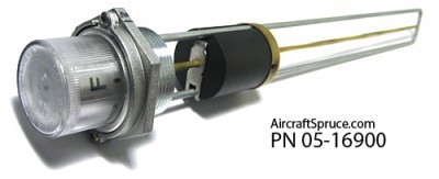

                      Bingo. Not sure of the length but measure the tank depth. Have the threaded adapter collar and ring assembly welded to the tank:
                      https://www.aircraftspruce.com/catal...yABEgJHZvD_BwE
                      Click image for larger version  Name:	05-16900.jpg Views:	0 Size:	13.7 KB ID:	187247
                        I wonder who makes them?
                          A call to ACS would be the best way to discover the manufacturer. They have to be placed inside the cockpit and clear the windshield. The height of the welded collar would affect that placement as well.
                          I'll look at mine for a manufacturer's name on the plastic cover.
                            A lot of Pitts aircraft use these too, or something very similar. I have seen them on the S-2. A call to Aviat may therefore help.

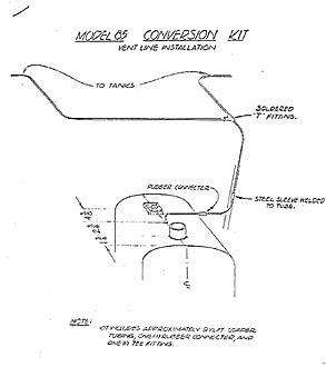

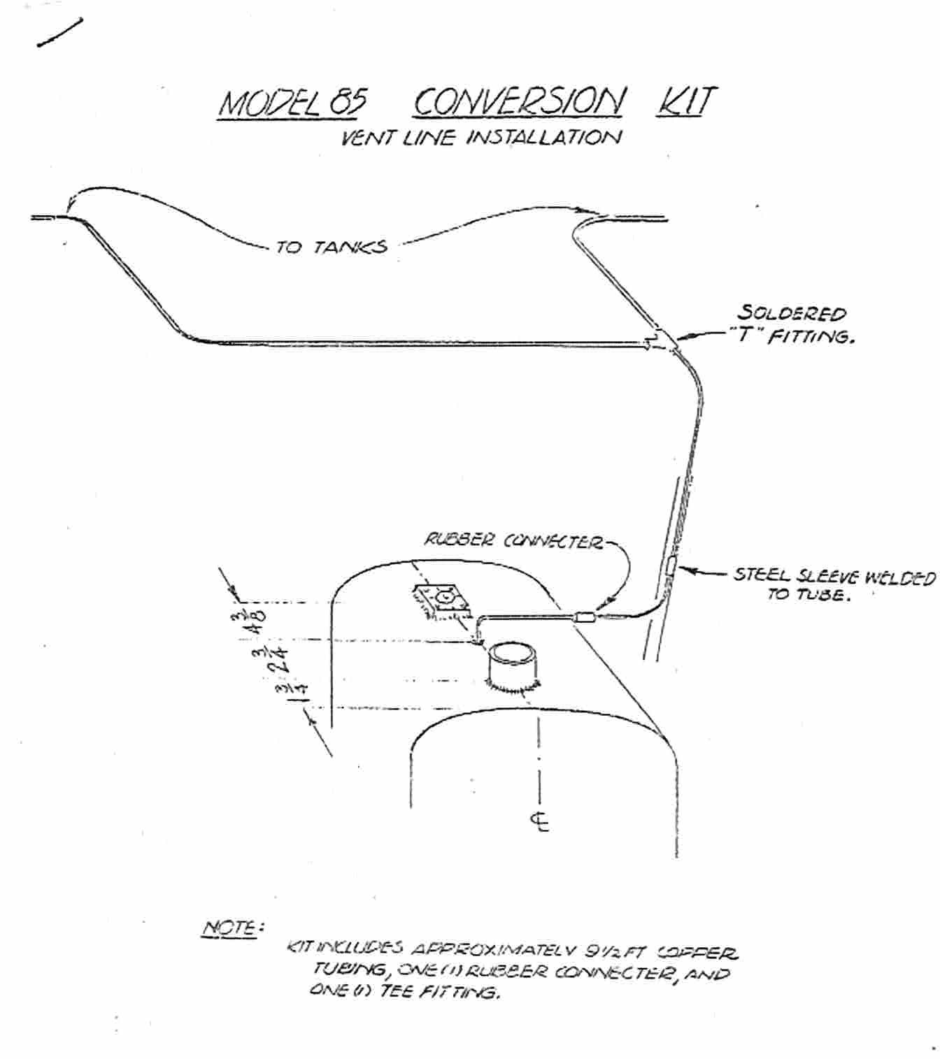

                              As far as I know this precedes STC SA1-210 and was from the factory.
