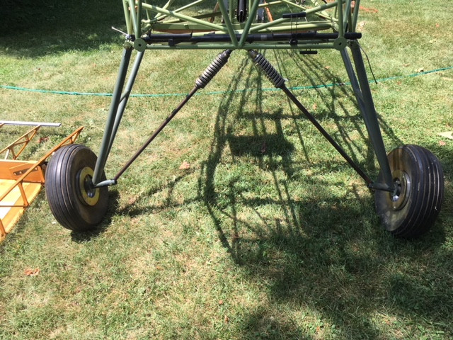

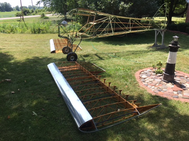

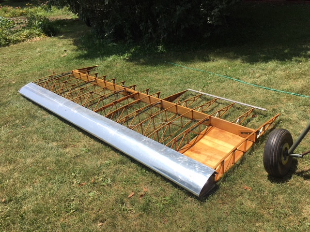

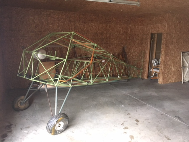

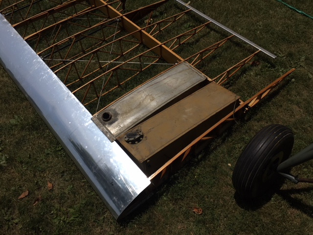

                          Here are a few pictures of the fuselage and wings, minus the new struts. Completely getting away from the door build, but here's some of my project. Everything is new, including the fuselage and struts, which is all in chromoly. I was told the builder was going to use an original fuselage but decided not to, due to the FAA, so everything is new and I have some pictures documenting the build process. Another club member said that the wings were made for Cessna fuel tanks but the auction included two Taylorcraft tanks. The builder had built many aircraft prior to this and was the local EAA go to person that you would have your work checked off by. As you can also see, the landing gear is modeled after a Hatz. I believe it has been used before on another well known build.
                            Do you have a larger version of the last photo? Really bad "T" Storms here today so I don't know if I can get out to the hangar but still want to inventory the doors there.
                              The fuselage looks to be configured for the P section type door.
