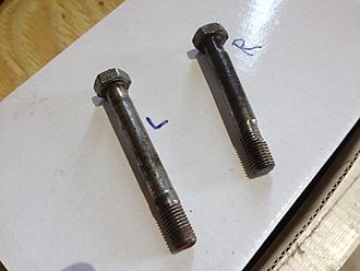

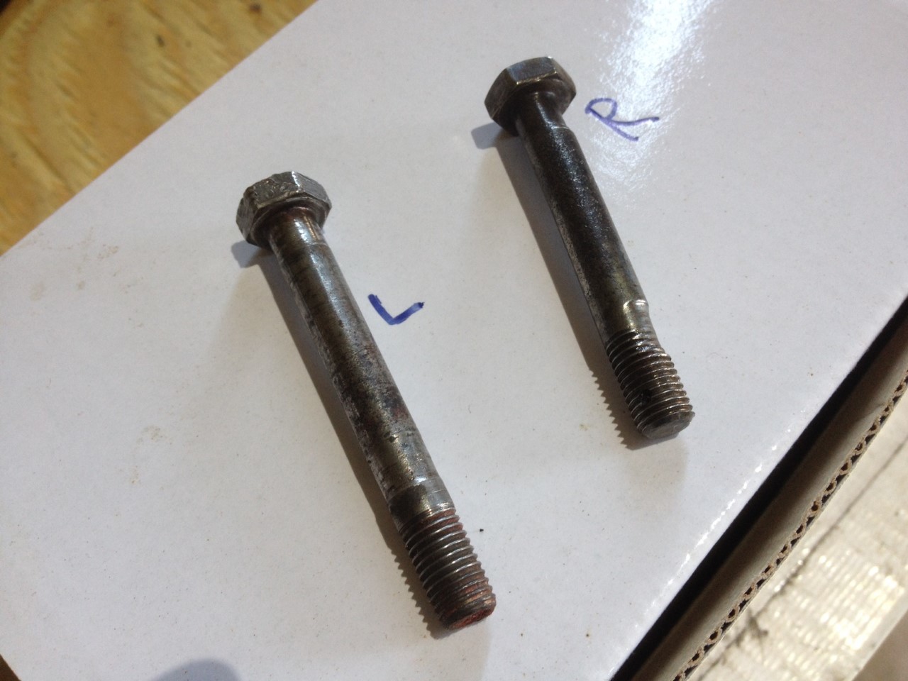

                            • #44
Name:	main gear fitting bolts, rear.jpg
ID:	184960After having new tie struts welded in I put the gear back on the plane a while ago. Thought I'd replace the bushings and bolts too, even though there's a good quarter inch of steel left on the old bolts ;-)
                              • #45
                                This is the issue with mechanics who don't really know the airplane. If the airplane had been hoisted to check the gear the bolts or bushings would have never went this far. I replaced bushings and bolts one one this year that the screw for the oil reservoir was covered with fabric, and it had been that way for 40 years. One of the upper bushings was completely gone, nothing to drive out. I could tell there were issues when the fellow who was propping the airplane tested the brakes.
