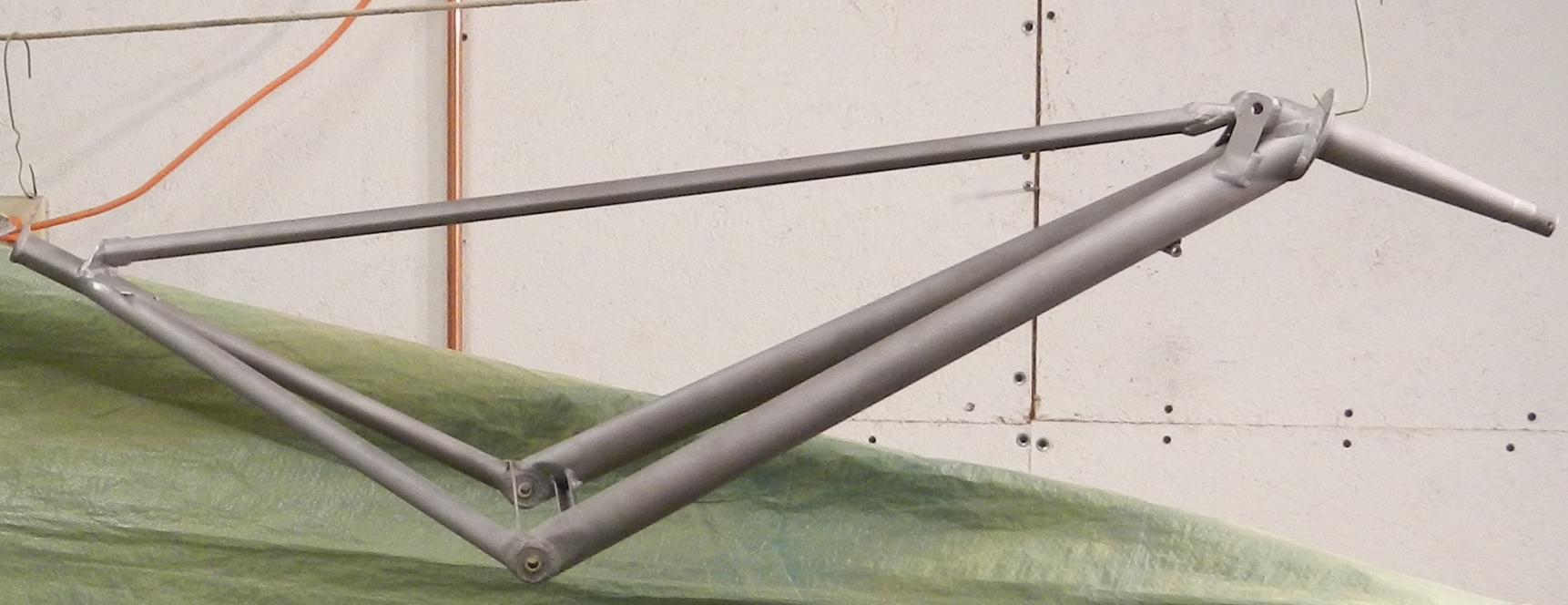

ID:	182533 I can't see why the tie strut can't be repaired or replaced without a jig. The gear is rigid in every direction as long as the rest of the structure is not disturbed,
              Appears to me to be relatively straightforward to cut the top end, duplicate and tack the tie strut on the bench, fit it in place, before final welding. Am I missing something?
              Is it a standard size streamlined tube?

                      We'll remove and replace the tie strut, maybe remove and replace the other side as well.
                        Who is going to do the welding?
                          My IA is talking with welders he's used in the past, relatively local.
                            Are you going to buy stream lined tubing and build a tie strut or purchase one from Univair ? Would it be hard to fabricate the lower bracket that attaches to the wheel assembly, ?
                              Univair remains an option, but replacing just the streamlined tie strut is what we intend to do.

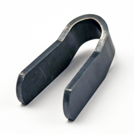

                              Wag stocks the lower strap https://www.wagaero.com/taylorcraft-metal-strap.html
                                Is that for the tie strut or the a111 fitting?
