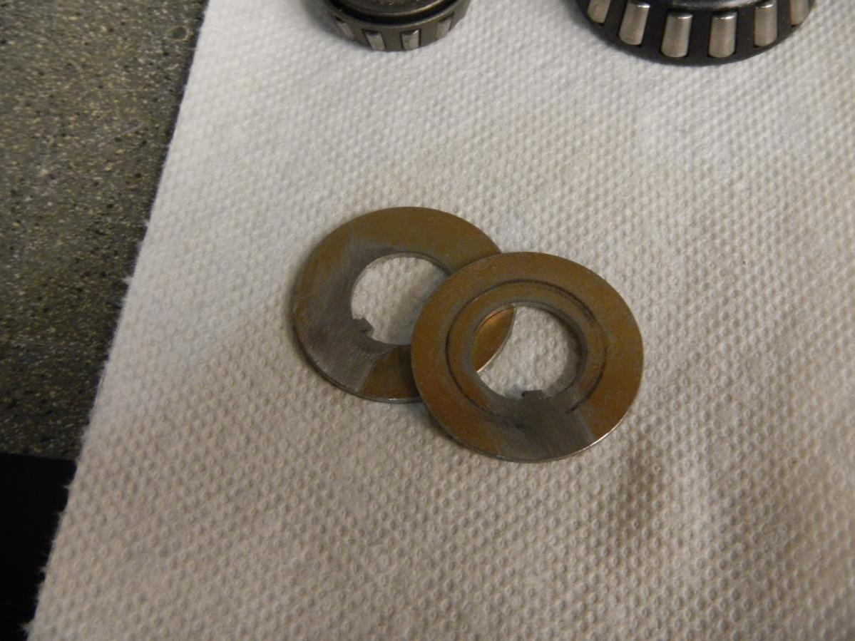

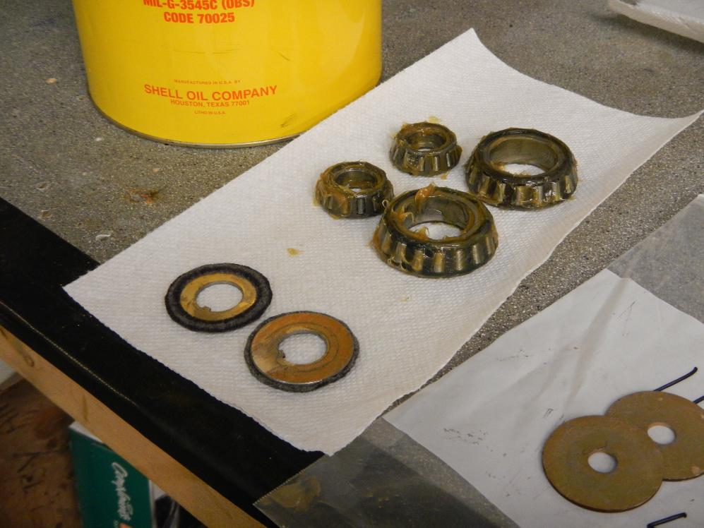

                              I bought some from a tractor supplier but they turned out to be too thick. In the end I welded a tab into a couple of AN970-10 washers as shown in the photo. Another option is to use a smaller ID AN970 and open the hole by hand file, leaving the tab. AN970 washer is about .063". The larger OD acts as a dust shield over the bearing and you can attach felt which turns it into an effective grease seal.
