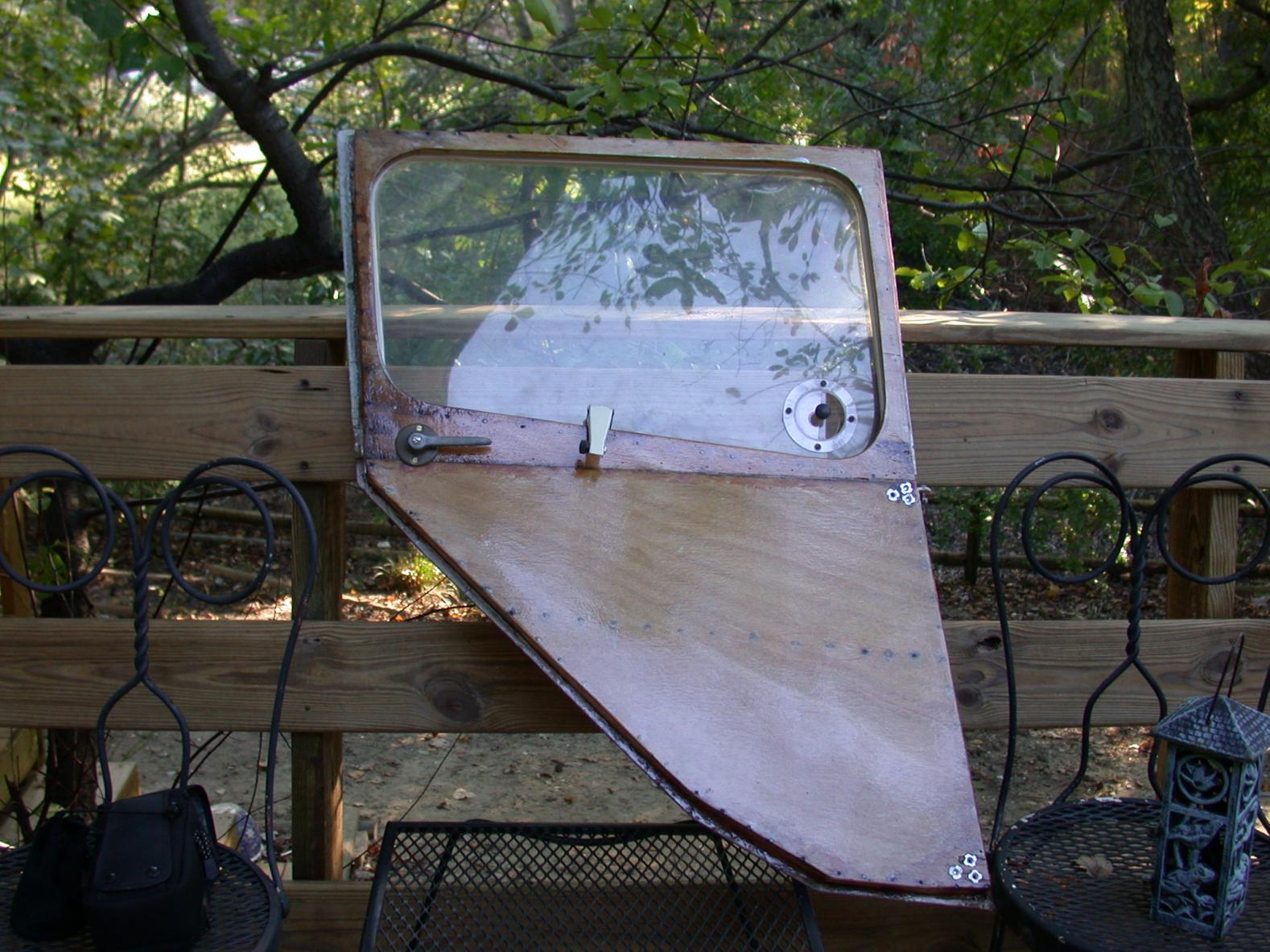

                  Paul,
                  Banjo yokes imply a B*12-65 Deluxe, although someone could have replaced yokes at some point. What is your N #/serial #/ model # on the data plate? IF you have a '41 B*12-65 Deluxe, those had wooden doors originally. They are the same shape as all other pre-war doors, but for sure at least the latches are different and wouldn't match up to the fuselage. I doubt you would find serviceable replacements, check with Tom Baker here on this forum, he may have blueprints for the wooden doors. Yes, pop rivets sound home-made, or at least someone re-skinned steel tube B*-65 non-Deluxe doors and modified the fuselage to make them work. Pics would be very helpful.

                        Re: Doors for 41 tcraft
                        She is SN 2594 and is a 41 BC12-65. Should have originally had the wood doors. I have the wood door drawings but you need to be forewarned, you better be a real professional wood worker to build them.....and the fixtures to build them in.
                        I tore mine completely down and rebuilt them. I didn't have fixtures so I used the fuselage as a fixture to get the pieces all back together right. It was a LOT of work. If you decide to take it on, the advice and lessons learned are free. IL to VA is a bit far, but not impossible.
                            The inner and outer skins are thin Ply. The interior structure is built up from square and rectangular wood. There is also a bad weak spot in the design. The fore and aft vertical wood window frames are too weak. When I rebuilt mine I put Carbon tape over the wood frame and put the ply over the tape (sandwiched in). My window frames are strong as stink now. HIGHLY recommended! I also used "T" nuts and machine screws instead of wood screws into the frame. MUCH stronger and the T nuts are hidden under teh fabric.
                            Once you get the drawings (I should still have mine too if you have problems getting them) remember your doors will NOT necessarily be just like the drawings. I made up the door frames in the fuselage and custom fitted the doors to the frames. My doors sound like a 1950s Buick when they close now. Really a SOLID sound.
