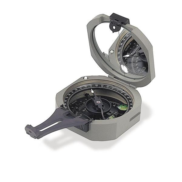

ID:	181378 I bought one of these to do my own compass swings... https://www.brunton.com/products/con...nt=36245970258
                          There's a rumor that some have taxied a plane on wheels and floats and used the GPS track to cal the compass.
                            There are ways to accurately calibrate a compass.....and there are the requirements the FAA has for calibrating them. A lot like the requirements for calibrated aircraft scales for weighing a plane. Most electronic bathroom scales (under $20 at WallMart) are more accurate and repeatable than the "approved" scales. safest to use both. If they disagree, put some known weights on each. When I have done it, guess which one turned out to be out of calibration! Remember you want the scale to be accurate close to the weight you will be measuring, NOT at zero! Same for your compass. Do what the FAA regs require, then verify in flight with your GPS or other devices to be sure the compass rose you used was even right. Sometimes even flying over a road is more accurate than a rose that was painted years ago and is no longer accurate. (don't forget to account for wind angle!!!!!)
