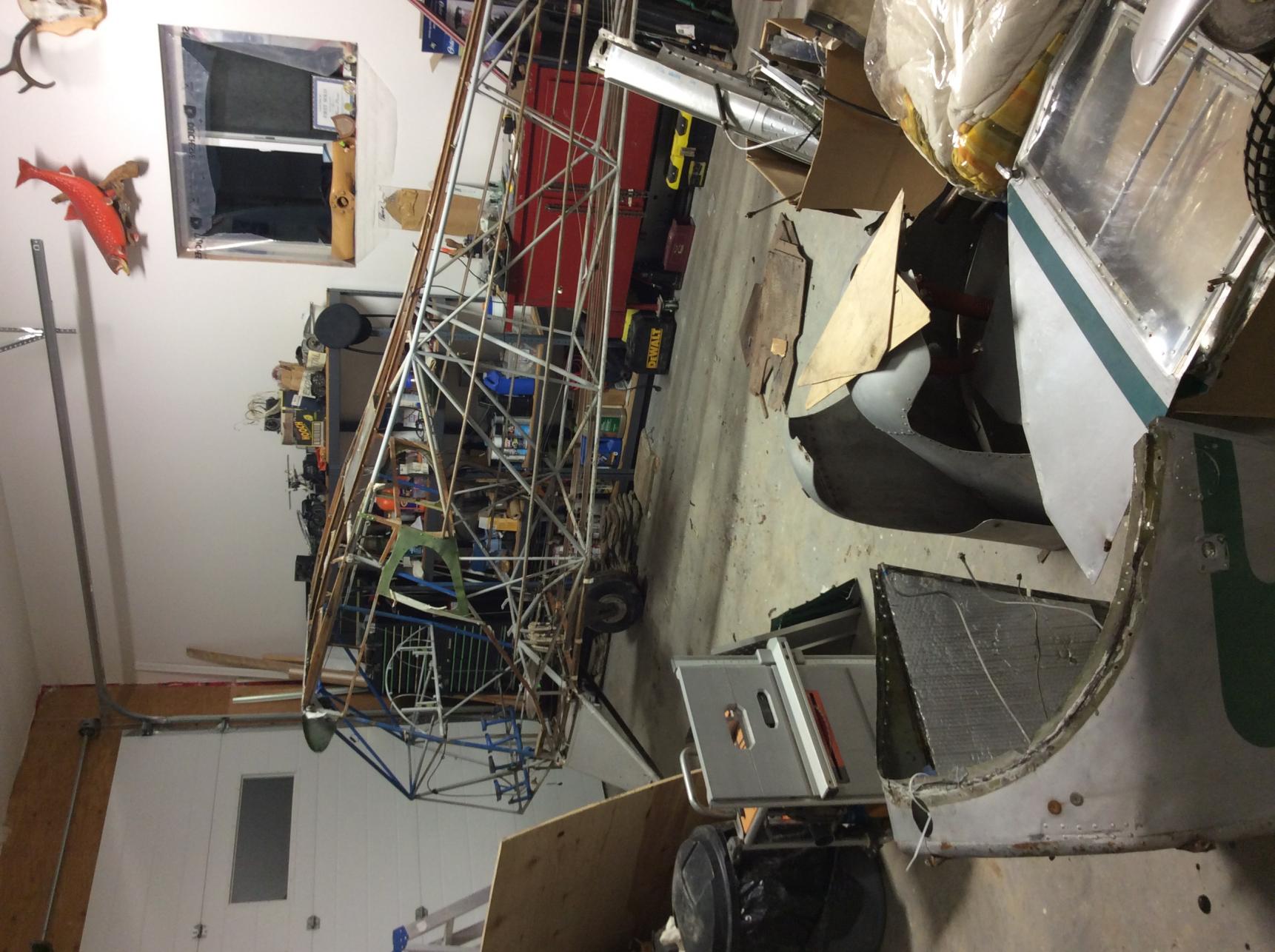

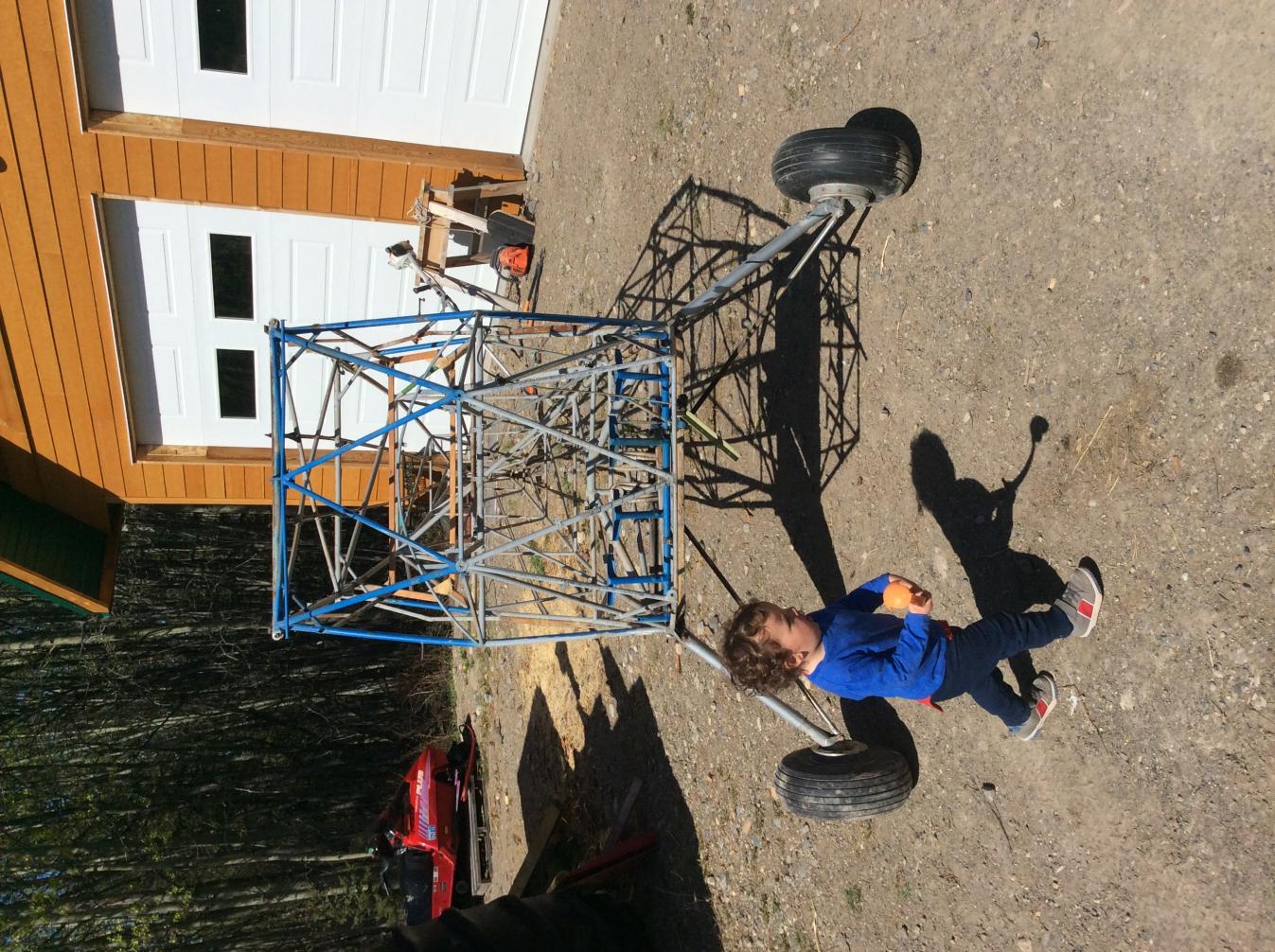

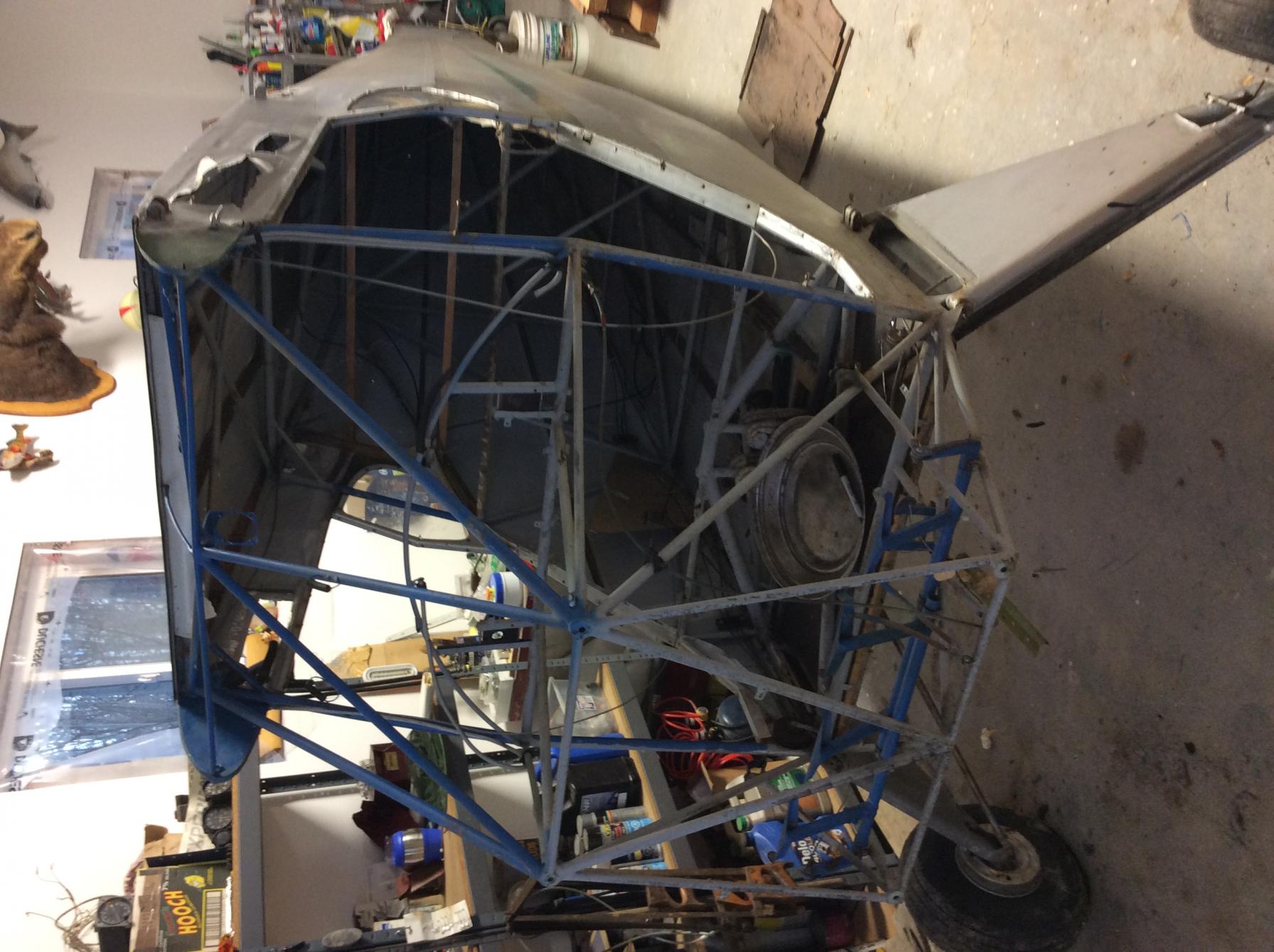

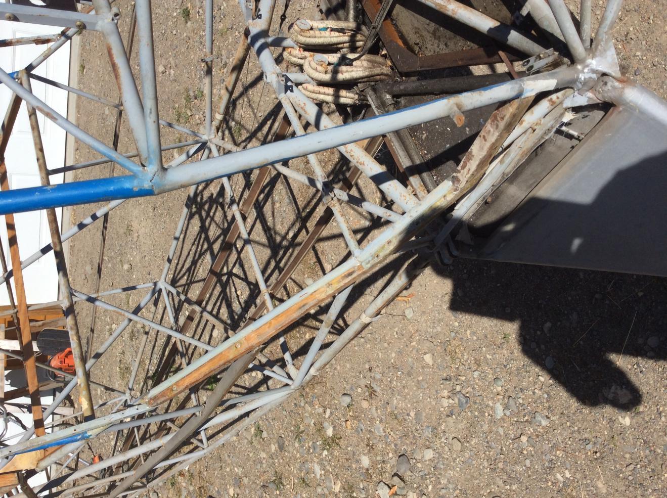

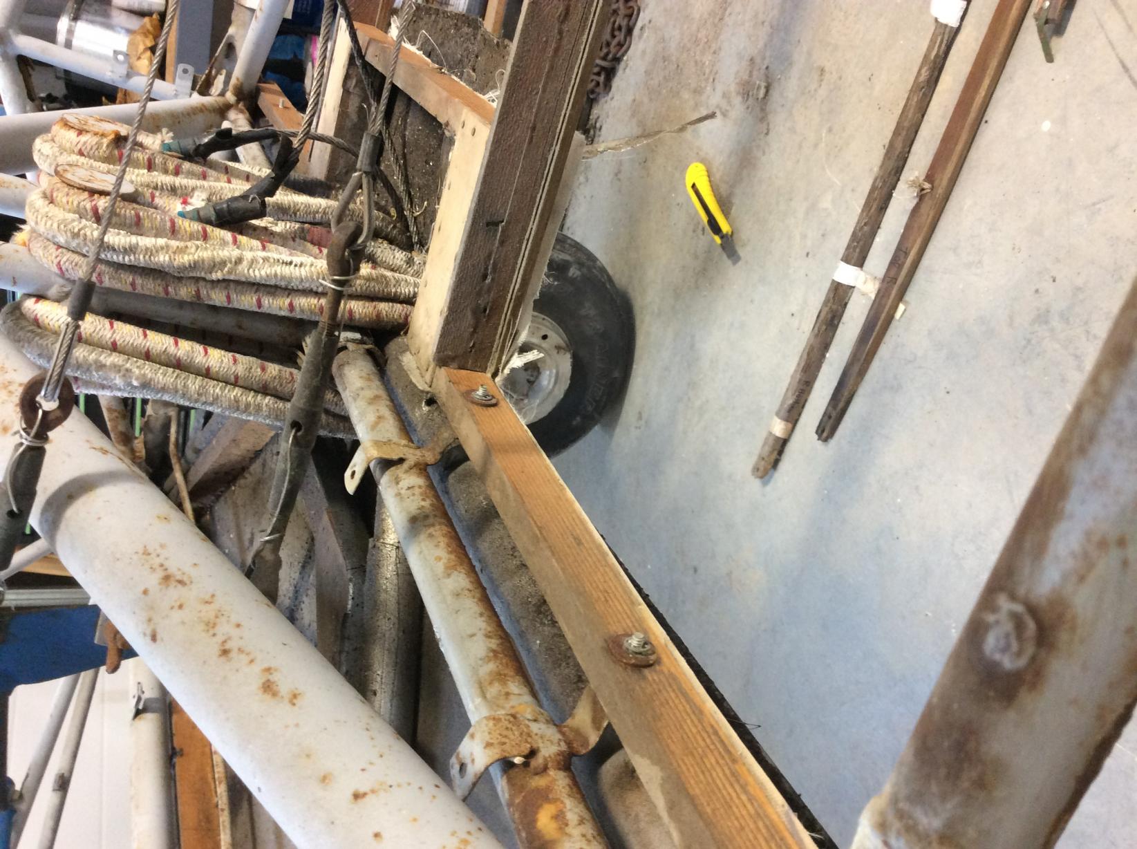

                                Re: Rebuilding 1938 BC-65
                                Here are some pictures. most recent would show all the stringers and other wood out as well. Can't wait to have it blasted and painted. Then we will be making headway. :dance:
