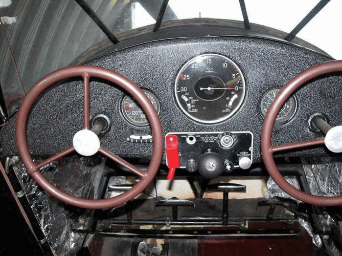

        I guess the next step is to figure out exactly what you have. Post pictures of what you can and we may be able to verify what model it is. Do you have any idea what the original N number and serial number are? Being in Canada it will not have the original U.S. number on it. Before you put any money into this you need to be sure you have clear title to the plane. Pictures of the instrument panel, control wheels, doors, wing ribs and trim system can go a long way to making sure of what you have. Don't start taking stuff apart and buying parts untill you know what you have and if you have more than simple possession. If you don't legally OWN it, she could come back and claim it (if she was smart she would wait for you to fix it, claim it, and refuse to pay you for the costs since you had done "unauthorized work" on "her" plane. These things can get sticky so don't put ANY money in till you have that clear title.

                Thanks a lot guys. I may actually try to contact this lady again like Hank suggested. I plan to be going back down south in a couple weeks to do some Sim time so when I get down there I will take lots of pictures of the Taylorcraft. I'm quite certain it is a 1938 tho. It has the monster sized tach with oil pressure and temp built into it. Other then that just has altimeter and airspeed. It has the open cowling style which I know was an early feature of BL,BC, and BF's. But when I go down south I will take pictures.

                    When you get back to the plane, look for the data plate. Might be on the floor under the passengers knees or on the kick panel under the right door. 20442 was built in January of '39 and has a right wing tank. There are some pics of her in different states of disassembly on my gallery page. h

                        Howard,
                        That looks exactly like the one I have. The panel is the same but mine has different yokes which say Taylorcraft in the middle. Like a half steering wheel not the full thing.

                          It sounds like the airplane has had some changes over the years. They built the big tach airplanes from 38 till 41. Look on the door hinges for a serial number. It may not match the paper work or data tag, but it should be close. With the serial number we can figure out what year the airplane was built.
                            Re: Rebuilding 1938 BC-65
                            The serial number will be stamped on the top of the upper right door hinge on the fuselage door post.
