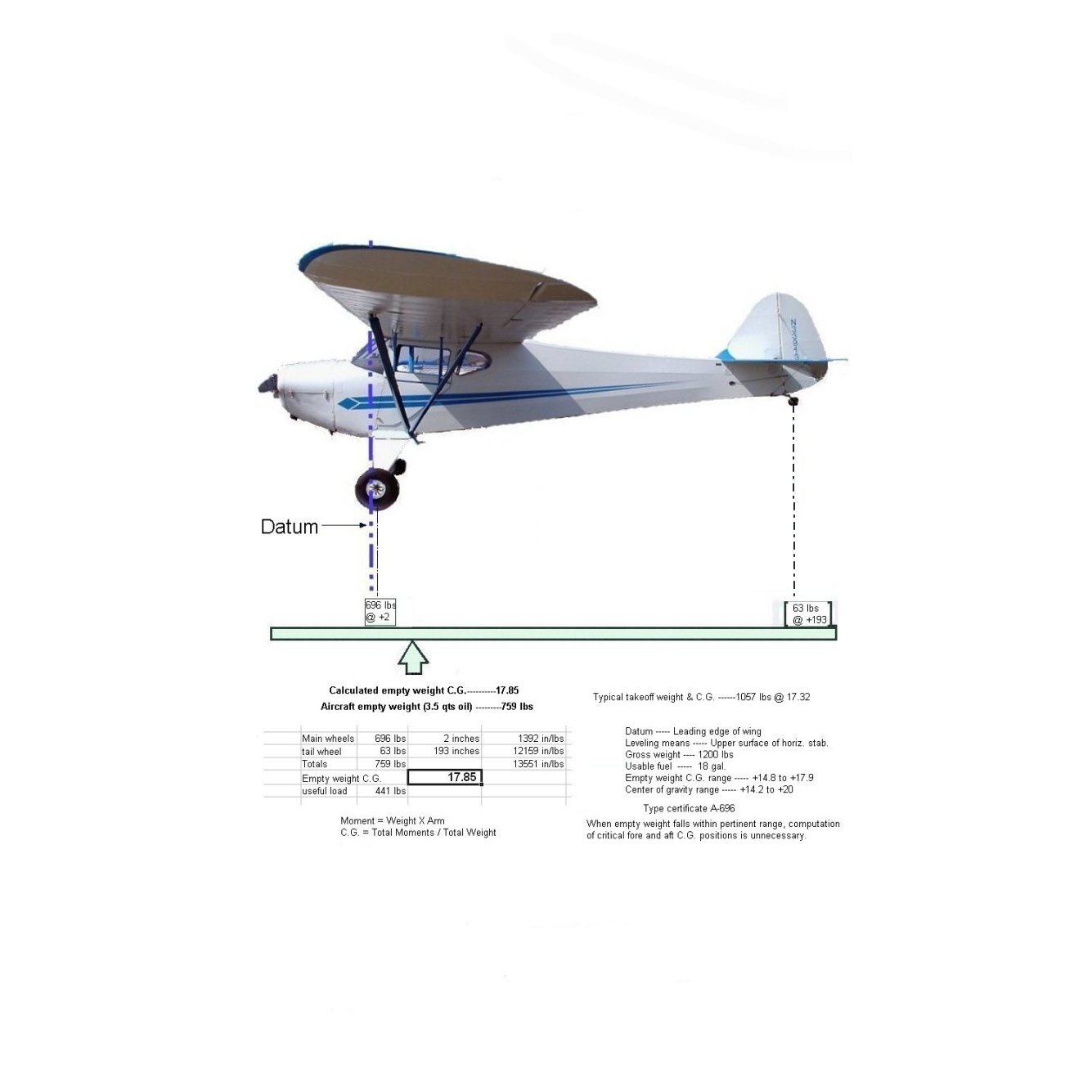

            Just did a w&b on 95901. attached are the results. Numbers on plane in pic are my '41.
            all pertinent data pulled from the TC. Empty weight just barely made it inside the envelope.
              Re: Weight & Balance Form
              attachment now
              and yes, if the plane looks familiar to anyone, it was copied from Capt'n Jon's site. Best side view I could get.

                Thanks for the sample. That will save some time!
