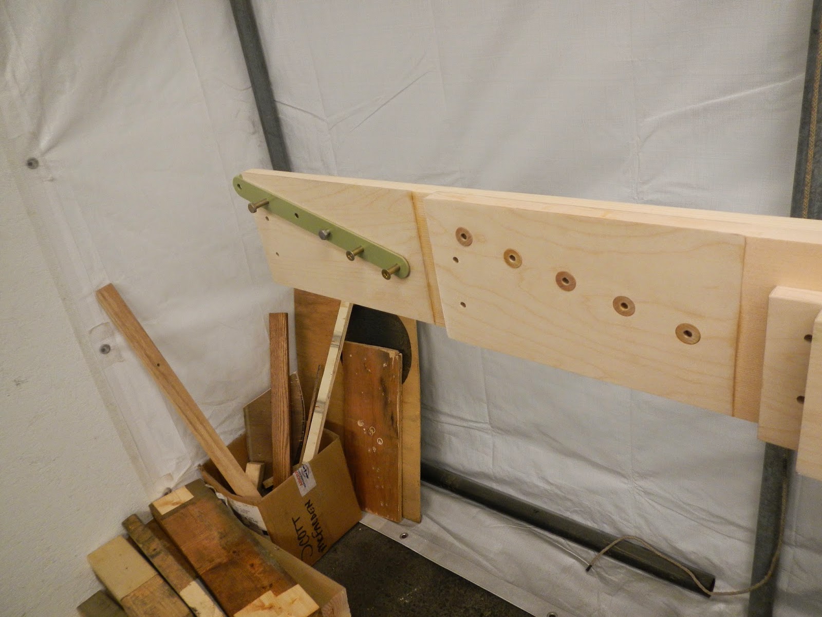

        I purchased the STC drawings for the wing upgrades only from Terry when I built my spars.
        Basically fabrication of the plates for the strut fittings and welding in place, and turning the fwd spar root bushings from fiber bar stock purchased from Aircraft Spruce.
        Is concidered a major modification for certificated aircraft, and that part cost me more than the mod.

              Recent investigation into the spars sold by Wag, They have no bushings installed. You must install your own bushings. As to the fabrication of the fittings, I would hazard to guess that one could use the old ones as a pattern, and fabricate new ones using .095 thick steel. But would probably be easier to order new ones for a BC12D-85, or the F-19

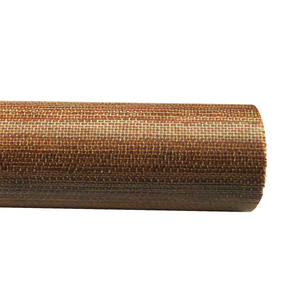

                            ....and turning the fwd spar root bushings from fiber bar stock purchased from Aircraft Spruce.S
                            By fiber bar stock, do you mean phenolic material? (I assume with the STC that they go with a plastic material because it has more 'give' than, say, a metal-type bushing that would tend to crack the spar?)
                            What diameter are those fiber bushings? Are they machined from square rods or cut out of sheets?
                              Grade L Linen Base Phenolic Rod Used to provide high-strength close-tolerance bolt holes in wooden spars. Cut rod to spar thickness, drill and ream for proper bolt fit. Drill hole in spar for slip fit of rod, then bond in spar with ...
                              The dimensions are provided with the STC
