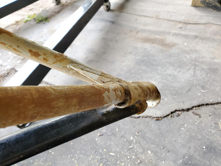

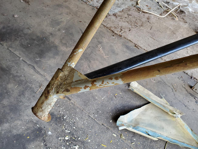

        I am new to the Taylorcraft world and still have lots to learn. After a closer look and comparing to some images I've found online it appears that the tube I was concerned about may actually be correct/original. I have attached a couple pictures of the pilot side gear leg. I was looking at the smaller 3/4" tube going into the larger tube at the end. But that larger tube extends to where the bungees mount and looks like it may be correct. May just be a way of making the gear that I haven't seen before. I was concerned that the smaller tube may have been added in place of what should be larger diameter as a repair.

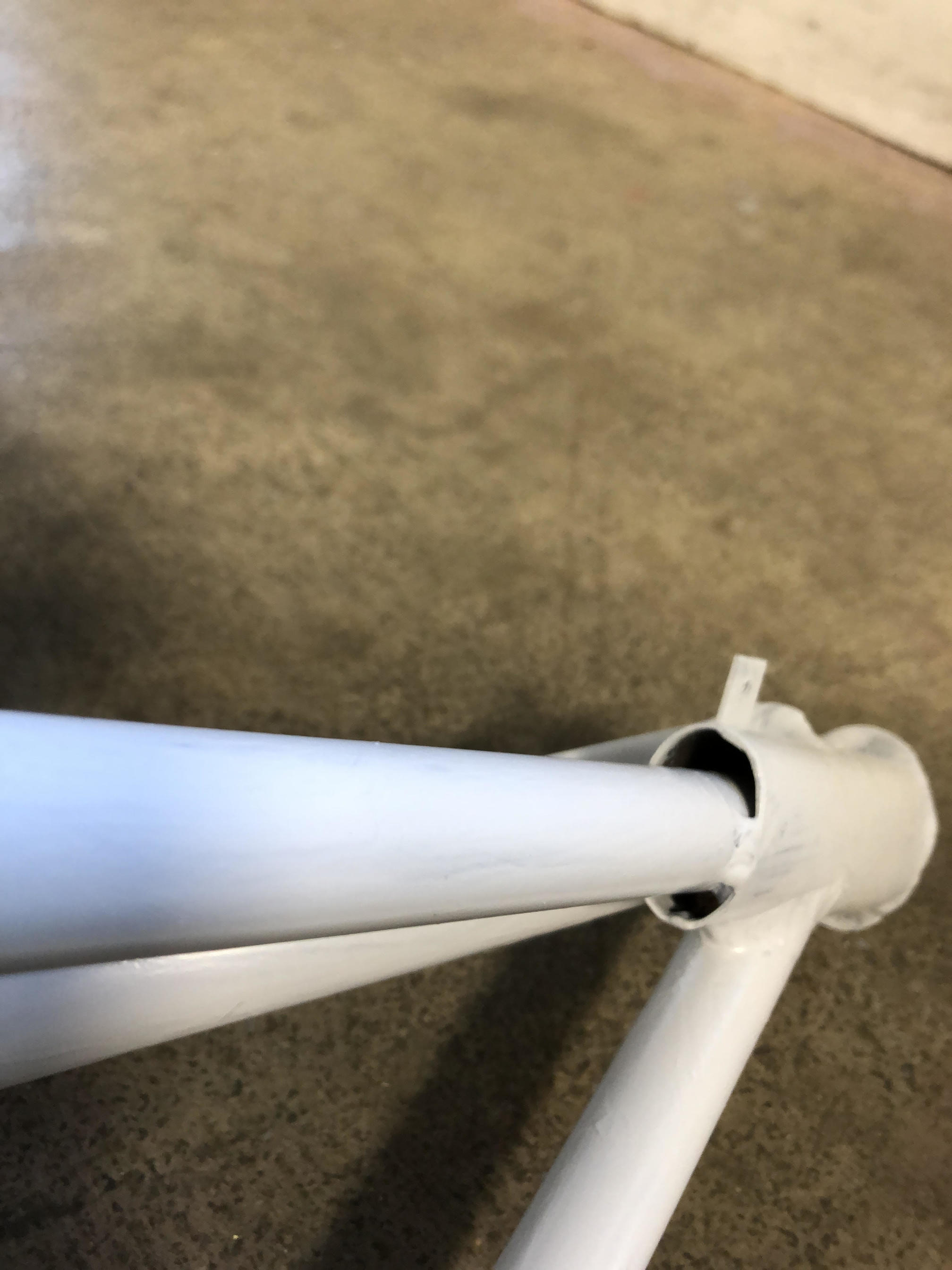

          If you are referring to the gap where the tube slides in? That is the way it is supposed to be. That gear does have an extra gusset added at the corner though. Click image for larger version

            Mine doesn't have that extra triangular gusset either. Perhaps that's a repair?
              Mine does not have the gusset. The tubes are 7/8 x .049
