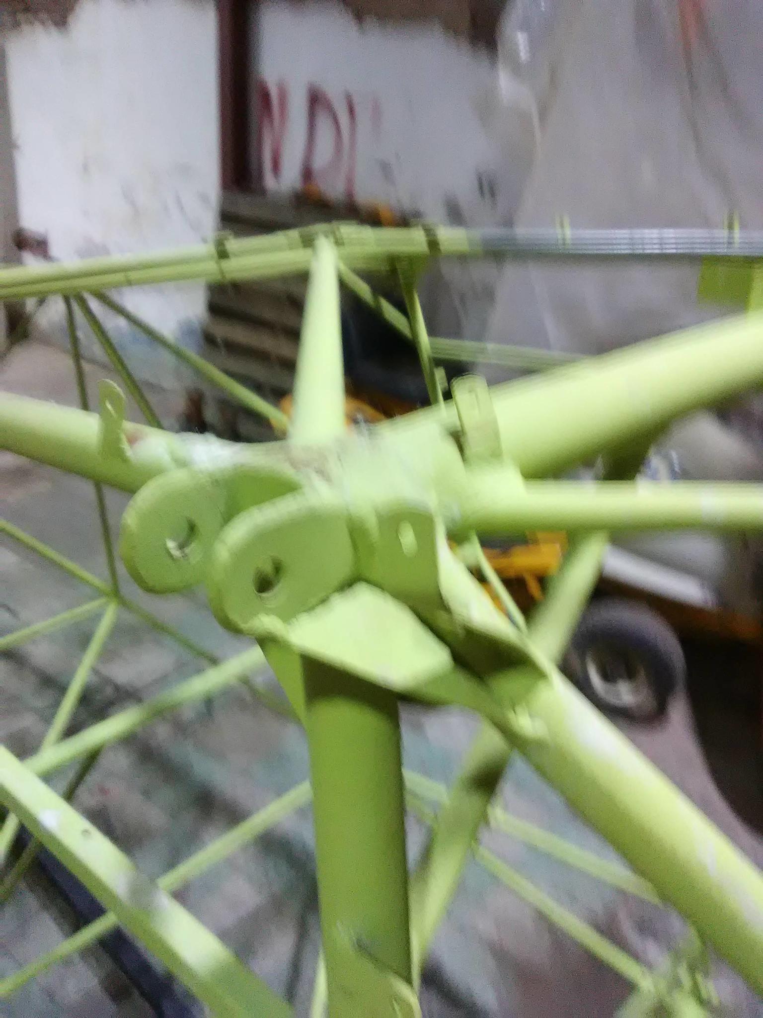

ID:	187487 Here are images of the 46 BC-12 I'm covering, these triangular gussets are not welded fully, just at ends. Does anyone know if thats the norm? The 41 I've got does not have these gussets. Click image for larger version

    BC12-D we have in the shop has these. They are completely welded on the bottom side, the top looks just like yours.

      are they welded only on one side? That would be normal
        I will check, just being annal!
          that is correct for post war. its part of gross weight increase. If you was doing the gilberti/bowden f-19 stc to a prewar, you would have to add them.
            Yep, they are welded on the bottom, thanks for the inputs!
