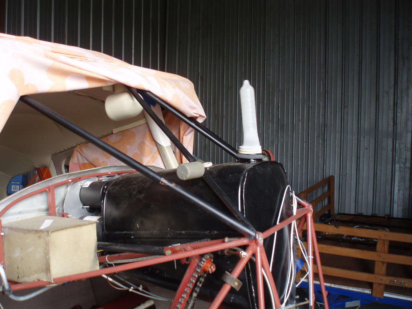

ID:	187149 A really great way to find tank leaks is with a Condom (OK, quit laughing). One of the big risks looking for leaks is you can EASILY damage the tank with pressure. Using air will find smaller "weeping" leaks much easier than using a liquid. All you do is put a condom over one outlet, plug all others except the one you are going to put the air in and then plug that one after putting the air in. You will NOT need a compressor. I just blew into the fuel line to inflate the condom. If it stays inflated, you are golden! If not just put some dish washing soap and water in a sprayer and you will get bubbles where the air is getting out. There are two really fun parts to this process. One is the look on peoples faces when they go past your hangar. The second is trying to convince the pharmacist why you are buying the cheapest condom he sells. Not sure which is more fun. ;-)
