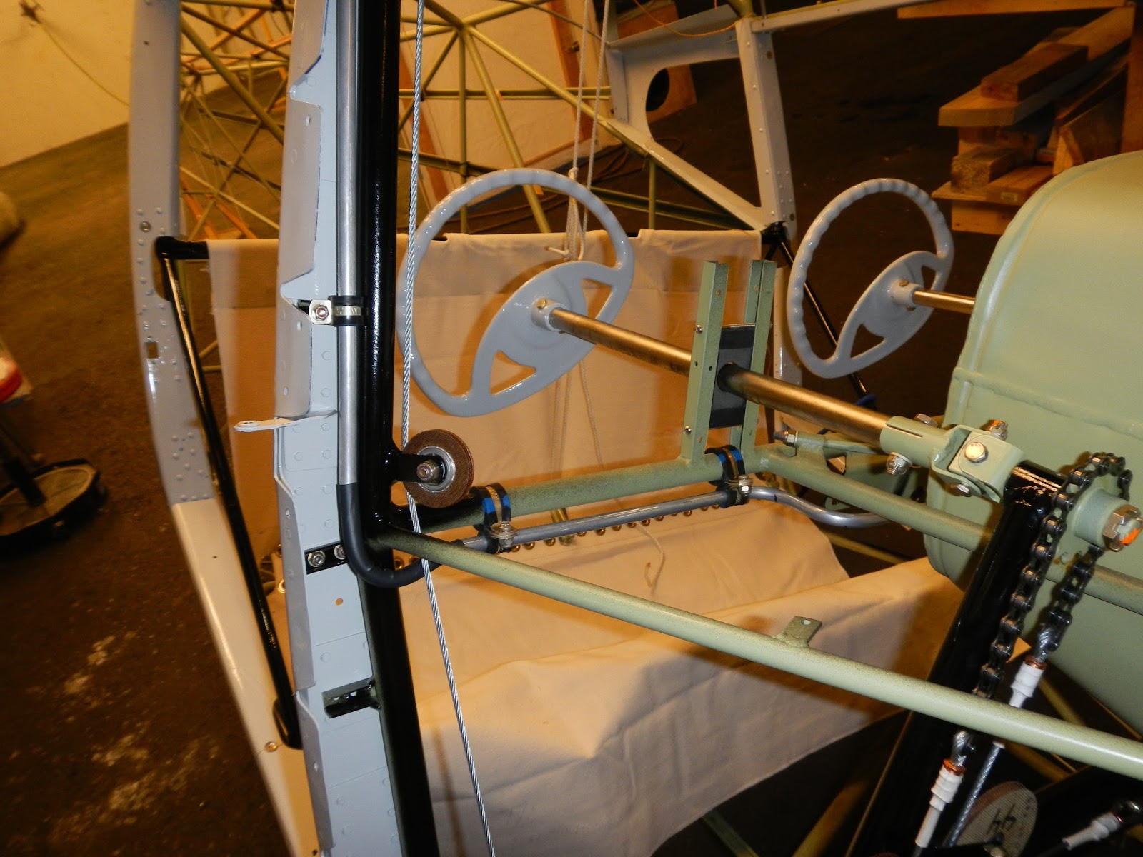

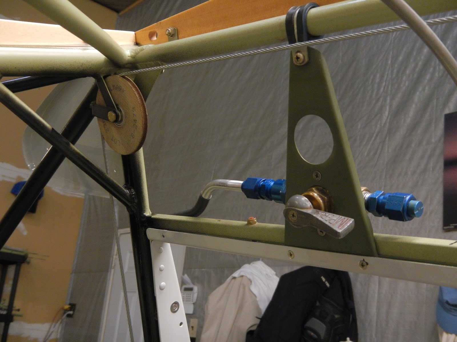

        My routing is very similar to Rob's. I chose to put the shutoff valve above the door. The thinking being that if it leaks it won't drain the main tank as well.
        Here's a shot of the lower routing (I had to reposition the adel clamps when I installed the instrument panel)

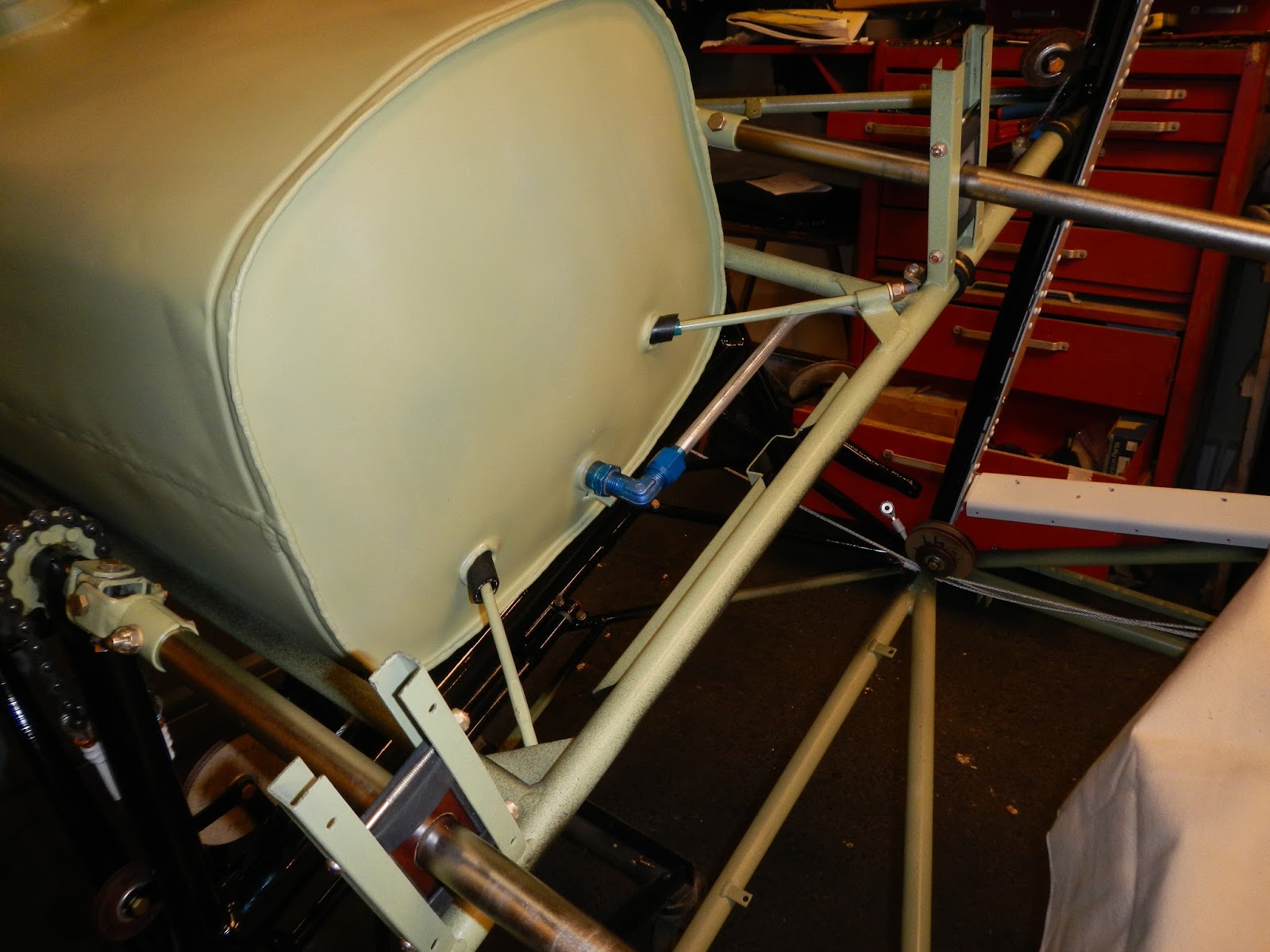

          Re: fuel line routing
          Connection at the main tank:
          And fuel valve installation:
