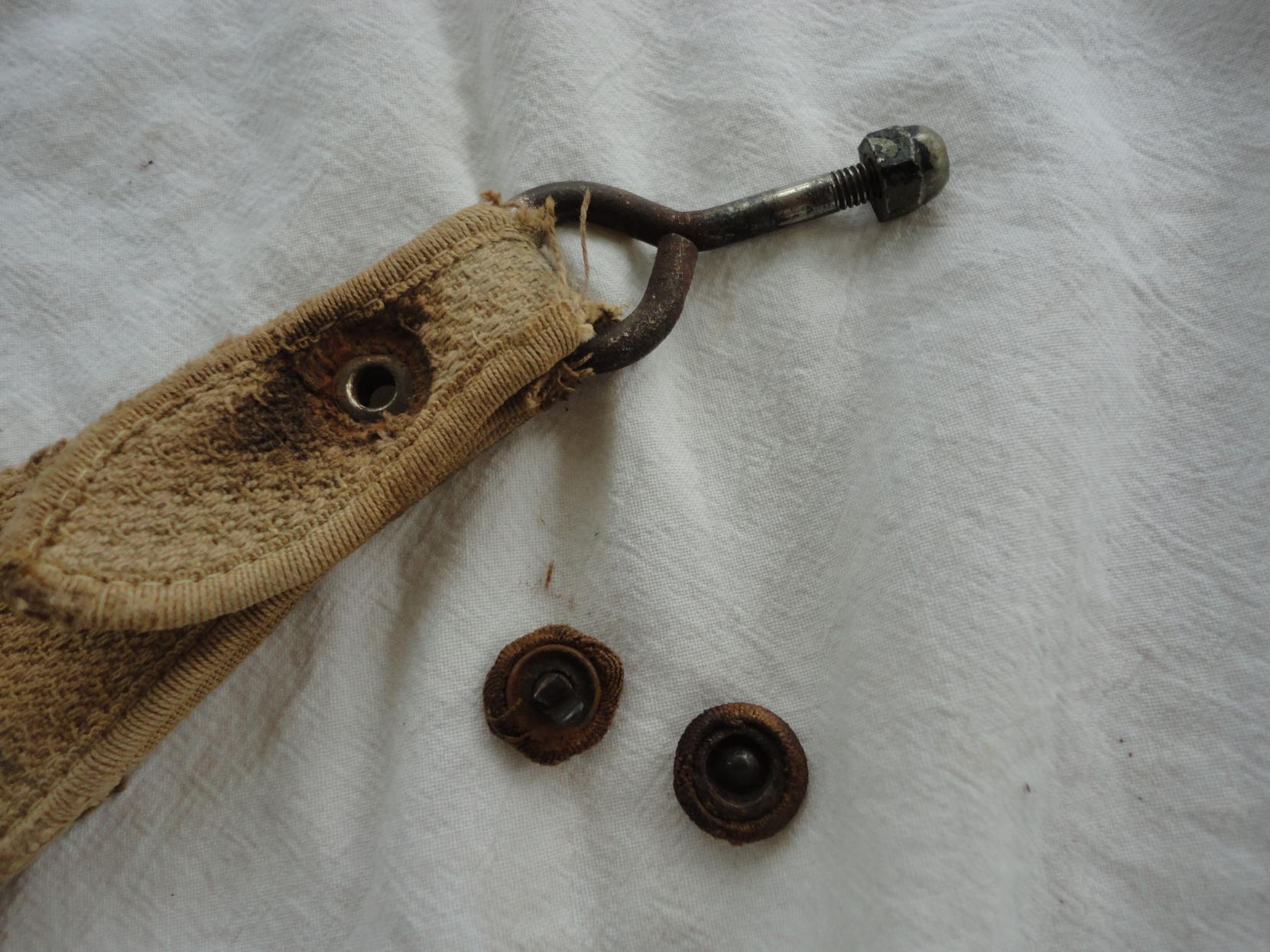

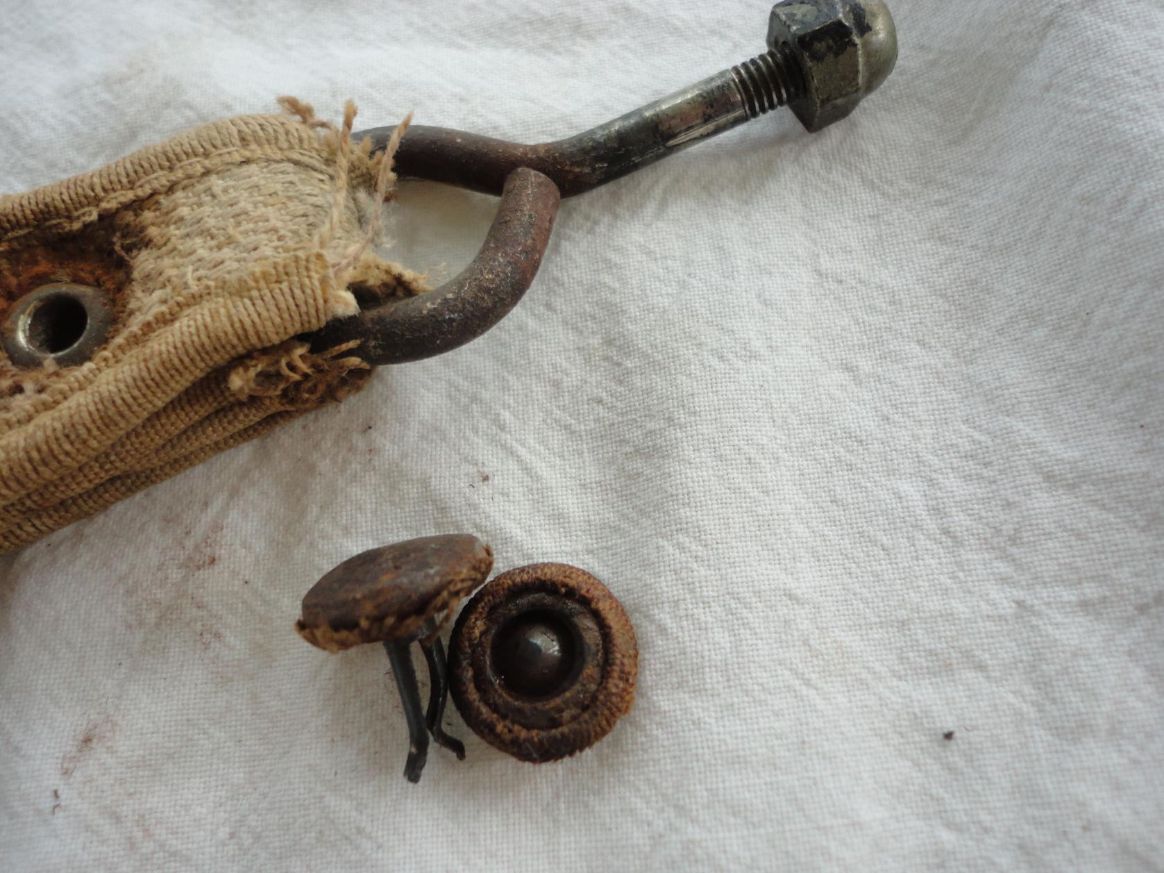

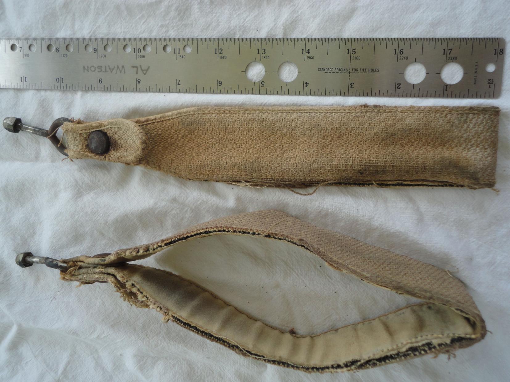

                    They are the straps that hang from the top front of the door frame to assist you when getting in or out of the door. I have also heard them called assists straps, pullman straps and just plain hand straps. They picked up the name "Sissy Straps" from the macho guys who refused to use them. Easily identified because theirs were never worn out. ;-)
                    One of the Tribe (lost the message, chime in please!) sent me photos and measurements of a set he found and I am in the process of making duplicates. I took the photos to a couple of upholstery and sewing experts and they said it looked like the interior was polished cotton and one had fabric that looked just like the photos for the outside. We even found the same hardware for the button and eye bolt (OK, the eye bolt required a little machining). I am assuming the fabric would match either one of the seat colors or the headliner and am having a set made.
                    These are the photos I received. He gave me some dimensions and I have scaled the rest.
                    I will post photos when the first set are made and find out how much to make a run of them if anyone is interested.

                        If you have the eye bolts and not the straps, someone had an exciting drop when they were using them! We will be putting a reinforcing strap inside the strap so they don't tear out like the ones in the picture. That middle photo looks like it is close to letting go.
