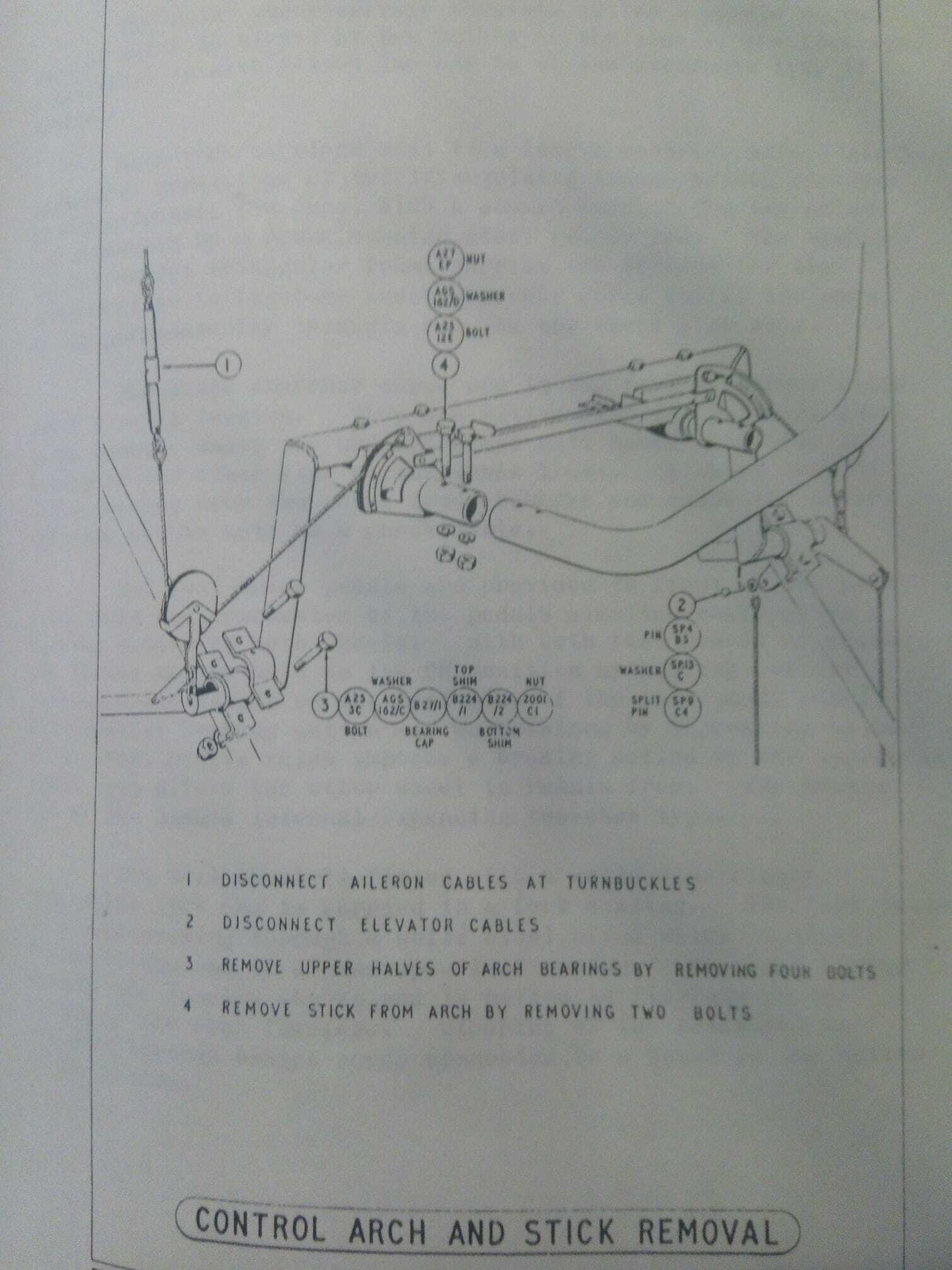

    I am the Director of a non-profit youth aero clube where the youngsters have restored a couple of Cessna 150's and are finishing up a 172. Next up for their tailwheel is a '41 Model T-craft that was donated to the Clube about a year ago. I have both the Swick and Cole plans. I am not real fond of the control stick configuration for a variety of reason's - one is being difficult to get in and out of and the other is we will be using it for training and really want dual sticks.
    I have seen a couple of pics of the Taylorcraft/Auster which (as best as I could tell from the pic) appears to have half the "H" control column with control sticks attached to the cross-member instead of the control yokes?
    Does anyone have any better pictures or information of that Auster arrangement?

      I am not sure if you are understanding me correctly. The Tango Thirty One Aero Clube kids are going to build a clip wing T-Craft. Although I do like the control response with the Swick stick, I do not like it for a variety of other reasons, primarily when there are two people on board - I have seen a few pics of the Auster, which early on was a Taylorcraft built under license in England. Two place side by side with a pair of sticks. I ran across the attached pic this afternoon and it pretty much looks like the T-Craft control column with out the upper portion.
      This will be for upset recovery training (wink) for the youngsters. We can just use the full control column and wheels like the Cole plans, but I am looking for alternatives and thought the Auster control system might be it.
      I have not flown an Auster so I have no idea how the stick feels.

        There was an Auster at Oshkosh this year. I looked at the control set up, and was not impressed. I have flown with one of the pre war factory stick replacements for the wheel and it was awful. I think if you want dual sticks you need to design something yourself, or adapt from another design. Here is a set up from a Flight Design CT that some one salvaged, and has for sale. I think it could be adapted to work with the Swick torque tube.
          Stick controls was an optional item in a time at Taylorcraft.
            I have a plan for sticks for my clipwing, but reluctant to post until I have the system installed and working. If it works it should be pretty slick
