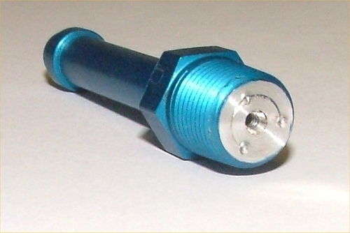

                        The photo below is what I made: thread the inside of the AN840-4D fitting; make a threaded male plug to suit with a tiddy tiny hole (I think I went for #30). Thread it in with loctite, stake it for security, voila!

                            Here's a 1/8" NPT restrictor fitting that feeds an oil line (I assume flex hose or rigid copper) larger than 1/8":
                            Edit: There's also some chatter about pushing a soft rivet into the flared outlet of a similar fitting w/o a restrictor already installed and then drilling a small hole in the rivet. The oil line that attaches then holds the rivet in place.

                              Hello Gary,
                              That NPT restrictor fitting certainly fulfils the purpose of restricting flow in the case of an oil pressure gauge line failing.
