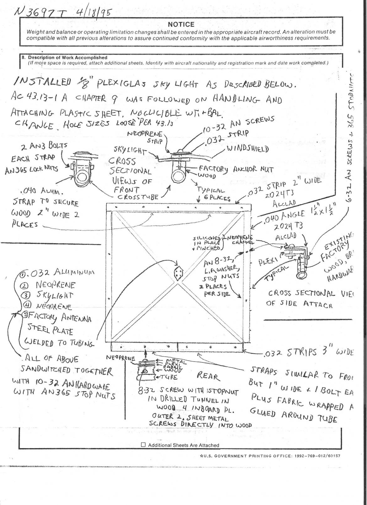

        Dan I finally got around to scanning the 337 for my skylight which i think is pretty similar to what is on the taylorcraft site already. No chance in getting pics of the skylight though till it warms up and all the ice melts away, but will try to tackle that as soon as I get the chance. Here are the docs.

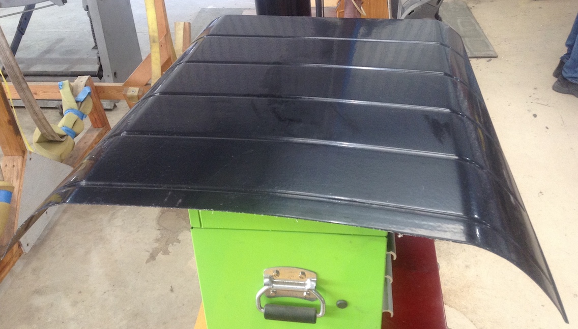

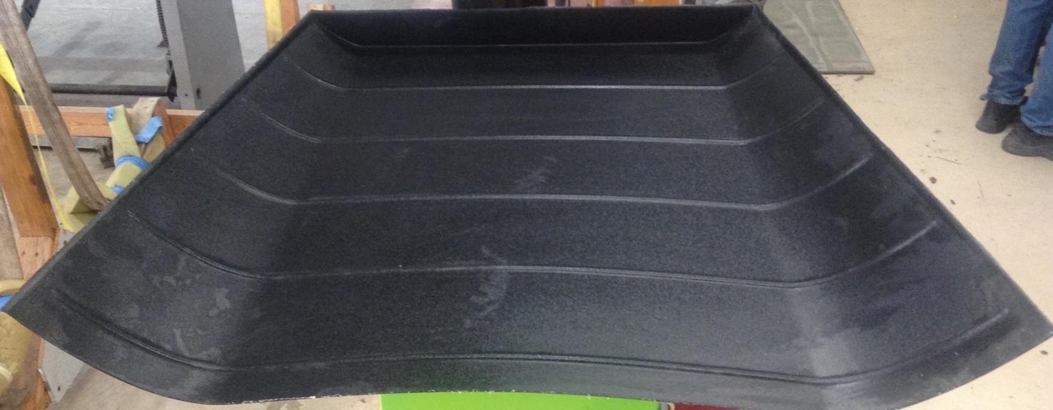

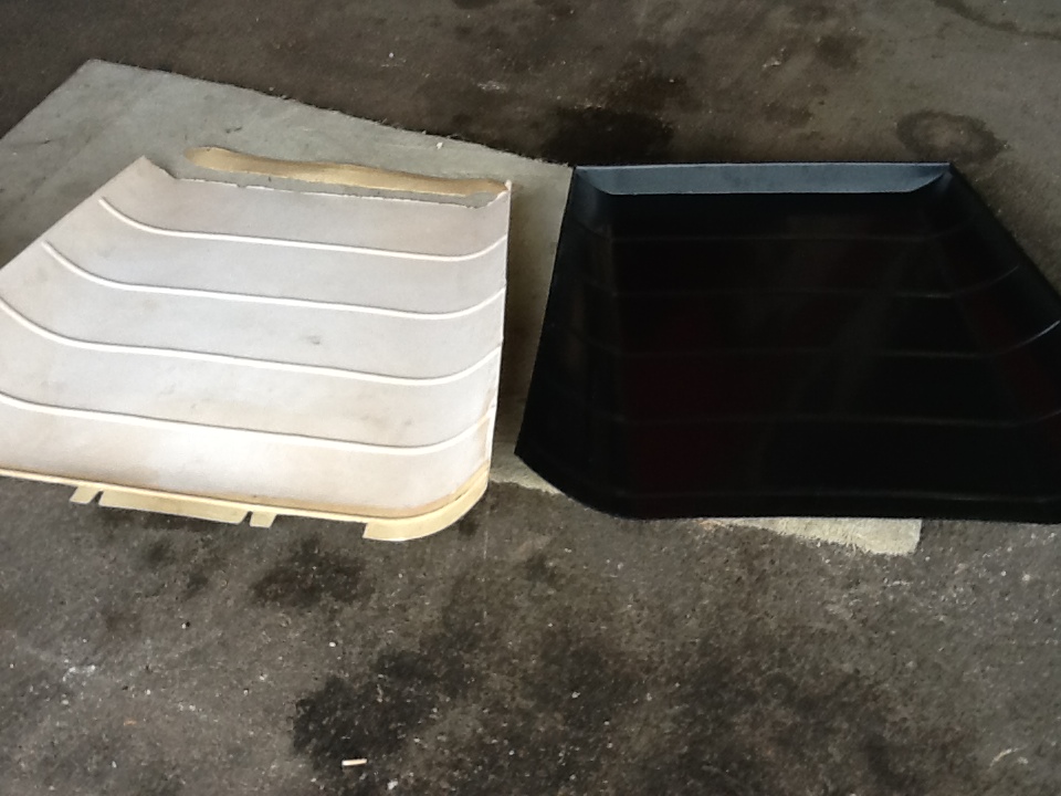

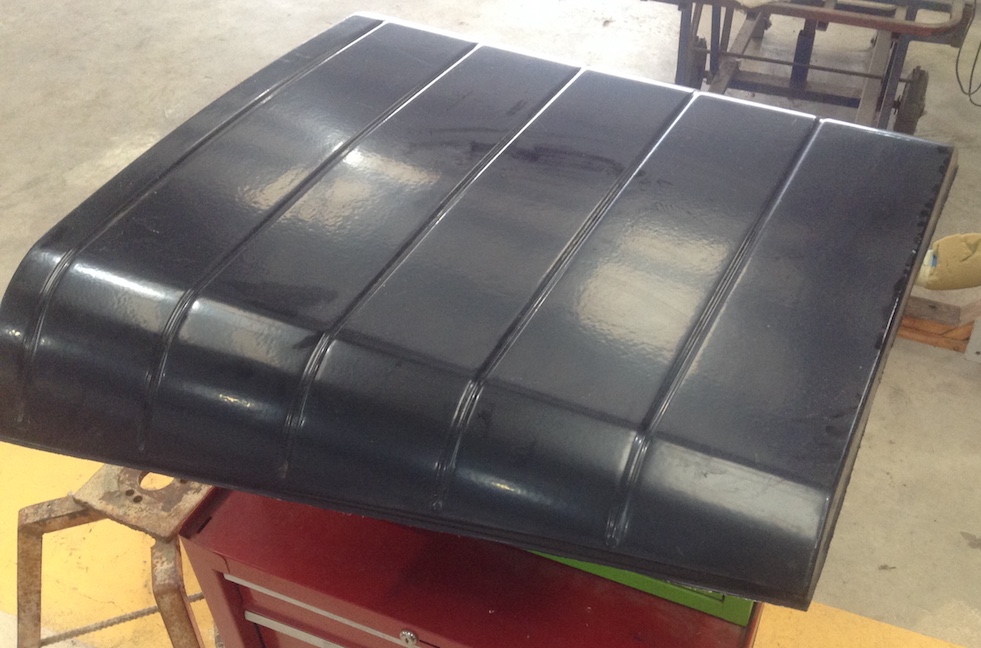

            I finally got all the needed pieces together to vacu-form some aft headliners to fit the F-19. The finished product is made of ABS plastic and thicker material than the original. The color is black but paint can make it anything you like.
            I had the original liner digitized and then a (large) male mould was made on a CNC router. A 4x4 foot sheet of 1/8 inch plastic was heated and vacuumed onto the mould. The results are very nice. At the thinnest point the plastic drew down to about .070 inches which is still thicker than the original .065 shell. It is flexible enough to shape it into the top of the plane and it is very tough. We only ruined three sheets of plastic to get the temperatures and pressures correct. As it turns out, ABS plastic absorbs moisture and I had to build a drying booth to get the plastic dried out lest moisture should steam and burst out like chicken pox all over the plastic. I'm happy to say that the plastic is pox-free.

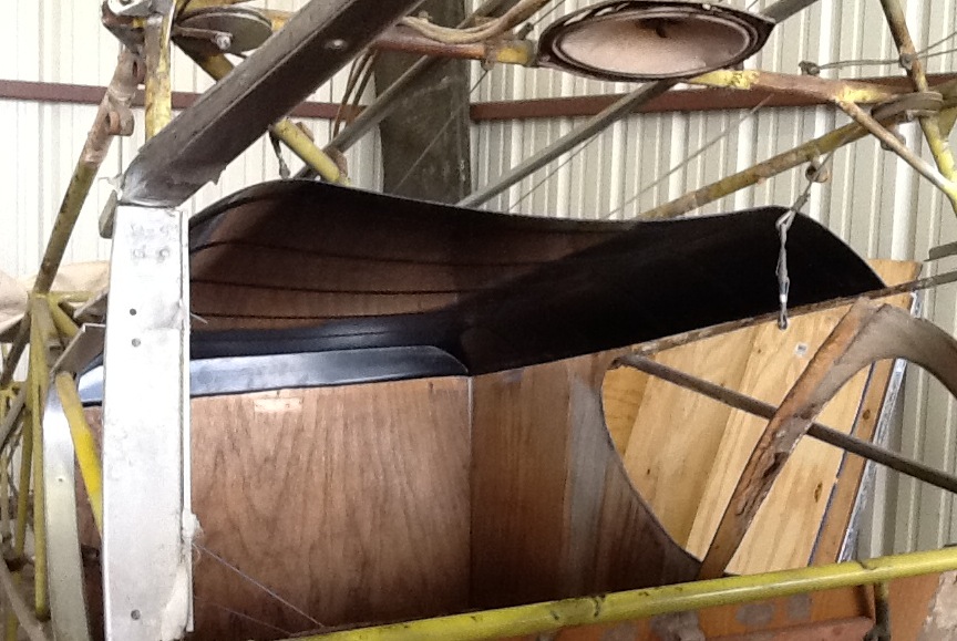

            One headliner is shown more or less in place in the photo below exactly as I received it from the plastics shop. A small amount of final trimming will be needed to completely fit it up.

              Nice work Mark! Is there something there to support the center where it sags when fully installed? Something like that would be nice for my old 41 BC, cover up unsightly stuff and easy to clean. I could see that for the whole headliner as you could mold it very close to the existing tubing, leaving more room in the cabin. However probably heavier then the cloth and certainly heavier then nothing, which is what I currently plan.
              L
                Re: F-19 Headliner
                My old shabby headliner has a couple cut-outs near the center where it must have been fastened to the top of the plane or to the front headliner.
                I don't believe this will fit a '41 ??? It is a copy of the headliner over the extended baggage area of the 19.
                It would be a simple matter to fabricate an attachment to an adel clamp, or to make a stiffener. For example, the new plastic is thick enough to accept a screw through it into a batten.
