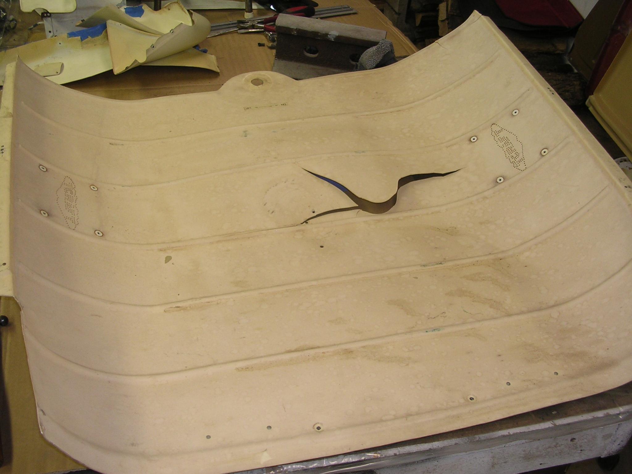

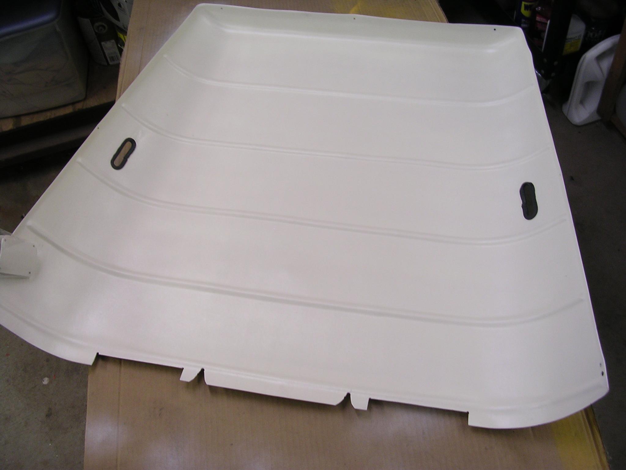

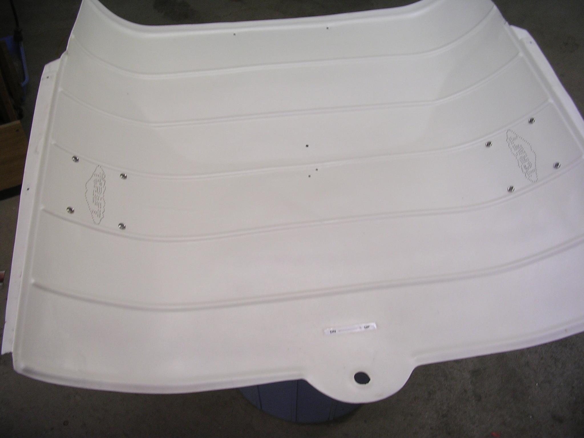

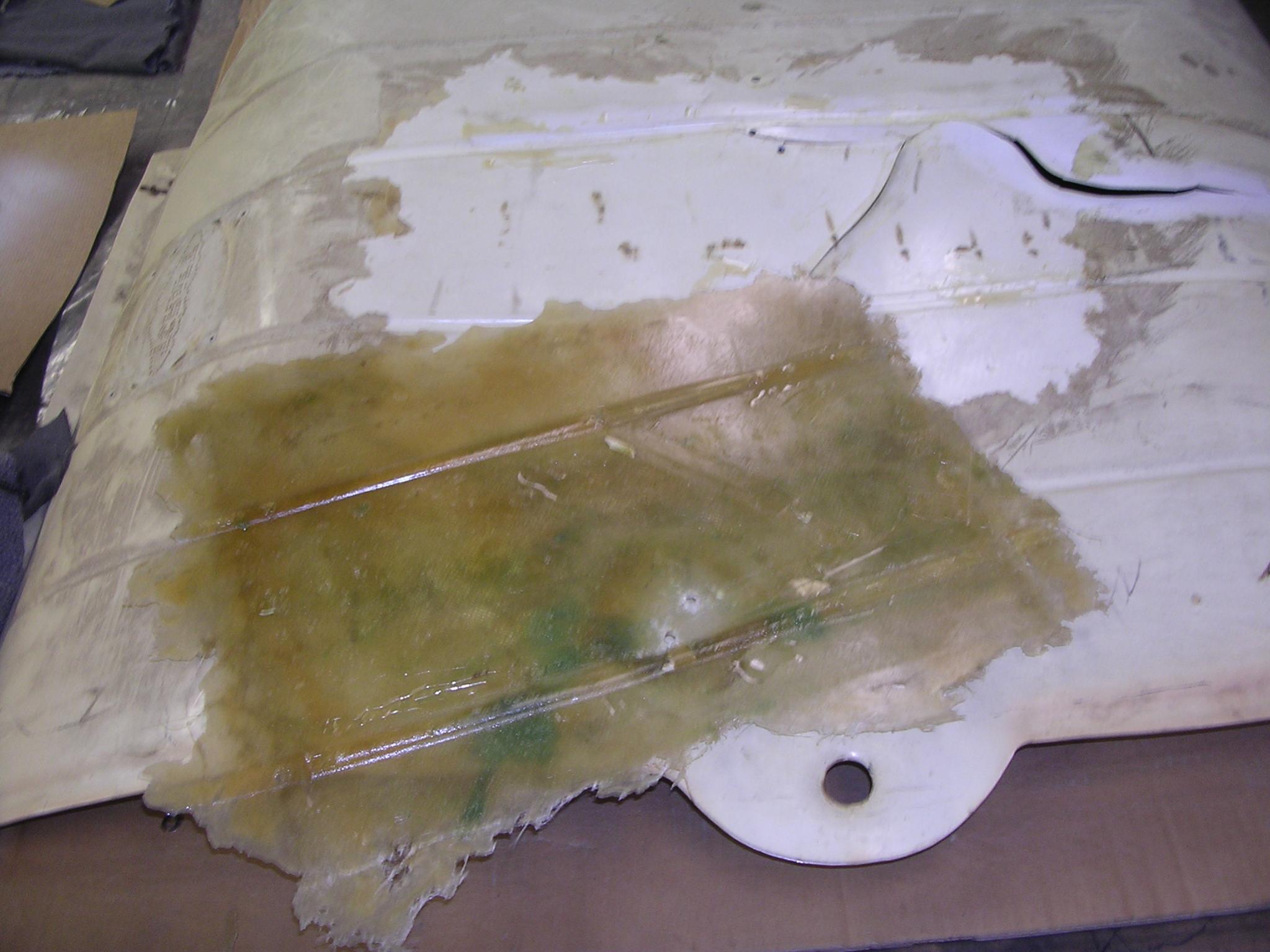

    Not sure if this would help anyone but this is how I repaired a F19 headliner that was previously repaired with fiberglass. I have used on all ABS plastic parts. Tape the face side so both edges match evenly and put Permatex black plastic welder on the back off the crack. Do only about 6 to 8 in. at a time as it sets up in 5 min. It works good as a backer for all brittle ABS parts. Than paint with plastic spray paint.
    Permatex BLACK PLASTIC WELDER
    2 PART EPOXY
    #84145
