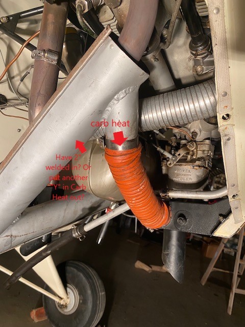

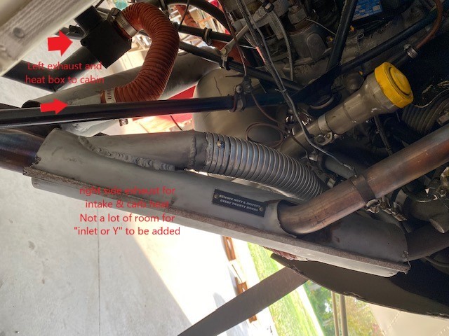

                  Thanks for the suggestions! Sorry for not responding but it took me a few days to get the exhaust pictures. I was a bit wrong in my previous statements. The "cabin heat" is tapped into the left muffs and the right muff supplies supplies the carb heat as Gary mentioned.
                  Taylorcrafty, was your thoughts to order the "Turbo Heat Cabin Heat Muff" from the link you supplied above and just replace the left muff? Just order it to length so it is similar to the original one already installed?
                  Gary, I've supplied some pics of my setup I'm curious how you did the "Y" from the outlet going to the carb heat. I'm also curious how you went through the firewall? Another Heat box? I would think if you went with the annealed springs in the muff that the additional heat would be enough for cabin and carb, or shutoff cabin during landing.
                  I have uploaded two pictures of my current heating / exhaust setup.

                      The "Y" gets inserted in the red SCAT to the carb heat box. The inlet to the "Y" goes at the single bottom and then one branch continues on to the carb heat box while the other goes to a new shutoff capable airbox on the firewall in my case. Some airboxes are just a straight passthrough while some are designed to dump hot air if not needed. I use the straight passthrough design so I can get full carb heat when the extra cabin heat is closed per my placard.
                      I'll take some pics of my setup.
                        Gary, do you have a picture of how you did the "Y" on the right side (carb heat). Also, in reading your previous post. The 2" SCAT from right side is to a second shutoff box and does not tie into the existing heat from left side. Would you have a picture of where you connected this on the firewall?

                          I'll take some pics but it's really quite simple. See page 67 of the Wag-Aero catalog for duct adapters and heat valves. There may be other sources.
                            Thanks, I think I got it, but I always like to verify via pictures if I can. I referenced Wag-Aero as well.

                              Here's my heat robber setup. On the left is the "Y" that goes to the 2" bulkhead collar and carb heat box. In the middle is the left muffler to regular cabin heat source box. On the right is the airbox mounted behind the firewall with a collar that extends through the firewall and a collar (now capped off for summer) to which the long red SCAT defroster hose attaches in winter. A cable goes from the airbox arm to the panel to activate the heat. The extra airbox has no air dump and is variable open<>closed. Closed if all carb heat airflow is needed.
