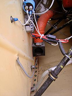

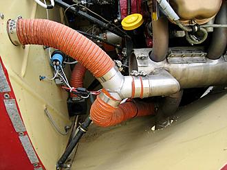

    I have uploaded two pictures of my current heating / exhaust setup.

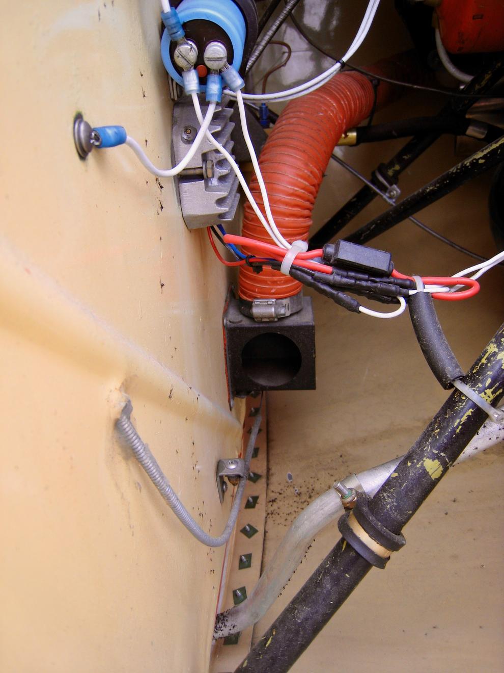

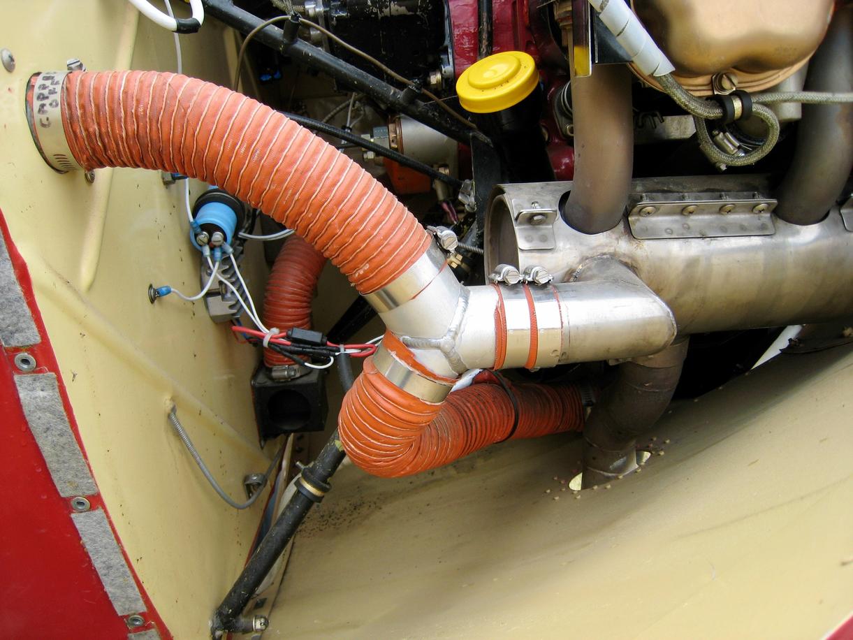

      Here's my heat robber setup. .
      Thank you, this is very helpful
        Here's some thought about winter heating from the engine. The faster the airflow through the system the colder the outlet air but the better the rate of defrosting. Taking inlet air from the front of the cowl produces the best flow but can introduce colder air that then need to be heated than taking it from the rear baffles. The tighter the main cowling outlet the greater the internal cowling pressure and better the airflow through the heater. The engine will only heat the headers so much, so introducing interrupters like door springs or edged-winged aluminum baffles can increase the heated surface area. Inline heat muffs like Supercubs work well...they take preheated air off the front pipe and run it again through a second rear muff. Run the engine hard in winter to heat the header pipes. Close off the rear of the cockpit and tail area with drapes and sealing to hold heat around the pilot. Cold air comes from the rear and up around the bungees so seal them off. Insulate the boot cowl to hold in heat and prevent cold surfaces. Use a flexible defroster hose to melt ice on side and front windows. Dry off your clothing before flying, melted snow frosts up the windows.

          I was chatting at the local airport this morning and one individual mentioned that instead of door springs that they ran copper wire like a coil around the exhaust in a 170 back in the day. It conducts and expels heat well. If you didn't have thick copper wire you could twist two strands of 12 gauge together like you wood safety wire and wrap that around the exhaust.
          Also, I have a EGT gauge in the plane and I was thinking you could remove it from the exhaust and put it on the Carb Heat Box exhaust and if you were running the heat off the "Y" you could see how much heat was still flowing through that part of the system. Just a side thought as I was reading these responses and looking at the pictures.

              Gary,
              Do you have a picture of how you did the scat tube in the cockpit? I am trying to I vision how to make it not get in the way of the passenger.
              Thanks
              Taylor
                From the cockpit side metal collar the air tube goes down to the right to avoid the elevator column, gets tie wrapped near the right passengers foot side to frame tubing to keep it aside, then rises up next to the passenger's right leg next to the right front of the instrument panel then as far as the pilot's left window. It takes several feet of SCAT air tubing.
