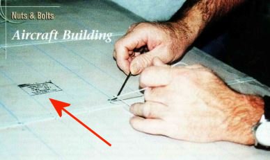

    Green might indicate Randolph dope upon Ceconite fabric (which is later than cotton...do the log books not show any work carried out after 1970 at all?)
    Ceconite (or any Dacron fabric) usually has a black PMA stamp every so often on the fabric, Cotton or Linen does not. See attached example.
    Regarding your N number: Don't use a heat gun until you try a hair dryer first (to soften the adhesive).

      There are no markings anywhere on the back of the fabric. The logbooks are being mailed to me so I haven't had a chance to look through them yet. I only have the logbook that my grandfather had in 1953. I don't know a ton about fabric airplanes so I will have someone smarter than me look at it and determine the condition of the fabric. I do know it has a tear under the front of the fuselage and a small puncture in the top above the cockpit that looks very minor.

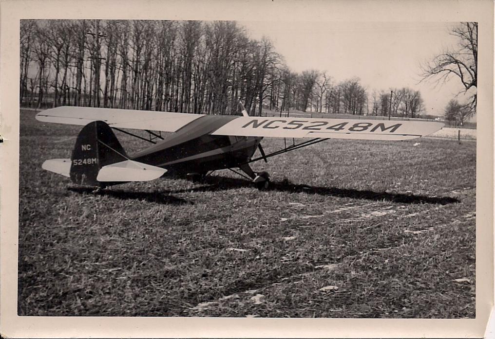

        A picture from 53-54 in Farmland Indiana.

                    Homebuilders use a Dacron fabric available from Aircraft Spruce that is not certified. It does not have any markings.
                    Ray
                      Re: N5248M finally found
                      You are right, Ray, but I'm sure that fabric is an "uncertified light" fabric that is intended for ultralights etc. I do know some Taylorcraft so covered, but in the USA for a certified aircraft, would be illegal.
                      There is a French Dacron fabric of equivalent strength to Ceconite 102 or Poly-Fiber "Medium-2" called Diatex which has no stamp. But I doubt you would find it in the USA.
