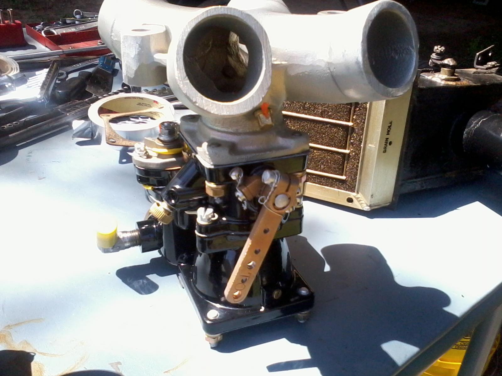

            SEE ALSO photos below. This is my carburetor - you can see my airbox in the background. You will need a bracket air filter or an equivalent air filter with housing to bolt onto the front of your airbox. Also in the plane photo you can see how the airbox fits in under the cowling nose-bowl.

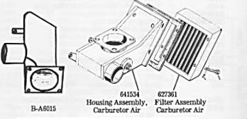

                    Roland,
                    Mike has a good point. I missed that code 8 business. But I was simply trying to point out that the J3 style (from a certified source) is the same box as the post war and most pre-war Taylorcrafts. OK... so I did a bit more research and found the photo below excerpted from the 1980 Taylorcraft Parts Catalog. If you will note the part numbers, the ones starting with number 6 are Continental part numbers (not Taylorcraft part number). Tha air box main housing is p/n 641534
                    I think you have the following options.
                    1) Locate and buy a used p/n 641534 or new PMA approved replacement for p.n 641534.
                    2) Keep what you have. A DER can approve data for its use on your Taylorcraft. I am qualified to do so. We will need to put together the pertinent data for me to approve. This would consist of perhaps the Ercoupe parts catalog showing all the attach hardware, how the filter installs, how the carb heat works, etc. You'll probably need to do a Carb heat rise test and send me the data too. And photos of your installation. Its a lot of work but can be done. If I do such an approval, you would have what you need to submit it on a 337. Your cost would be between $ 150 and $300. Thats why I haven't mentioned this route before now.
                    3) Buy a Wag-Aero air box as discussed but ask them for their drawing and manufacturing records. If they will provide this drawing, you can then compare this to a borrowed p/n 641534 air box and if you find the Wag-Aero part to match the 641534 part, sign it off as "owner produced part" (yes this is a legal way to do it).

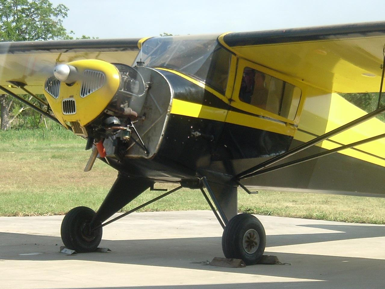

                              Going back and looking at your picture and the fact that's a 45, it's likely that it did not come with a filter originally.
