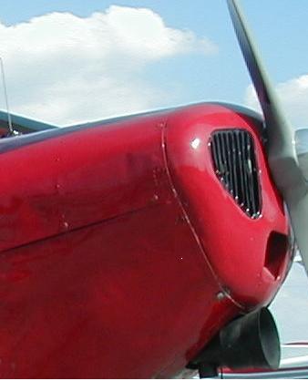

    I have an air intake that my mechanic will not sign off for the annual because he cant find anywhere it is documented that it is approved for my plane. Does any one know what this is and where I can find documentation stating that it is for my plane.
    Thanks
    Re: Air intake/Air filter 1945 bc-12d
    hmmm
    sorry but I think that he is correct
    I have never seen such a thing on a t-craft
      Does it have an air filter?
        I have seen this before, but where I cannot recall. To be sure, I'm convinced this is original.
          I have the same intake.
          N27432
            Yes, It has a filter that doesnt look like it filters anything but grasshoppers and butterflies. It is made with what looks like wire mesh.

                      am i wrong but is not the air box an engine part that comes with the engine not from tcraft and could it be some kind of non standard part that the engine manufacturer supplied with some engines

                        That looks to me as if someone in the plane's past tried to create a small ram air effect through the carb.

                          that is an Ercoupe airbox
                              Mike I was thinking that too but I do not see the nontapered flange that the filter would set in to.
                              Perhaps someone removed it or this is some home made device or just something I never saw before
