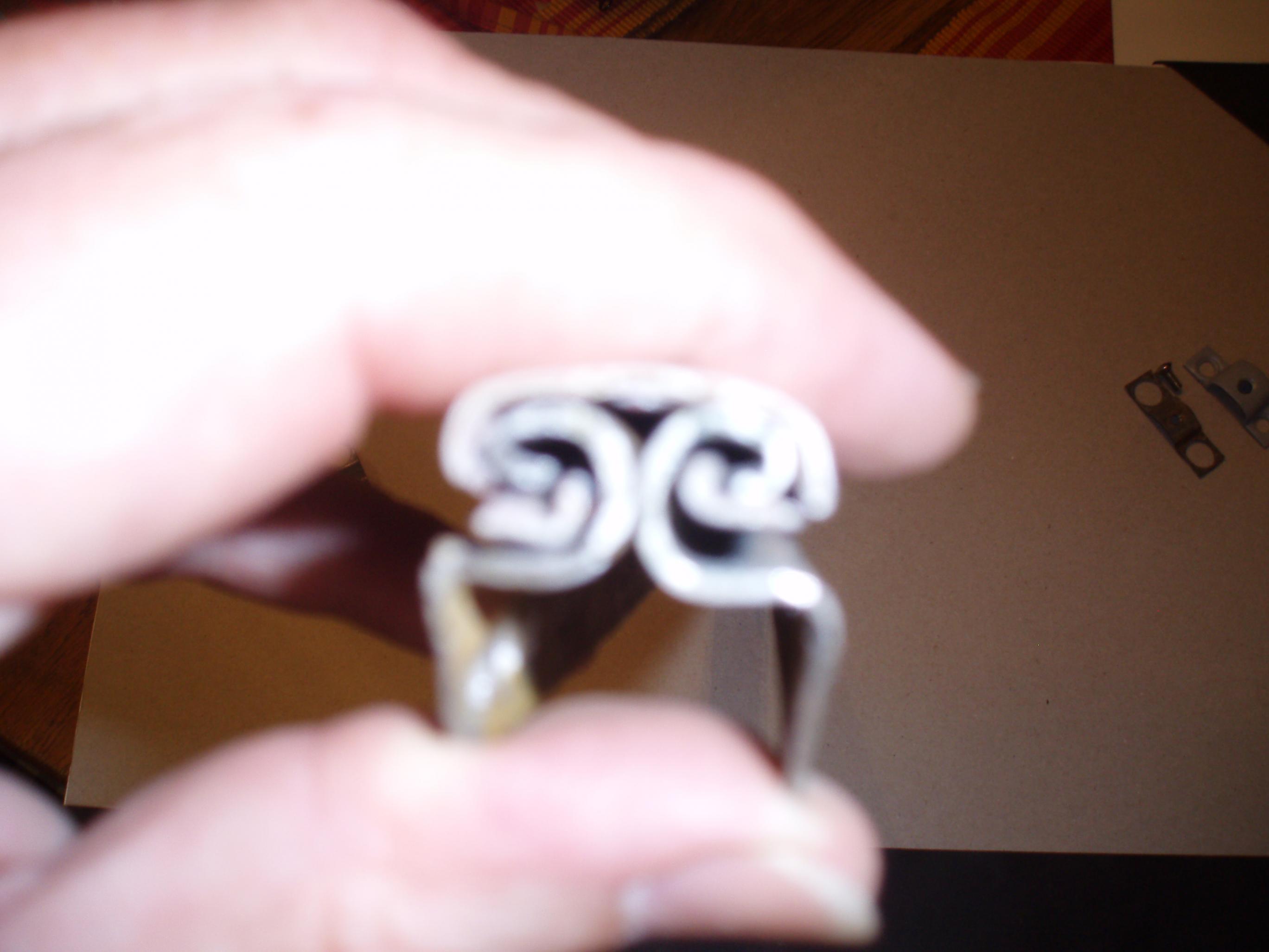

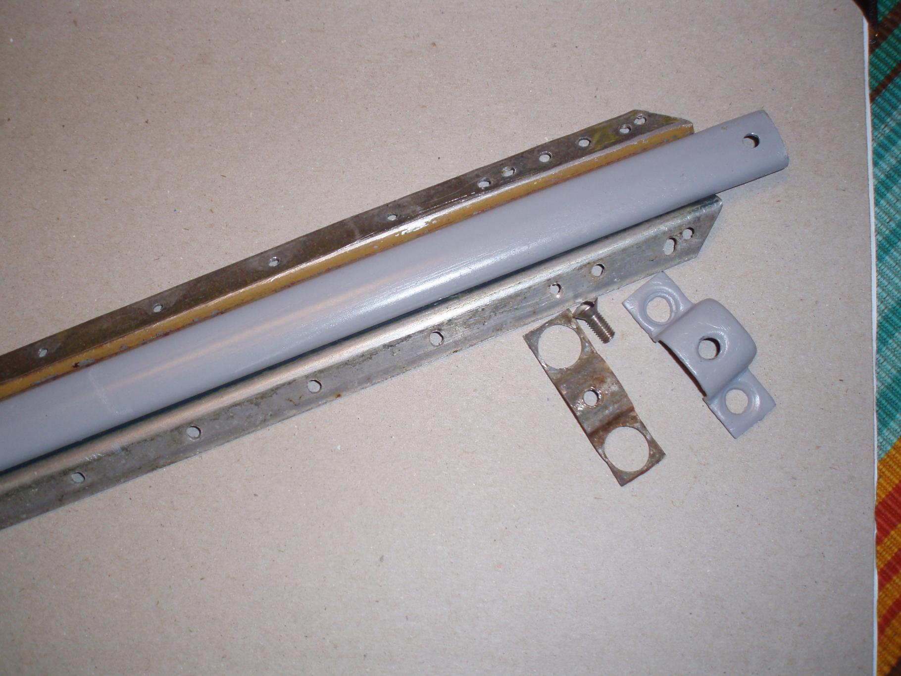

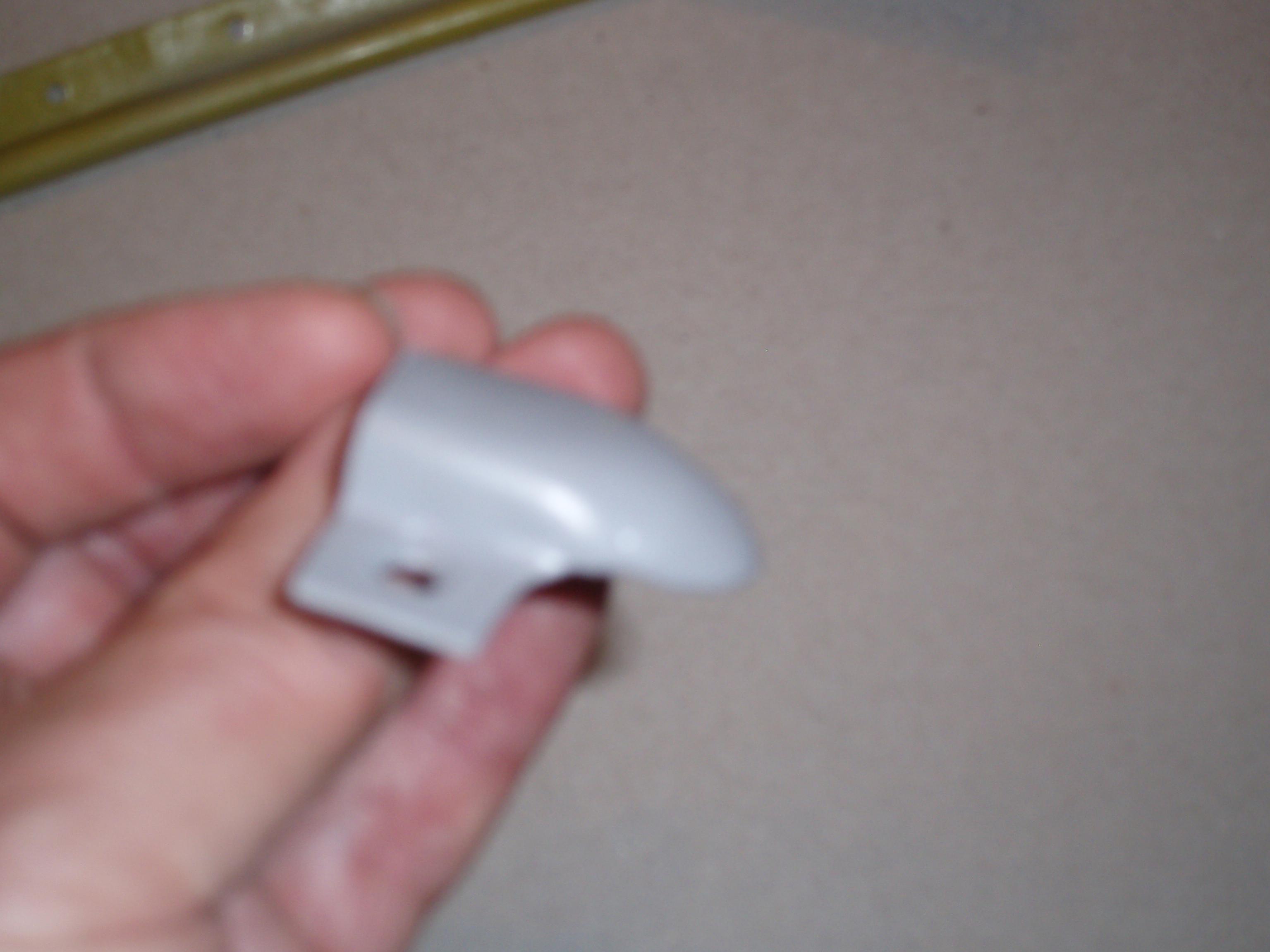

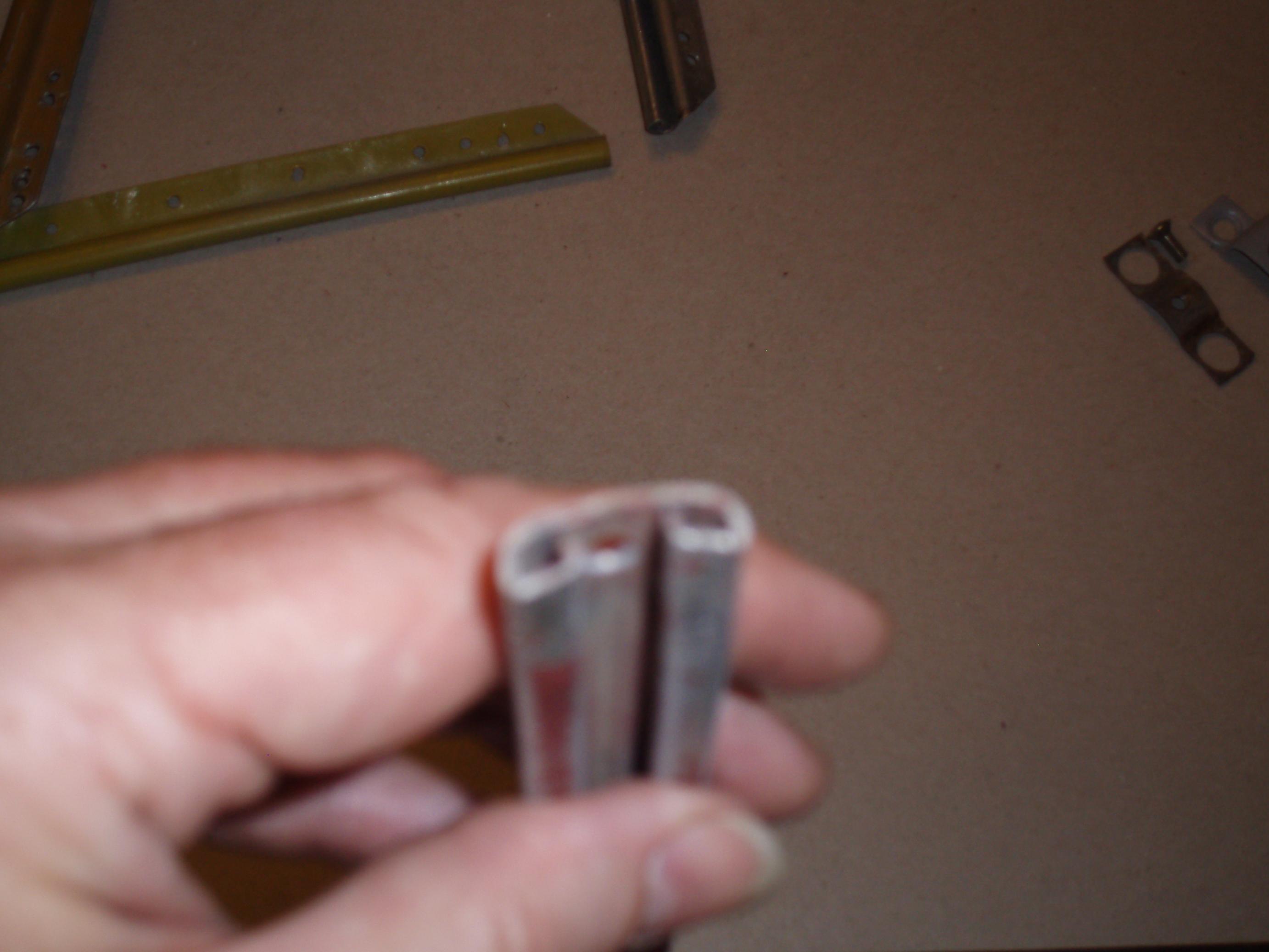

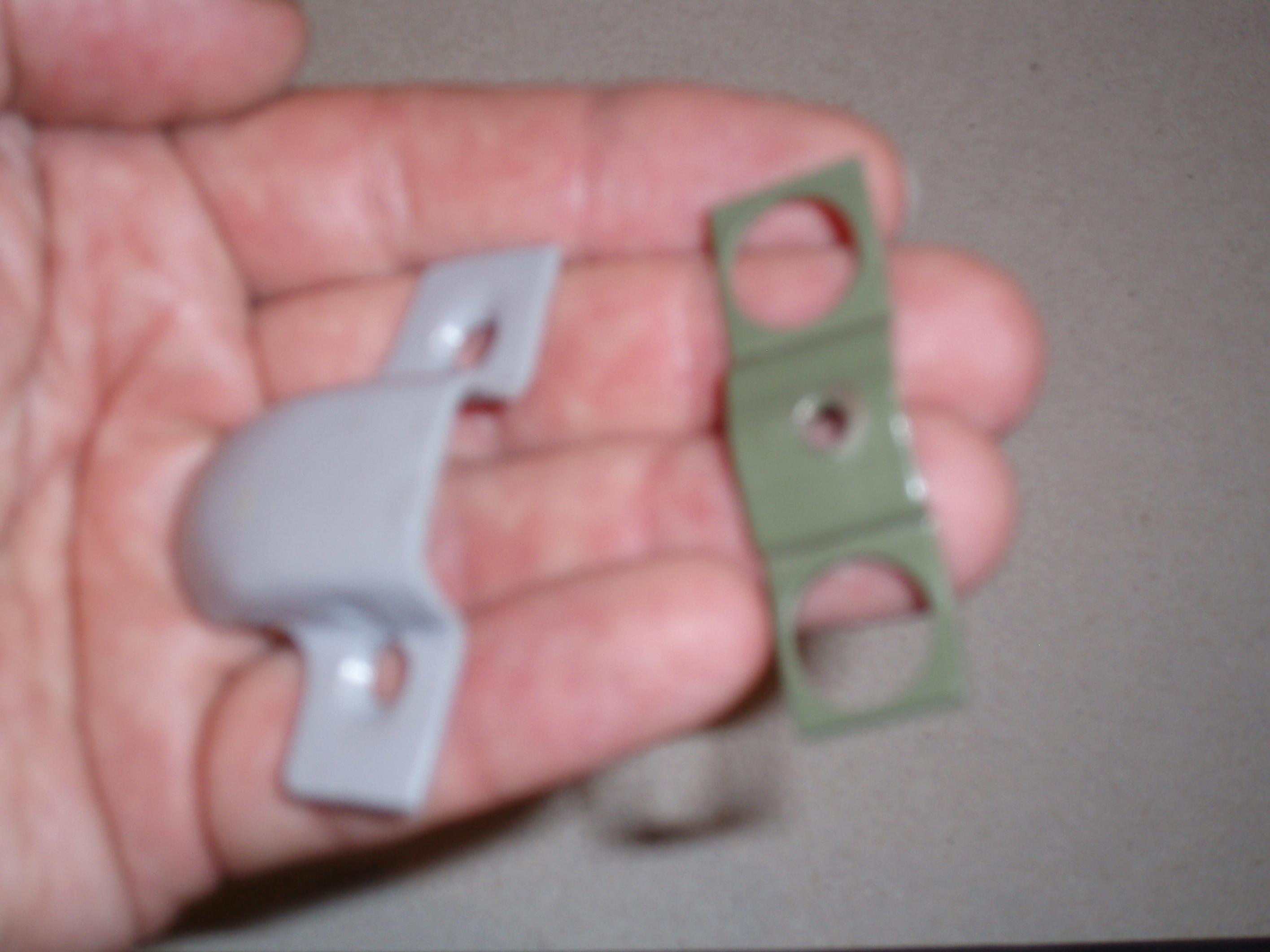

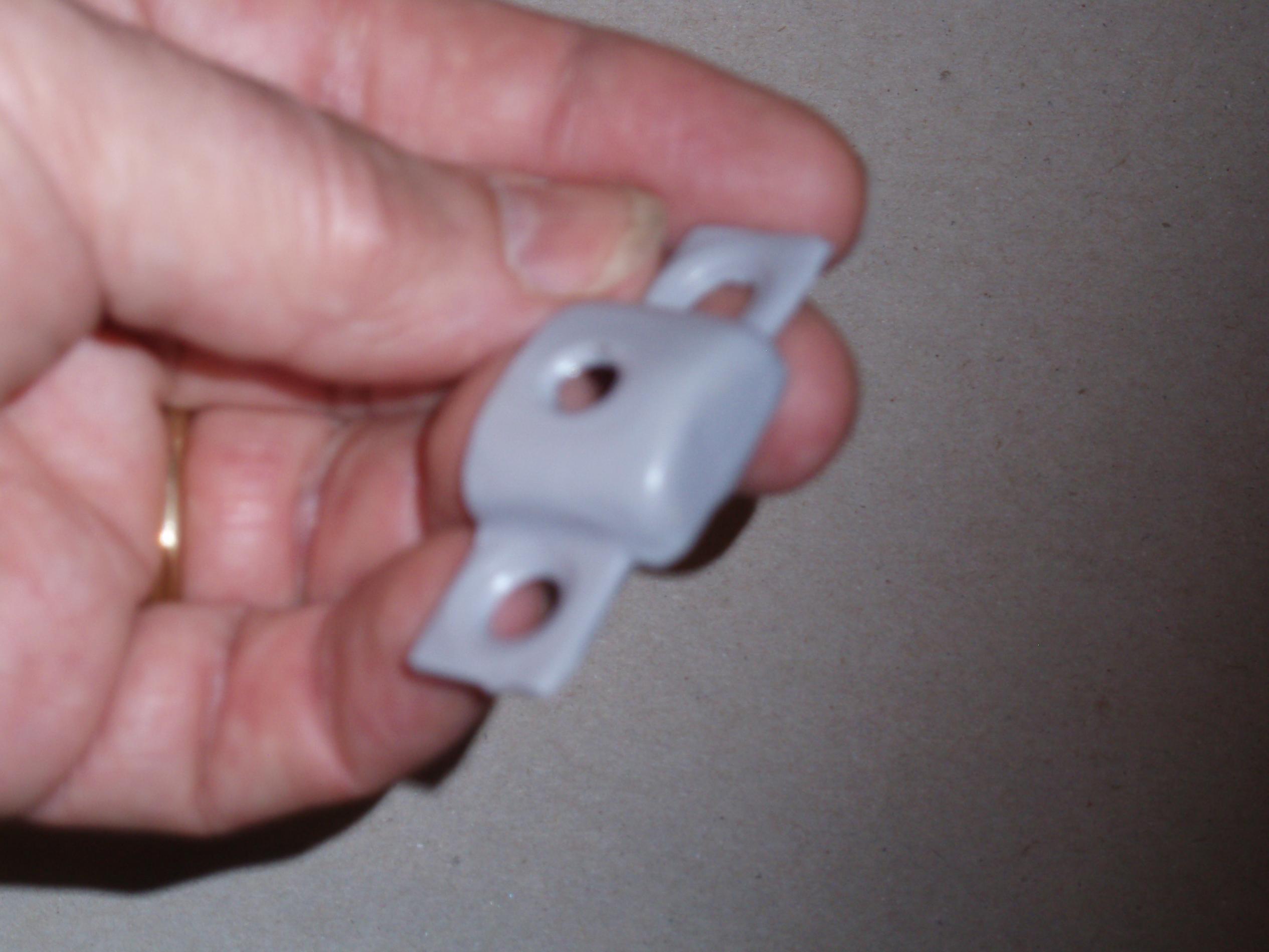

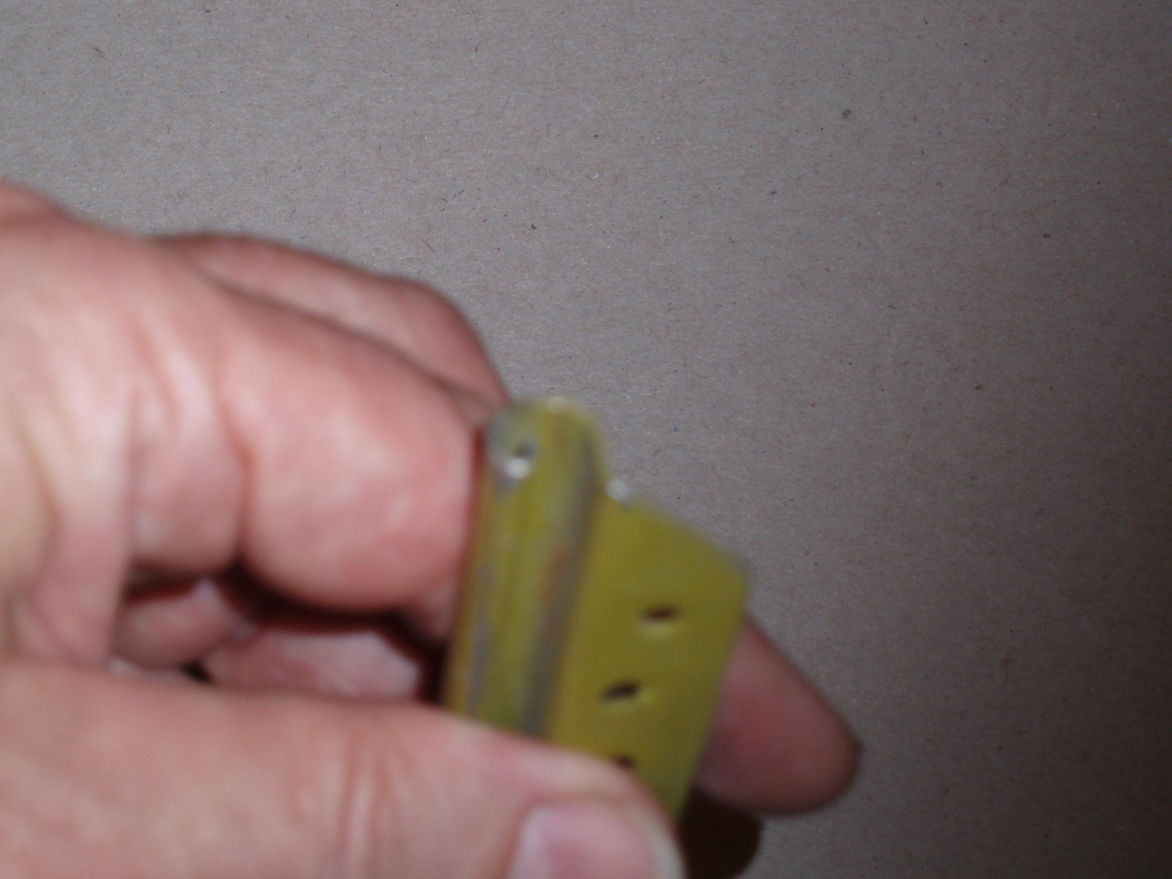

      First picture is of the front hinge fitting I made by hammering the metal and welding and filing. Tried to make it just like the ones in old photos. Second shows another view as well as the clip that does the actual holding of the front of the hinge. Third is an end view of the hinge I straightened assembled showing how the pieces slip together. If there is any bends it jams and won't move. Forth and fifth are the clip that covers the aft end of the hinge

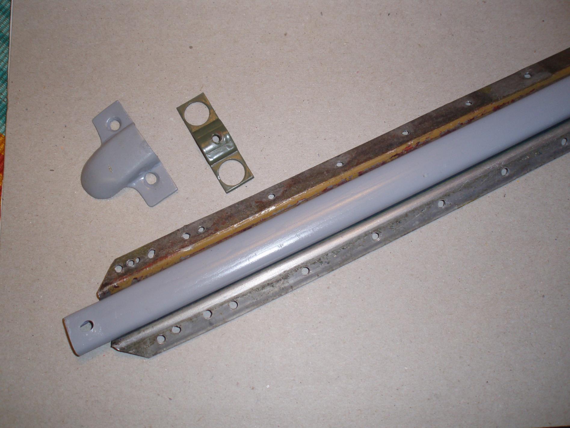

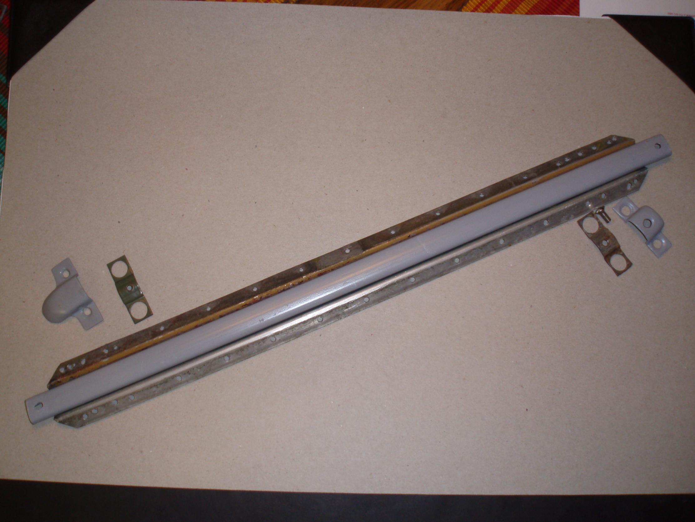

        OK, one day I will figure out how to comment on the photos IN the message instead of after I post them. The first three show the restored hinge for the 41 with all of the fittings. the forth is an end view of the center piece (note the crack) and the fifth and sixth are end views of the side pieces.
