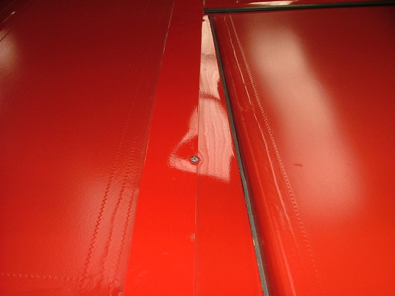

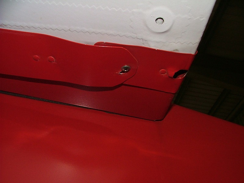

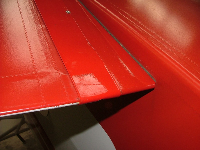

      If you're referring to the wedge-shaped filler that goes between the fuselage & wing, it is not nailed on (at least, it isn't on my BC12D). It gets supported by the wing root fairing to which Hank refers. That is to say, it wedges between the fuselage & wing root, and is restrained top and bottom by the fairing. Mine has a few self-tapper screws that secure the wedge to the wing band at the top surface.
      I attach some photos of mine. The black line is a strip of self-adhesive foam that prevents chafing between the wedge and the fuselage fabric.

        Mine is the same as Rob's. Just free-floating, but secured with screws through the wing band.

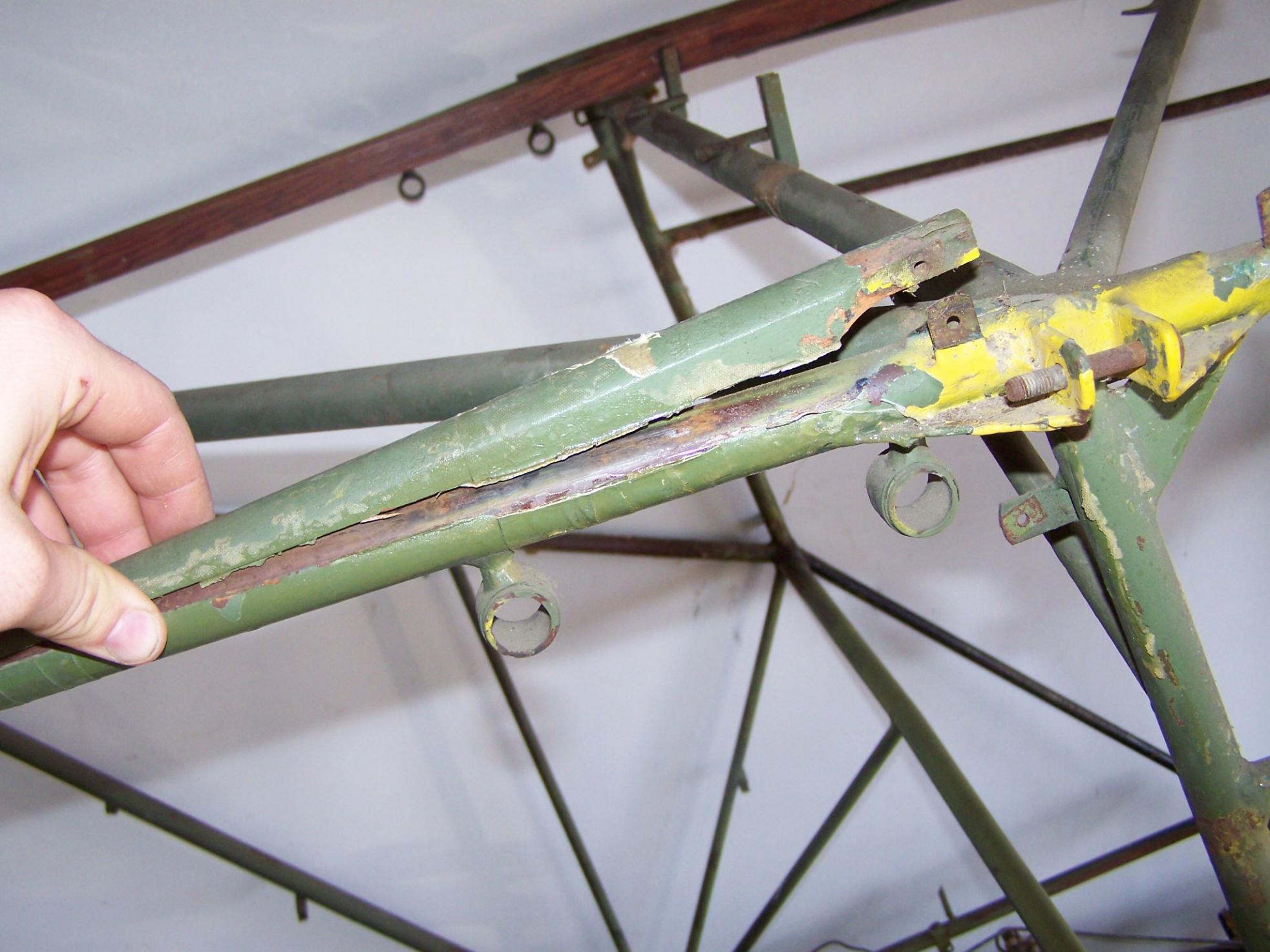

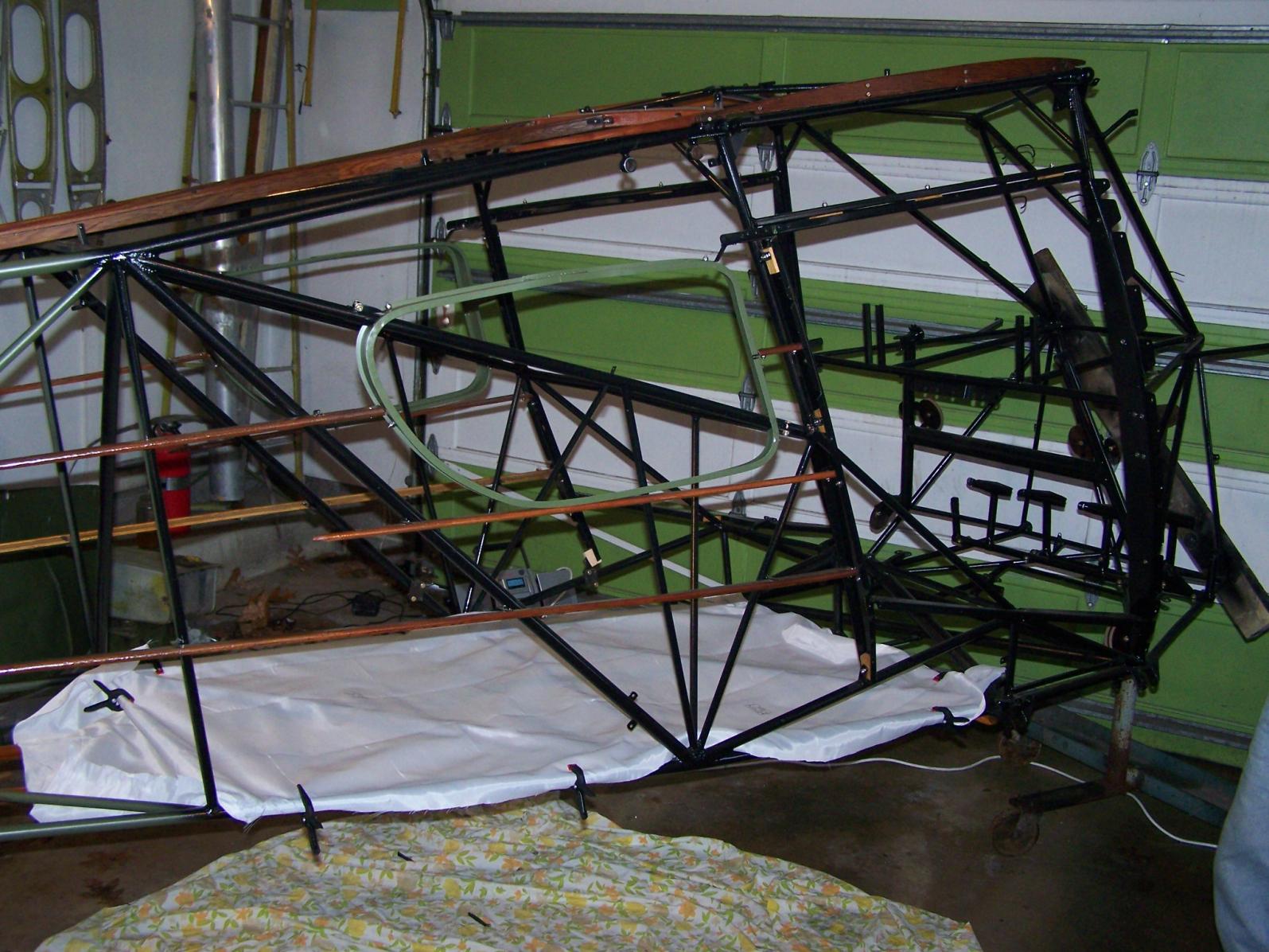

                  My system is exactly has Hank describes. Our filler piece is nailed into the wood piece on top of the longeron and does not come out when the wing is removed. Our wing band is still one piece and is a real PITA to fit. Still tightens down with the one long screw through the whole in the back. Bad picture but you can see the wing bands hanging over the ladder in one piece and the fillers are already attached to the airframe. The wood pieces on the fuselage to which Hank refers can be found in the other two photos.
