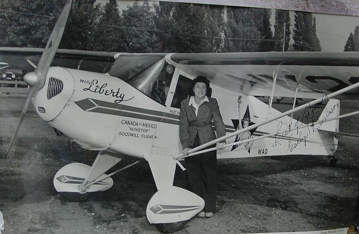

    I'm working on a drawing of the Tcart Evelyn Burleson flew from Canada to Mexico, and have a couple of questions I was hoping the group might be able to answer.
    1. What color is the trim on the airplane? (Assuming the base color is white)
    2. What's the tail Number?
    I only have this one photo to go off of, so if anyone has any other details, or knows of any distinguishing markings, it would be a huge help.
    Thanks!
    -Anthony

    Looks like a post war nose bowl (stamped grills, not cast), no "D" windows and a pre-war 4 piece windshield. Also has a pre-war "flipper" trim and pop out windows, not sliders. I can't tell from the photo if the doors are wood or tube, but they are NOT the sheet metal ones.
    No "Deluxe" strut fairings and the pitot tube has been moved down on the jury struts. It also has the cast wheel pant mounts and does NOT have the stainless strip trimmed pants (they have a flange and the Taylocraft "Bird" doubler is missing on the outside of the pants). Also notice it has the old style intake tube on the engine with no filter.
    It has the pre-war Pyrlene air inlet on the windscreen, round pre-war wheels and most important for your search is it has an NX number, not an NC. Should reduce the number of planes in the search.
    Old photos have a TREMENDOUS amount of info in them if you are used to studying them.

      Hank, you forgot to mention what looks like an old Model T in the background, near the spinner. It looks like the nose bowl is missing an opening. I don't know enough about the different versions to tell what year it is from, but it sure isn't like what is on my 1946 model.
        Re: Questions about "Miss Liberty"
        Go to this website for more info and photos. In one of them you can pretty much make out the 'n' number. Maybe 26631 which was a BL-65 before being deregistered. Definitely NX26631, you can see it on top of the wing in one of the photos.

          Photo 9 of 11
          The plane was painted especially for the flight in white with red and blue stripes, a torch bearing Liberty and emblazoned with "WAD" (Women Also Defend.)

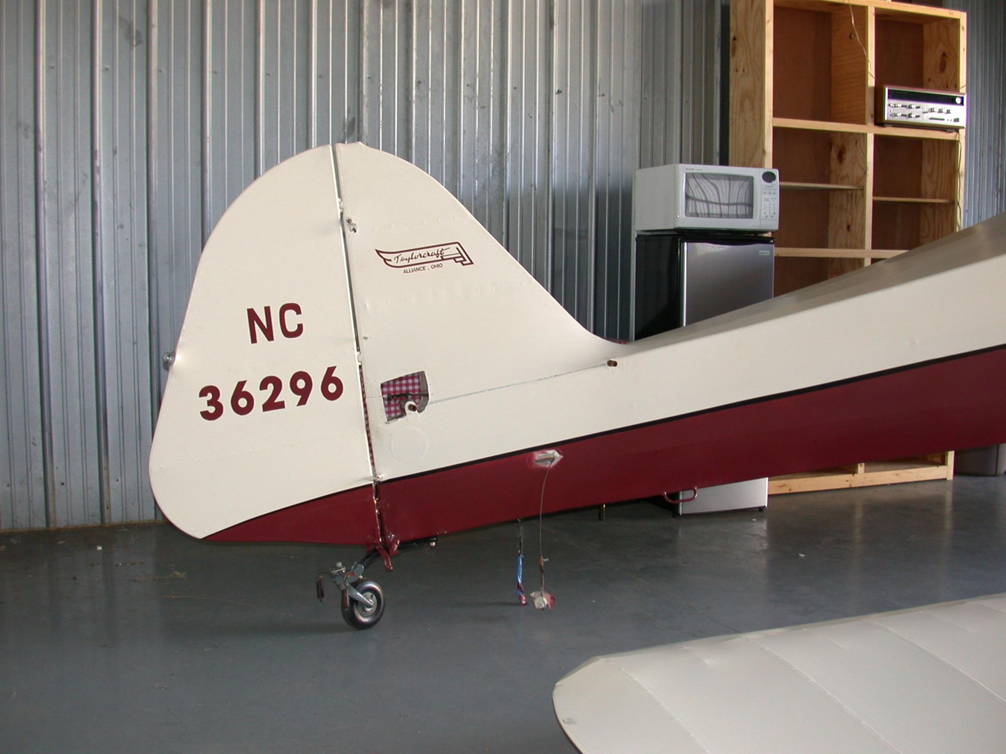

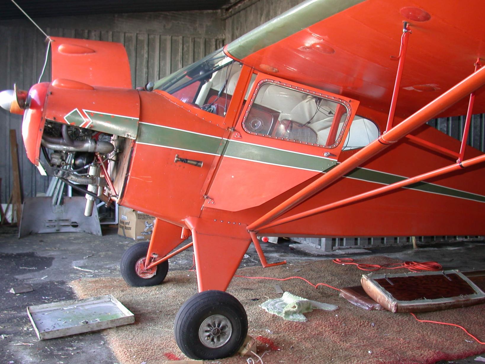

                      I found a couple of pictures that are pretty square on of the pre-war door and vertical tail. The fuselage in the door picture is NOT square to the camera, but the door is. Note that the small clip at the top to hold the door open is NOT supposed to be there.
                      The orange plane is what mine looked like when I started on her. NOT the prettiest plane in the world, but some mighty pretty bones and a GREAT flyer!
