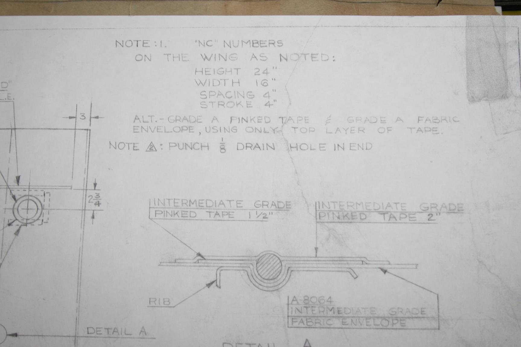

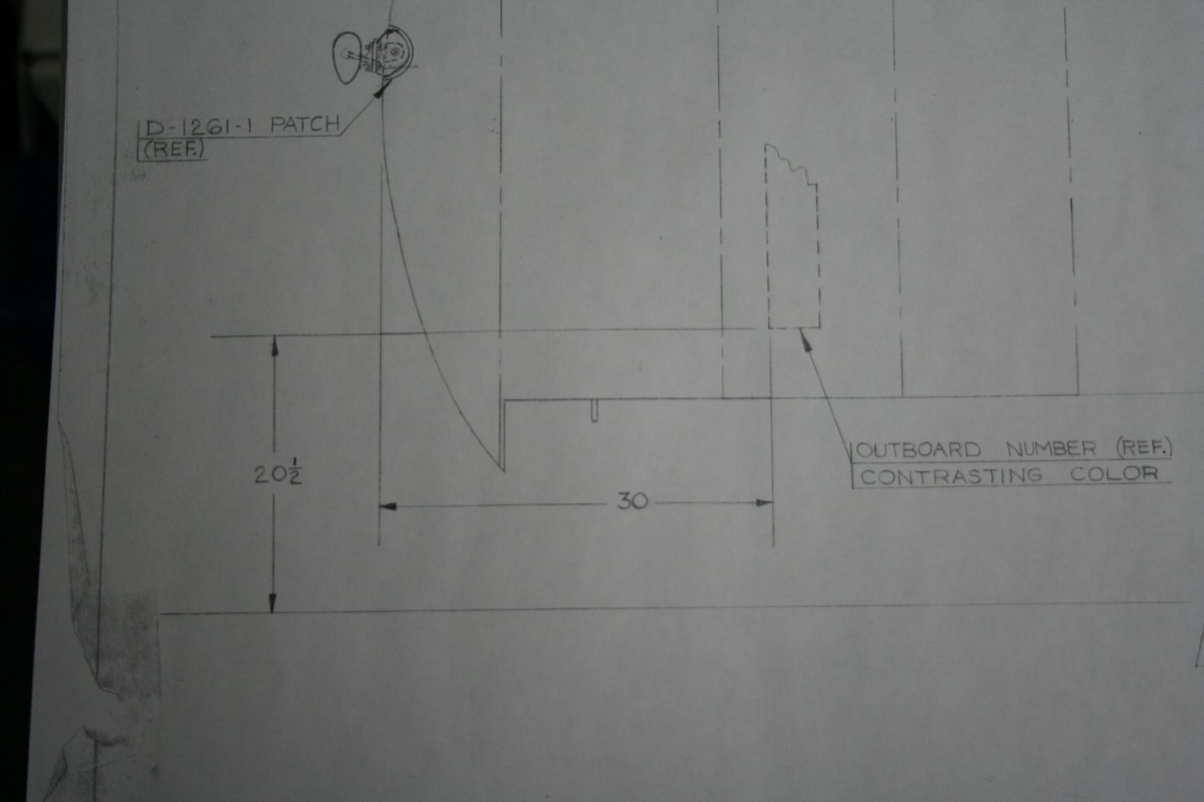

          Size and spacing of numbers on the wings. This is from a factory drawing, but would be for a fifteen rib wing. The "1" would keep the 4 "spacing and stroke, but obviously not the same width as the other numbers and letters. On a side note, it looks like in the first picture Anthony posted the C in NC was made into the X on the bottom wing. The bottom curve of the C looks to visable.
