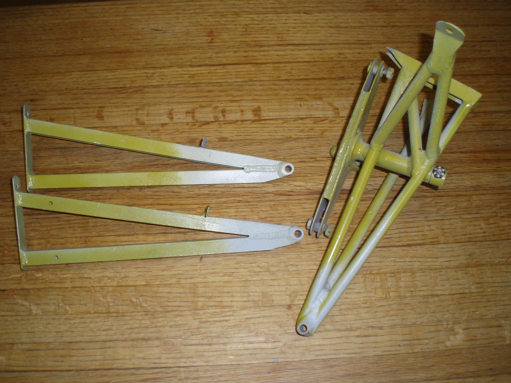

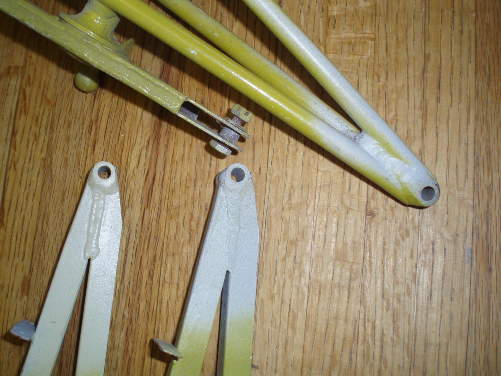

                            Sorry to take so long to post these but every time I turn around the #%&$(%&_)(@! camera cable is gone. I think the stupid thing has hidden legs.
                            This is what the "like new" fittings I have look like. No bushings, just a tube welded at the end. Anyone have photos of the configuration being discussed here?

                              Hank, I think you need to take a closer look. I can see the bushing lines in the picture, at least on the outboard brackets.
